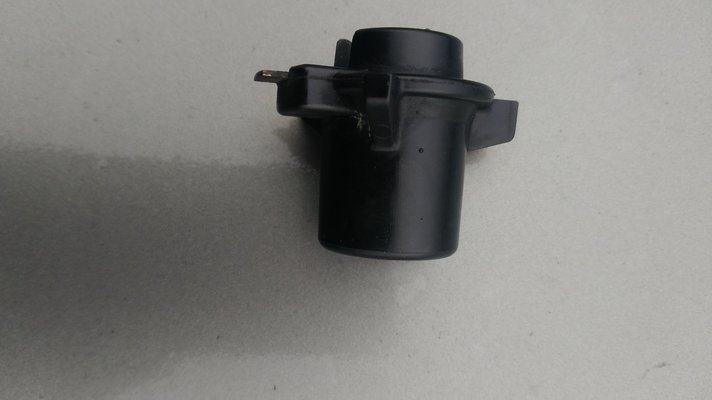

do you know about strob pistols? to adjust the timing? i need one looking for advise where to buy a good one
my rotr looks like this is this similar to yours?
It looks like it is same.
I have old strob light and it works fine. can not read rpms or anything else but just flash light. Good enough for setting timing correct.
