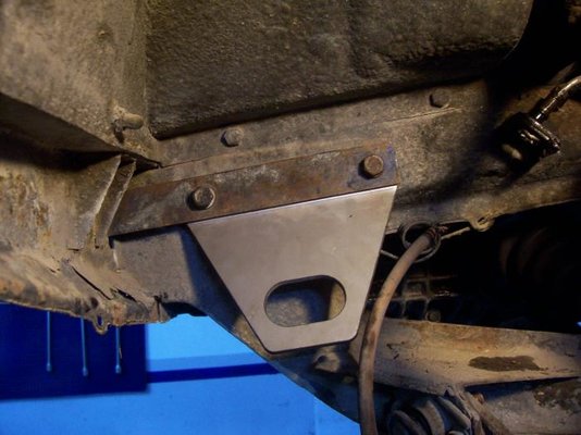

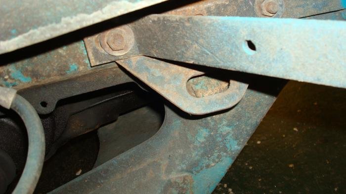

emergency Front towing-hook/point...
I've got two already!!!!!!!!!!!!!!!!!!!!!!
I was about to order , and found on the offside front and offside rear!!

Front 1st pic, Rear below.
Thanks Angel - a star as ever! How's your supplier on chassis....!

I don't think something like this happens to other car owners...I mean that the car has towing hooks but you don't know it because you never had to use them!

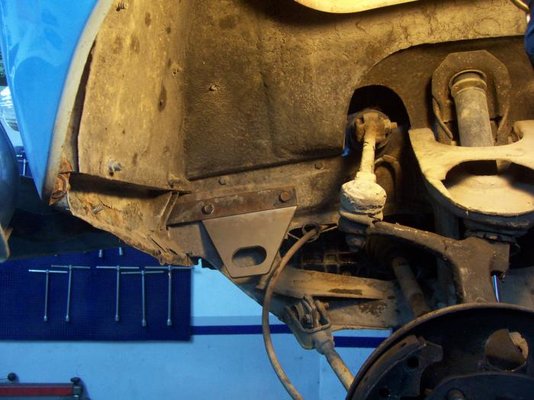

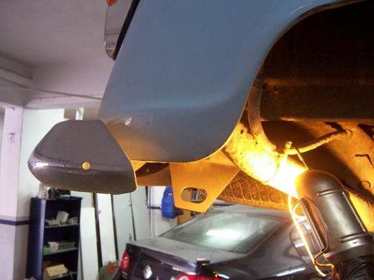

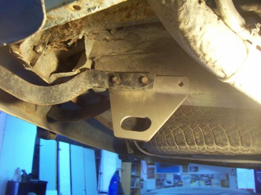

I got the first ones just some hours ago (photos tomorrow), so they are ready to be sent...Judging from Firstandbest's photo, "my" version is some 15mm larger (that is, the towing eye is lower). I thought it would be better, as the towing wire/rope would foul the crossmember outer part if I made them shorter.
The "pre-production" item, fitted on a 1972 4 Export

The first batch of towing hooks is ready, anyone interested please send me a PM.
they look the business Angel! -If you prefer to be rid of mine just send as letter and let me know what I owe you ok?

Angel,
I would like to buy a pair now (and pay now) please. Pepper has kindly offered to pick up my pair when he sees you at Thenay. This will save postage and I don't need them urgently. Could you PM me with payment details?
Many thanks, Jonathan
