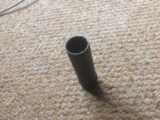

Hi Derek, have a look at my thread "Tool for cylinder head bolt removal" from a few weeks ago.
Most importantly, you have to clamp down the liners as soon as the head is off. The head also should be knocked off sideways.
You'll probably have to get a cylinder head gasket before you start, and a torque wrench for when you reassemble.
