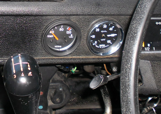

As a failed thermostat can cause all kinds of problems I removed mine and fitted a Temp gauge to keep an eye on how it was running, along with an oil gauge. It runs at 80C when up to operating temp and never rises above that and gets about 50lbs oil pressure in 4th gear and 60lbs under high revs so I am happy with that.

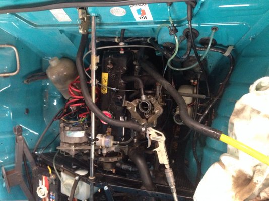

The latest, tried all avenues, i now have warmth but not heat, so I'm putting it down to corroded blocked matrix, so a soak down the pipes with de-scaler ?
Make up a LARGE amount of "Kilrok" solution; you can buy this in Robert Dyas (other hardware stores are available....) Connect extension hoses to both pipes that run to & from the heater matrix and, keeping them both above the level of the matrix, pour the Kilrok solution into the matrix, allowing it to remain in the matrix. It works much better if it's hot when it's poured into the matrix and will froth up as it dissolves the "crud" from the matrix. The longer it's left, the better it works. Thoroughly rinse out afterwards & see if it's any better.... Repeat if necessary.
If de-ionised (distilled) water is used this build up of calcium is reduced and almost eradicated.
Great minds think alike that's what I posted above
I have also used air blow nozzle very carefully due to it not being nice on skin eyes paintwork etc and let a SMALL amount of pressure to bubble it's way through system this will agitate any debris in matrix
repeat in both directions
