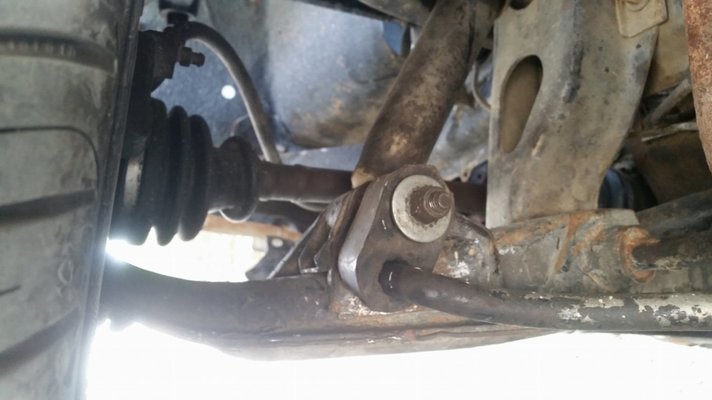

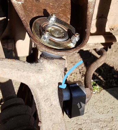

It is odd that the roll bar keeps popping out/splitting the bush.
I've had a genuine part fitted which is a lot softer, but even stationary I can see the pressure that's put on it. I'll have to remove the bar and see if it's straight/correct way around.

Hi Oli
Just a thought - is the plastic spacer between the rubber bush and the lower wishbone in place?
If it's missing, the rubber bush can move forwards and the end of the anti-roll bar can pop out.20200206_134924 (3)_LI.jpg

I spotted the part you mentioned on a thread somewhere. Problem is, over here everyone seems to install it without the collar. I've asked many mechanics and a classic renault parts store here in cololmbia, they tell me it's fine and can't supply me one!... I'm sure it would help of course.
Just seems odd how it's done this multiply times on the same side, and I'm not cornering that hard either. I will try and find source said collars though.

Awesome, the part number should help me out. I'll find a renault dealer and see if they stock them.
I've been speaking to a friend who runs the medellin owners club, but he said it's the same on his? He's put me in contact with another chap from the r4 club in Cali. Fingers crossed!

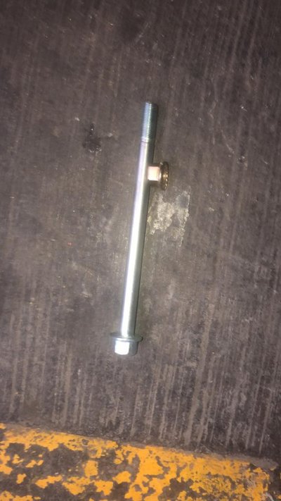

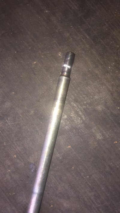

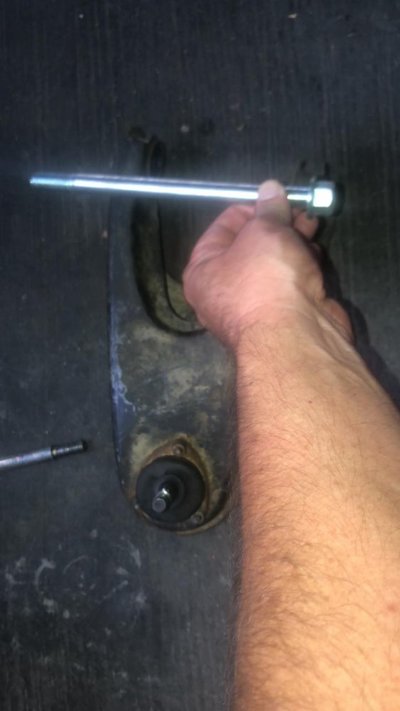

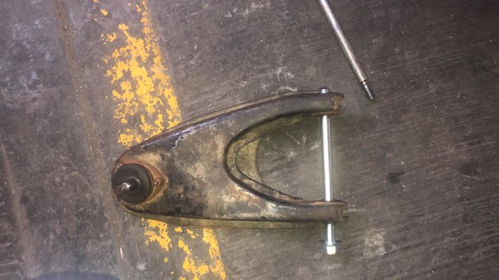

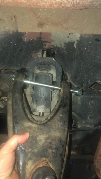

Narrowed the knocking problems at the front to a damaged bolt that had striped and was too short originally. Also fitting to front shocks as they had had it.
Fingers crossed this will help alot
