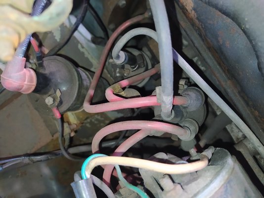

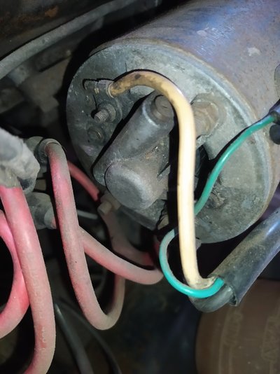

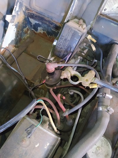

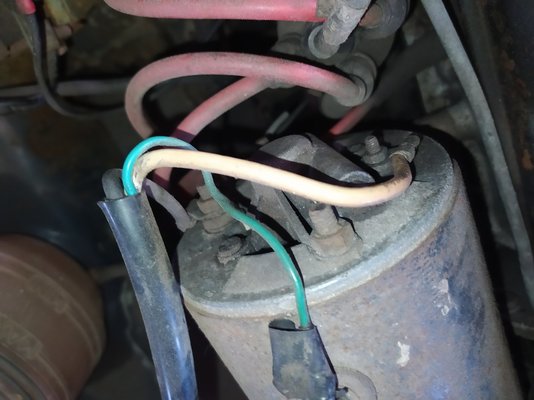

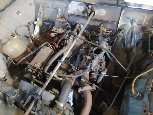

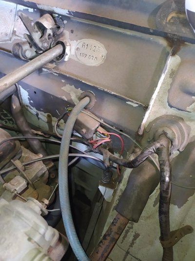

Here are some photos on how it looks right now. I can't find the dynamo but doesn't matter anyway

Some one may wish to correct me but if you have a basic meter and the battery connected the thick pale wire on the back of the dynamo should be going straight to the RB340 then the wire marked B goes to the battery +
If you remove the small green wire from the dynamo and (with the ing switched on ) flash it to earth the red ing light on the dash should light up
Depending on which alternator you use if it has two terminals one large and one small plus a earth terminal connect the two large thermals on the 340 together and take to the alternator and the 2 small green ones together
and connect to the small terminal on the alternator
If you want to use the dynamo shown in the pictures it can be made to run in either direction by polarising it ( refer to flemings right hand rule to understand it better ) I repeat correct me if you feel I have got it wrong

You do have a dynamo not an alternator. The dynamo is DC and needs the voltage regulator box mounted on the firewall. An alternator charges in AC and has an internal rectifier that does away with the need for the regulator box. So you are looking good.

This is a dynamo, too. It can work with the RB340 regulator but will need an internal wiring change - not the easiest task if you are not familiar with electrics. Better to find the matching regulator for it.
You have to reverse field coil connections in the dynamo, too.
