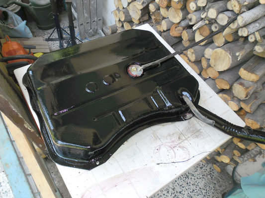

Fuel tank had to come out as the top fuel pipe was split and leaking :( easy enough job but I hate working on my back
While it was out I thought I might as well clean and paint it up !

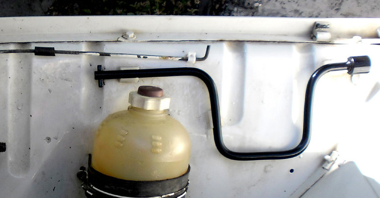

A nice bit of tidying up done as the new clips arrived today to hold the jack handle and the bonnet support from
R-Quatrel.nl ( www.r-quatre.nl )...The old one's had snapped with getting too hot they had become brittle.
Great people and very helpful at that web site for R4's, it is in Dutch but with a bit of trial and error you can find the parts you need and phone the order in with the part number ( they speak English )

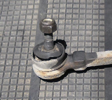

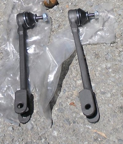

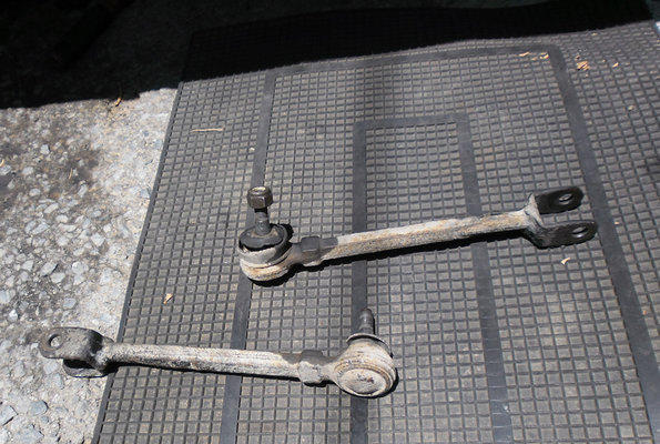

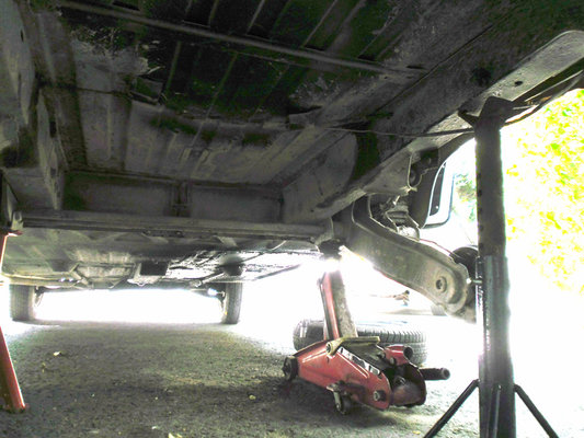

Well that's a good 40 min's work done ! Both top steering arm's replaced in 40 mins outside in 34C heat !....The old magic is still there;) . I'v got to say some of the spanners were a bit hot when I forgot to put them under the car :eek: in the shade. Still can't believe it passed its MOT with these on !

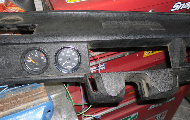

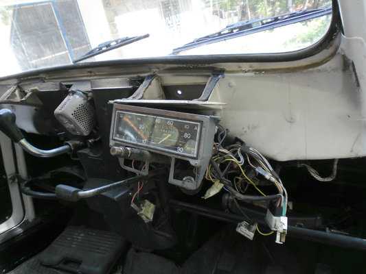

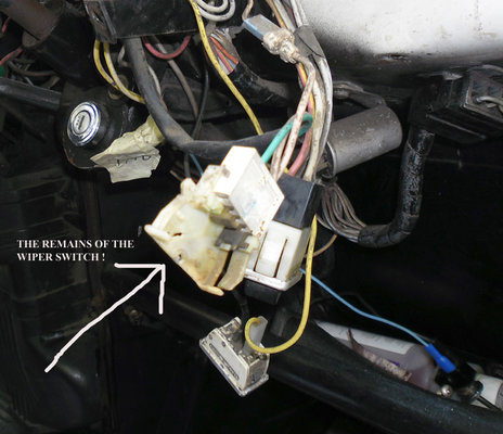

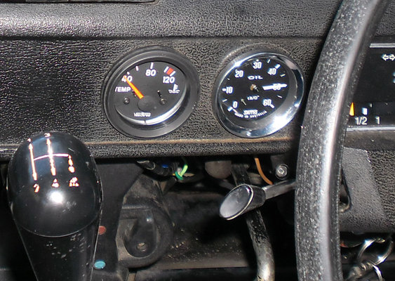

Dashboard out this morning and the "new ish" speedo head and cable installed....but as usuall one job leads to another and the wiper switch has fallen into 100's of pieces so in search of one if anybody can help out.
Fitted the Oil gauge and Temp gauge while the dash was out so not too bad..3 steps forward and only 1 step back haha;)

I must say that those gauges do look nice there on dash board!
I would like to put two gauges as well (RPM and water temp) but would like to disguise them somehow so that they do not look "to modern" in cockpit.
Unfortunately do not have switches for early model so can not help you with that.

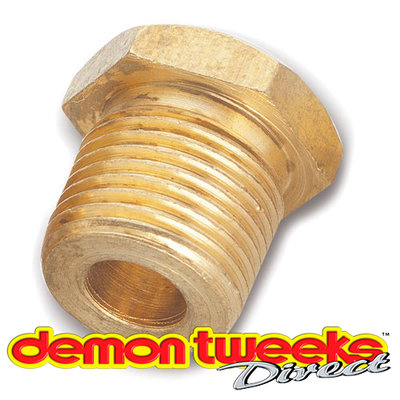

It is quite easy to convert to a Temp Gauge, you need an adapter for where the sender originally is as it is a large thread size. Get an adapter/ reducer M18x 1.5 ( the size thread in the block) to an 1/8 NPT ( IN THE PIC BELOW) which is the most common size sender unit thread size ( M18 is the outside tread for the block and 1/8 NPT is the inside thread to take a normal temp sender for a gauge )
Then run a wire from it to the back of the temp gauge....the other side of the gauge will need a positive feed but make sure you take the power from the back of the speedo from the voltage stabilizer. or you can fit a separate one ....
You don't need to fit a gauge in the dash as I did ....you can put a small "pod" under the dashboard if you prefer but I wanted to be able to see the temp ALL THE TIME without having to look for it elsewhere ;) as for a rev counter I have noooooooo ideao_O

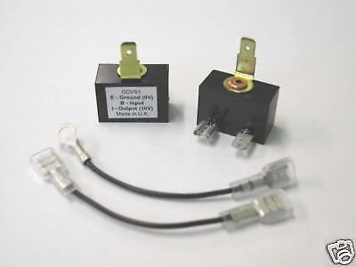

If you wire up to a fuse box or a live from the ignition your reading will vary and not be the true temperature as the voltage rises and falls depending on if your driving or standing still .......
This is an easy cheap thing to fix with a Semiconductor Voltage Stabilizer like the photo.....
This has one wire to an earth, one wire to a live (fused from the ignition ) and one wire to the clock or gauge.
It gives a stable 10v supply for accurate gauge readings and can be bought for about 10 euros and should be inbetween any gauge you fit in your car as an accessorie .
There will be a stabilizer on the rear of your instrument cluster on your car but if you do not want to remove it or if it is awkward to get to just fit one seperatly .[/quote]

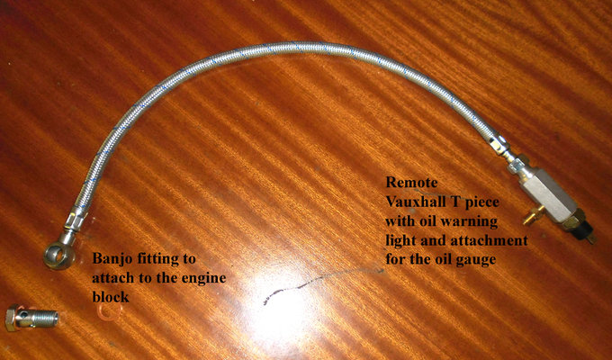

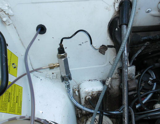

Just had this made up at the local hydraulic pipe shop in Limassol yesterday........It allows a "T" piece to be fitted remotely for an oil gauge and retains the oil warning light switch from the engine.
I found Vauxhall had the same size thread ( M14x1.5) to the block for the T piece but there was not enough room between the chassis to allow fitting it.
The banjo fitting to the block allows the T piece to be fitted to the bulkhead and from there you can attach the oil pressure pipe to the gauge and attach the wire for the warning light.
Pirtek in the UK can offer the same services for making pipes up as I once fitted a Transit 2.5 DI engine in a Jag and needed pipes for the power steering to match up from Jag rack to Transit Pump.....simples ;)

Another job off the list.........:)........managed to fit the remote pipe to the block for the oil gauge and changed the oil and filter.......What a terrible job getting to the oil filter and the oil pressure switch ! It took almost 3 hours as I just could not get my hands into the spaces to remove the oil filter and there is even less room trying to get the oil pressure switch out:mad:.........Worth it though when I saw the oil pressure at 50PSI on tickover oil gauge (1).JPG with some nice thick 20/50 in there :)oil gauge.JPG
