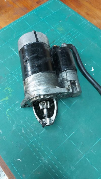

Finally had some time to remove the starter. I had to put aside the steering bar and the airfilter housing & upper engine mount. It was fairly easy to remove the starter. I hope the reverse is also easy :D

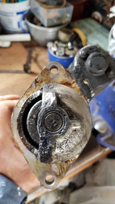

Looks like the relais on the starter above is non-serviceble. Looks like an inner spring has set loose? Also the inner plastic lever in the starter has worn badly, so I think it is a wise decision to order a fancy pancy new starter.
Maybe you can help with one question? I see new starters can be ordered with two turning directions. Spinning clockwise and anti-clock wise. I have an 845cc Billancourt engine. Which starter do I need? :)

The French R4 websites - like Oscaro - give the rotation for Billancourt starters as anti-clockwise:
Probably best to go on part number. Good luck!
I just replaced a starter on a 747cc. All the Renault 4 747cc and 845cc engines turn the same way (clockwise when looking from the front of the car). In the rear engined Renaults the engine turned in the opposite direction. I got confused by the description of the starters as they never say which end they are looking from. So long as the starter is listed for a Renault 4 845cc engine it should be good.
eBay is useful as it allows you to enter your car details and lists the parts that fit. Often the parts have cross reference numbers to other parts that you can look up and see what they fit. My new starter motor was about £55. Here it is: https://www.ebay.co.uk/itm/333110181021 with the big list of comparable part numbers from other manufacturers.
