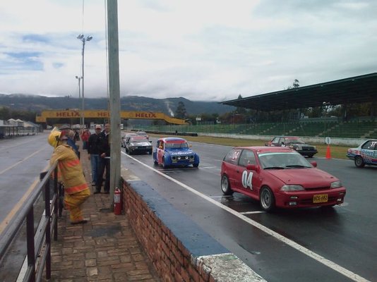

Hey guys, long time no see. Here's another Racing R4 spotted last weekend on the track. It was raced by a good friend and came in second in it's category, after a fierce battle, behind the Scirocco starting behind it in the picture.

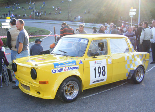

There was racing near us over the weekend. This is the only car that stood still enough for a photo. Somebody said it was a Gordini. What is it?
on first glance would of said r8 gordini but is actually simca 1000 rear engined from abt 1960 67 ish try google
Yes, a Simca 1000, but it could in fact be a Gordini version. Gordini, "The Sourcerer" worked on Simcas before he started working exclusively on Renaults.
No this Rally 2 was long after Gordini stopped souping-up Simca engines. This didn't mean it wasn't competitive or fun to drive (even with the front suspension having a transverse leaf spring as the lower wishbone...)
