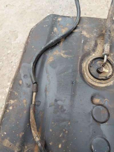

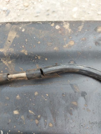

angel Enthusiast Messages 2,604 Location Athens, Greece Jul 16, 2021 #41 There is a short length of rubber tube between the petrol tank and the chassis metal pipe that may be perished. Result is that fuel pump draws air intead of petrol.

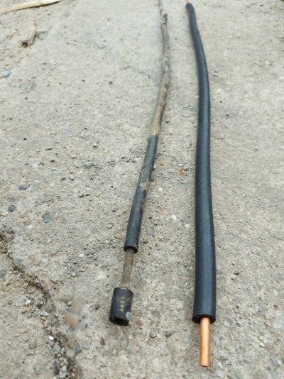

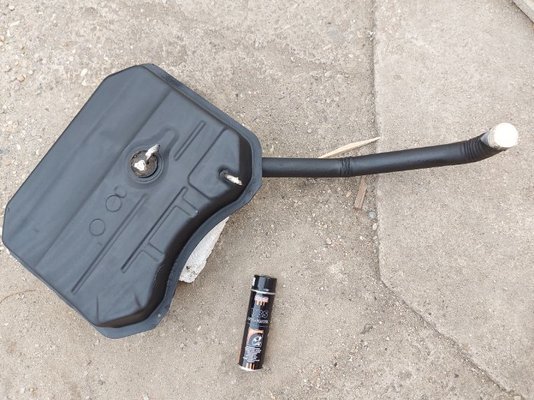

Markom981 Enthusiast Messages 44 Location Pozarevac Jul 17, 2021 #42 Today I was busy takeing of the gas tank and fuel hoses. This was the reason why the R4 didn't work.
Markom981 Enthusiast Messages 44 Location Pozarevac Jul 17, 2021 #43 New hoses and R4 starts and works perfect, and I paint the gas tank when it was out of the car.

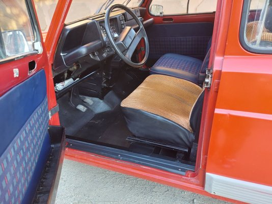

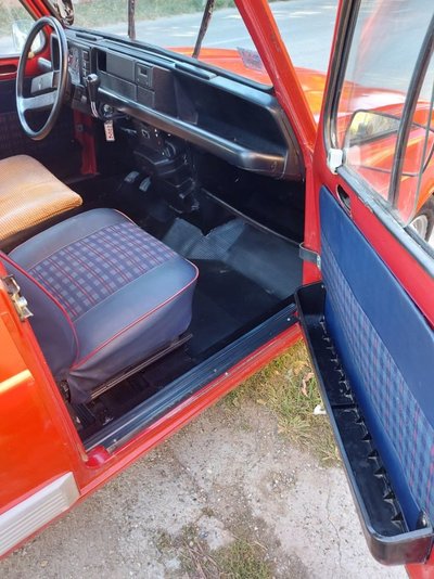

Markom981 Enthusiast Messages 44 Location Pozarevac Sep 20, 2021 #46 I only need to find a drivers seat in good condition.
