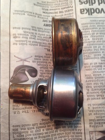

Solved! I decided to remove the thermostat this morning and this is what I found, a thermostat with half of it missing! I've decided not to replace the thermostat with a new one until later in the year. I took the car on my usual test run when previous trips would show the temperature gauge reach 100-110c but this time the needle hovered around 80c and with the manual fan switch turned off. What a relief!! I wonder how common that fault is?
Question. Where is the missing half? I'd guess somewhere in the system still (but not impeding coolant flow significantly), as nobody but a total cretin would fit half a thermostat on its own. Probably won't cause any long-term problems but it might be worth a look just in case it decides to disintegrate further — if it did, bang goes the water pump, probably.
Good point. I did think about the missing part once I'd got the hose back on but............yes I will look.
(Later) I undid the hose and had a look inside with a magnetised screwdriver. No sign of the missing bit nor hope of finding it without dismantling the water pump.
Thermostats don't seem to be made of ferromagnetic material. I have a spare thermo with a brass top (just like your fragment) — I put it next to the powerful loudspeaker magnet I keep on my workbench — not a flicker of attraction (sounds like the effect that I have on women). So your screwdriver won't necessarily give any indication of what, if anything, is stuck in there.
Hello Paul, if you are going to remove your waterpump to investigate be very careful as the bolts that hold it on are only 6mm ones, and can shear off quite easily. If that bit of the thermostat has fallen into the pump it's probably sitting by the temperature sensor, nowhere near the impeller, so it's probably quite safe where it is. Regards Brian.
Brian, My guess is that the missing piece has been sitting there minding it's own business for quiet a while so I've decided to leave well alone. A tad chancy I know but as the car has been coping manfully for ages sending coolant through the tiny hole in the remains of the thermostat and failing to expire, I think this may be a 'lucky' car.
Hello Paul, I'm trying to imagine how that part of the thermostat could dislodge itself from the main body as usually the two parts are fastened by crimping, for want of a better word. So how they came apart is beyond me, if indeed they did, on their own.....Yes, I think you are right, leave well alone.
