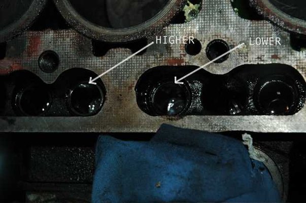

As the job of a cam follower is to follow the cam motion, don't you think that it is normal for a follower to sit higher (because the cam lifted it)? Common sense!
"...On removal of the cylinder head I was surprised to see coolant filling the various spaces between the bores,...". Where else did you expect to see coolant??!!!
If you didn't drain the block from its plug, it is normal that water has found its way in the tappet chest and inside the cylinders as you lifted the head.

Coolant in tappet chest
Thanks Angel, yes I'm sure it was obvious to you but this is the first head I've taken off. Could you say whether you think I have done any damage, or whether I have to now strip the whole engine? My plan was to clean the head and reassemble.

If I lifted the cam followers to dry out the bottom of them would I do any damage or causemyself more work?
thank you for your advice
Any water in the oilways will drain into the sump, but give it a squirt of Wd40 or similar. When you finish the engine run it for a while on some cheap oil then drain and refill with whatever you use then anything nasty in the engine will be flushed out.

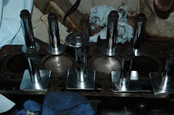

I'd have 2 main worries. Firstly the clean up operation on the bores (tidy all the rust off with 250 grit sand paper would be my thought) would leave grit in all the wrong places.
Secondly with the head off a wet liner engine there's danger of disturbing the seals at the bottom of the cylinder liners which could lead to water in the oil when the whole thing is back together. The manual recommends sticking the head studs back in with big washers to hold the liners in place while you clean them, but I've had problems in the past.

B and Q sometimes has what you want
I tend to work on the premise that Band Q demand such a low selling price that manufacturers nearly always are forced to compromise on quality and so it is rarely worth buying anything there. But today is an exception, as you can see from the photograph they sell a selection of large washers and curtain rails that convert well into cylinder retainers.

You can remove the cam followers by just pulling them up but put them in their original positions afterwards. Do not use abrasives to clean them!
