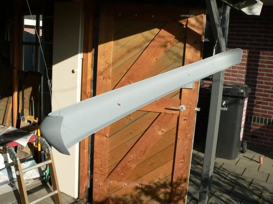

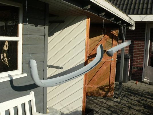

I was given 2 bumpers, of which I used the rear one since my own front one was in good condition. I sprayed them but the finish wasn't that good since I did it kind of hasty, the sandingjob wasn't that good. But I just wanted to get it done so I can take the car for an APK (Dutch version of the MOT), I can give the bumpers a nice finish later.
The car is really almost done now, only need to treat the wheelarches with undercoating and do some minor things. So I'm guessing for it to be on the road if the APK turns out well on the weekend of the 5th of may.
A few pictures of the newly sprayed bumpers attached.
