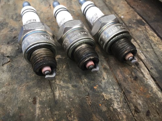

Re-checked the timing and reset to 7° around 700 / 750rpm. Now runs better but the plugs are black. (So I need a smaller minimum jet or to reset the mix-screw air?).

If your plugs are black, try this:
inside your car, push your choke button all the way in. Then on your carb, loosen the screw that holds the choke cable in place. Then hold the cable so it doesn't move and see if you can open the choke flap a little more.
With the choke button pushed in, the choke flap must be fully open. That is the correct running position.
if it's not fully open, then that means that you're driving on choke and your mixture will be too rich and cause black plugs.

The spark-plugs right now are in this condition.
Right now, if I want to rich up the mixture what I have to do?
The max speed is around 100km/h is normal?
Next year I hope to be at Thenay but with that speed maybe I have to leave home a bit earlier.:doh::doh::D
