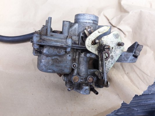

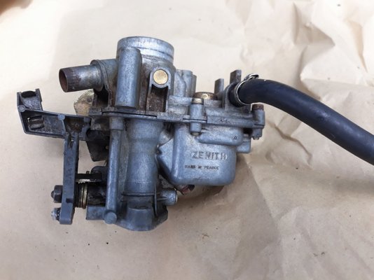

Hi, can someone please tell me if this is a Zenith 28 IF carb, so I can get the right o/Haul kit? Thanks!
Thanks! At least I can get the right bits now, although having had it apart it still runs like a bag of poo. The mixture screw seemed to have very little effect when turning it!

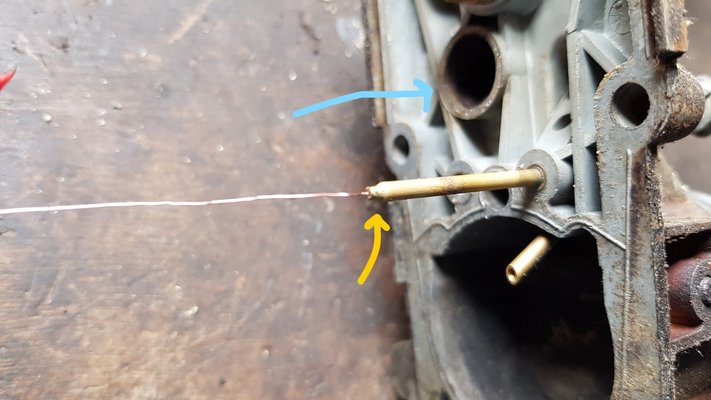

It's worth checking a couple of things when you've got the top off the carburettor:
There's a filter you can get to via the hole with the blue arrow - it often gets blocked up - if you turn the top of the carb upside down and fill the hole with carb cleaner a few times, you'll be able to clean the filter.
If the jet with the yellow arrow gets blocked (they often are), the car won't run well. Carb cleaner on its own sometimes isn't enough - a bit of soft wire followed by carb cleaner does the job well.20200607_150913_LI.jpg
