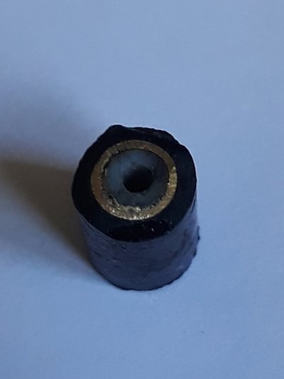

In the best tradition of British bodging I raided my modeling supplies and glued three tubes together to make this, a restrictor for the small pipe to the carb. Fired her up and she is purring! Oh happy days! :)
