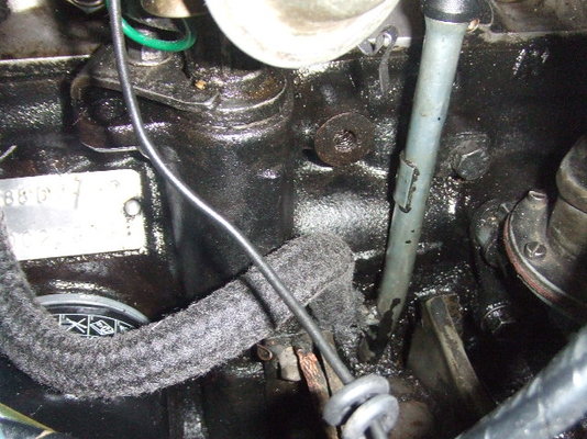

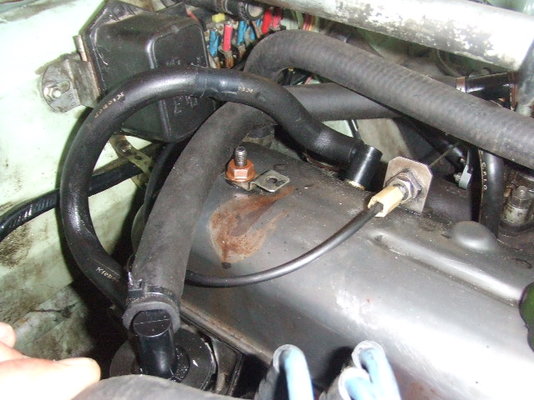

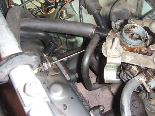

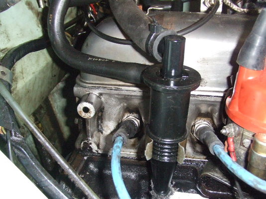

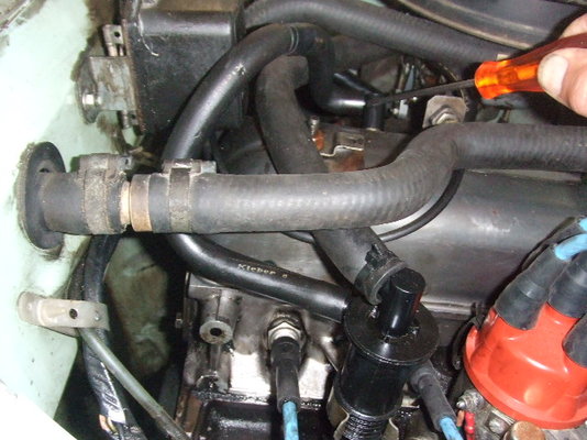

Firstly I've sent some photos to show the pipes, and the plastic cyclone oil separator(thanks Angel).
Basically the pipe runs from the dipstick, through the plastic cone and to the carb.
On the way there, there is a pipe from the cone to the rocker cover breather pipe, also just before the carb a T-piece runs another pipe to the inlet manifold at the base of the carb.
Today I checked air pressure at the ends of all pipes. There was a lot of pressure from the breather pipe and this blows towards and into the plastic cyclone cone. The tube was also bunged up with old hard oil sludge.
That didn't make sense to me so I pulled off the pipe at the breather tube and went up killer hill and NO SMOKE! What do you think?
I'm so happy now! My car is called Genevieve by the way!
