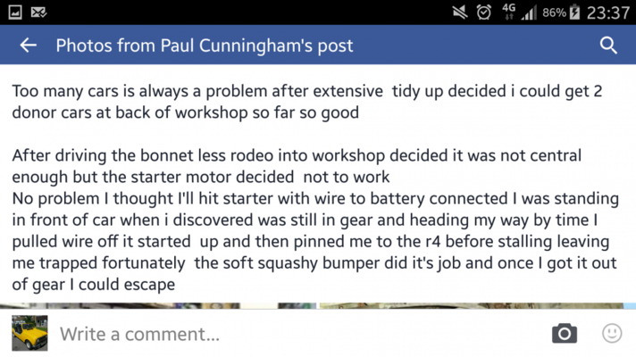

Can't remember if I've told this story on here or not but rather than retype it and facebook won't seem to let me copy and paste I will attach screenshots from my phone
This is what happens when you are on your own with no way of turning key and tapping starter at same time

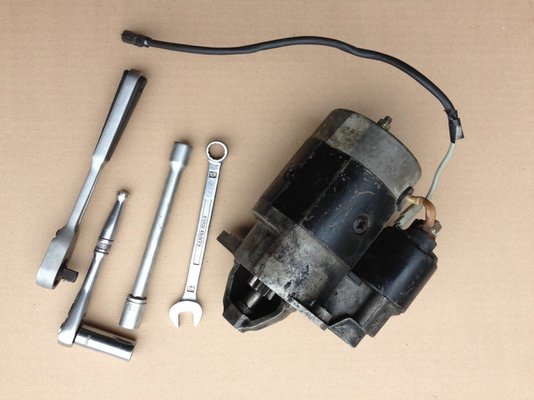

OK starter motor is off the car. I think we should start a new category where we compete against each other to time difficult procedures involving mechanics. Start to on the bench for LHD Savanne 26 minutes. Considering I have hands like a Gorilla, and probably slightly less mechanical prowess, I'm quite pleased with that benchmark time for others to beat.
Anyway the starter is completely dead. No amount of differing combination of battery connection and jump leads results in anything but sparks. Obviously I need a replacement, so,if anyone he's such a thing or recommendation where to locate I'd be more than grateful.
Attached photo also showing tools required all 13mm.
Sequence I followed, disconnect battery, disconnect steering rod, remove engine bracket, three bolts holding starter, remove clutch cable braket
