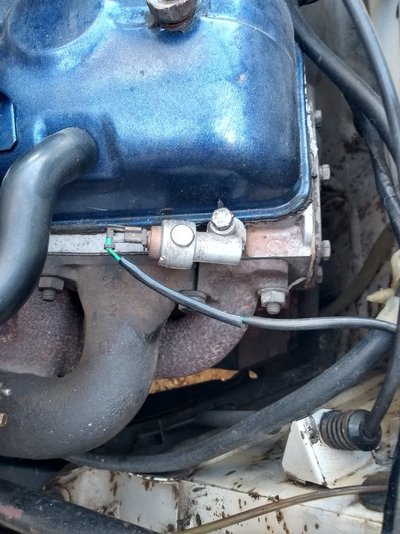

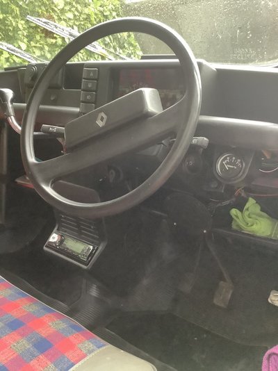

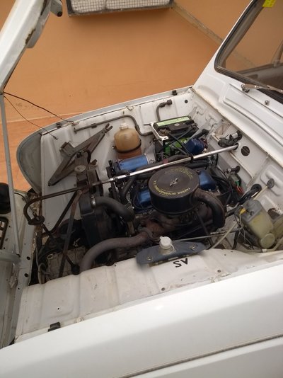

The sensor in your picture is the same as the ones GTL drivers will be familiar with - the 813 and 688 are both Cléon engines.So do you think this in my picture is the heat sensor . I bought an owners manual for a Renault 4 but it never seems to have the information I need for my car . Do you think this is because it's a Spanish built car and where could I get the correct manual . Thanks
drive.google.com

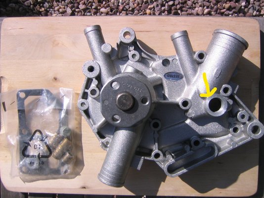

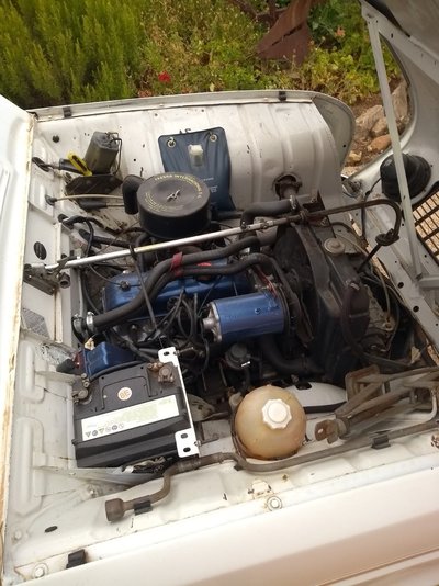

It seems my pump is different. The sensor goes where the black cable is. So I guess I have to unscrew that nut and insert the thermometer there. Hopefully I bought the right one and it fitsThis is a typical Cléon water pump - the arrowed hole is the one sensors usually go in.
Your car has the 'small' Billancourt engine - quite different from the Cléon engine.It seems my pump is different. The sensor goes where the black cable is. So I guess I have to unscrew that nut and insert the thermometer there. Hopefully I bought the right one and it fits
