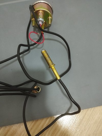

I bought this mechanical one. I don't know how to install it though. Is it even possible to use this one?

You can use this. But you have to get creatieve.
Temperature readings are all about right placing and enough contact patch at your sensor to take over accurate temperature.
So placing must be below/ behind thermostat in the waterflow or attached with enough heat transmission on the outside. Like directly at the cillinder head. You could even JB weld this sensor at the cillinder head.
Don't think to much. Just buy a matching set and work with it.
I myself bought a Chinese set. With 1/8 unf treads. And a matching m18x 1.5 I think btass insert. I pulled the switching sensor and put this temperature sensor in its place.
It works well on thr billancourt engine

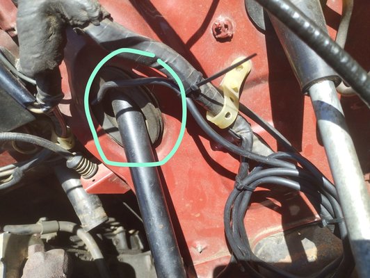

Finally succeeded. I had the adaptor made and I had to get a gasket because it was leaking. Now I just have to find a hole big enough for the sensor to go through in order to have the meter inside the cabin. Any ideas?
Maybe @Grenuj can tell me. I saw a picture but couldn't figure out the spot
