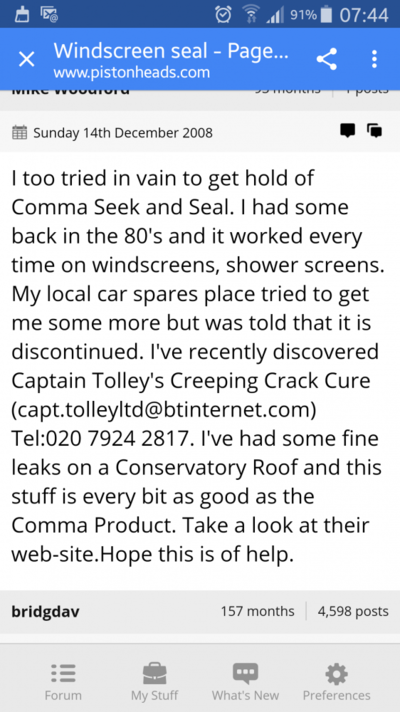

Well i've used seek and seal sucessfully many times in the past seems to have become extinct guess now we have mostly got bonded windscreens no demand

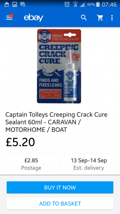

Creeping crack cure is going to be my suggestion
How does it work?

Well I'm back from our New England holiday and curious to see how successful my attempts at sealing the windscreen has been. Oops, a small puddle on the rubber mat and 1/4 pint of water in the glove 'shelf'. There's no way I can get the nozzle of the sealer between rubber and bodywork, perhaps the aged rubber is just to stiff and won't peal back sufficient, so I have now bought a tube of the famed Captain Tolley's Creeping Crack Cure so onto Plan C. I will NOT allow this to beat me.
