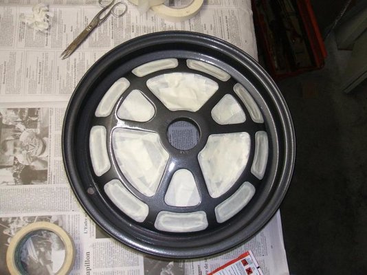

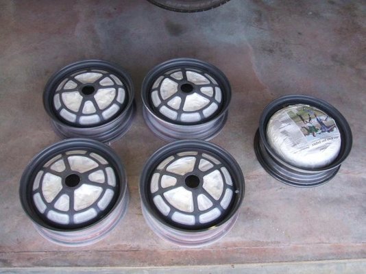

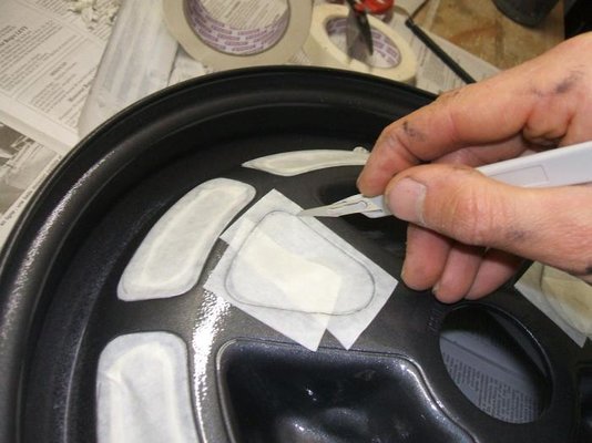

Just packed the black with paper tape and painted the surrounding in gray... The paper moved under the spray breeze! The glue is not very good it seems... Now I have some gray under the paper, in the black-should-be areas...
Not good at all. Just waiting for the paint to harden and took away the paper tape, to see the real size of the disaster...

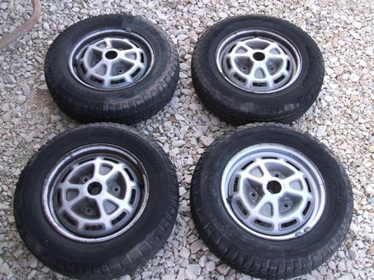

this kind of hard job makes me thinking I have did the same many months ago... If it can help someone of this thread...

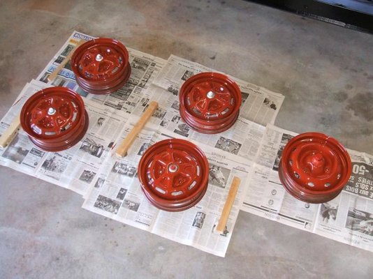

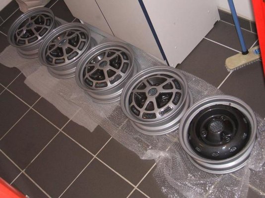

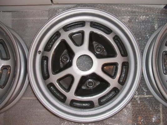

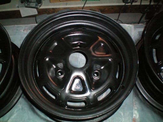

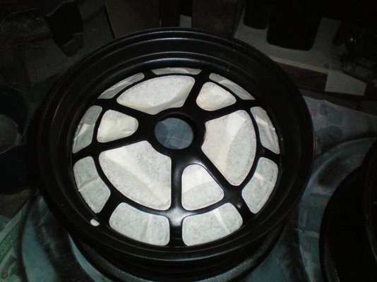

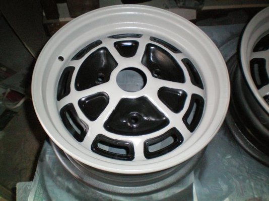

I have read your thread, very interesting and detailed, I copied your method of masking with tape the black areas... Some photo of the end of my job:

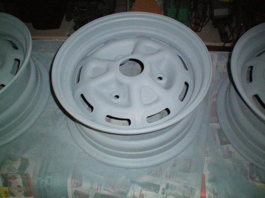

They are not so precise as yours, but I am satisfied by my first spray painting job...

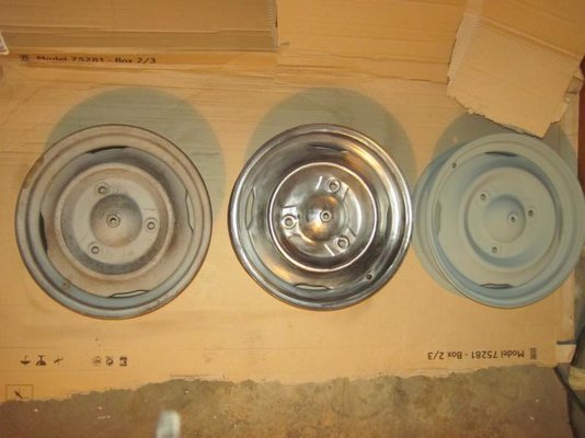

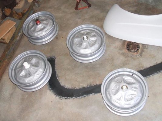

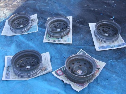

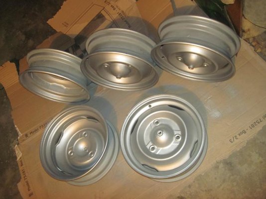

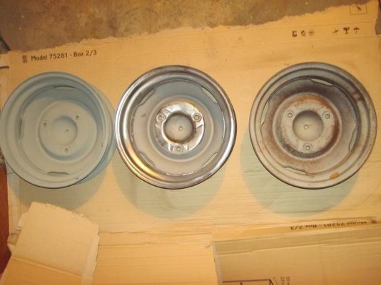

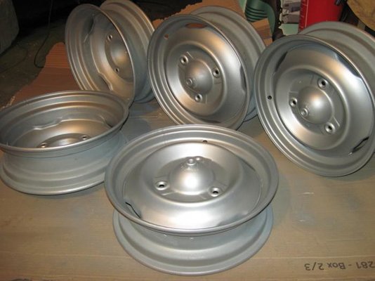

i am surprised how many of you are also currently doing the same matter as i; i did few weeks ago ask for the paint code for 77-'wheels-no reply.

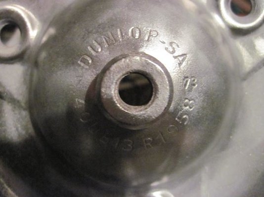

My (summer) wheels are alike yours "bob86600" and found the fine dunlop stamping on those.One of the wheels is assembled by riveting-i think it must be the spre tyre wheel.

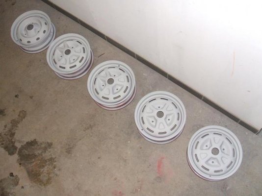

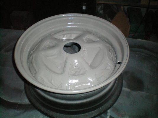

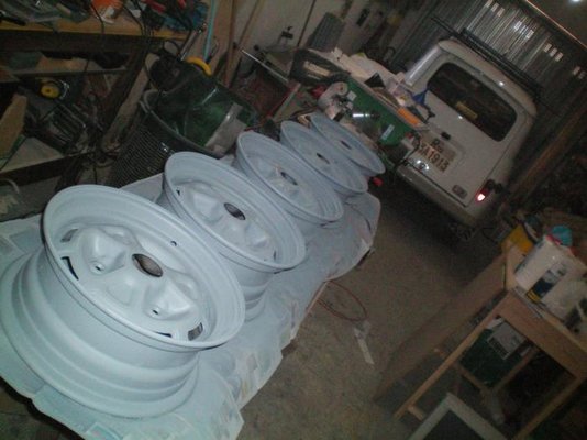

What i did, i apolize that dont have photos here in office, but i did took 5wheels to local sandblasting works(rubbers on) and cost only 5E/pc.
Then i decided to grind visible surfaces with heavy had´nd grinder with rotating steel brush.Then i found that work will be impossible with rubbers on.Took wheels to local tyre changing and took the rubbers off-free of charge! After that i have been grinding the sandblasted surfaces to a shiny level(because a normal sand blasting does not make an even surface) and also edges where tyres are connected.Then zink primer layer+grey primer+final metalgrey primer(not the normal cheap wheel paint but a real cover paint).
i'll put some photos afterwards-not finished yet.

I have been looking for many years to find a reference for that silverish colour used on 70's wheels, but it seems no one has any clue... I have a new set of wheels, the style fitted on Savane, Jogging and Sixties (rectangular holes), if their colour was the same as 70s plain wheels, I could take one to a paint shop and find an exact match.
Your approach is the best way to paint wheels, but you don't need to wire brush the wheels after sand blasting them. The slightly rough surface helps the paint layers key in, and you won't notice it on the finished wheel as 2-3 coats of paint (even better if it's primer) will fill it and the wheel will look smooth.
