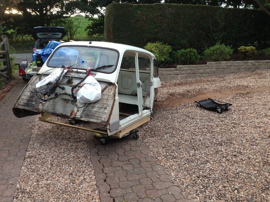

Great work and great progress! You had lots of help .....that's brilliant. Mind you trying to persuade them to hold something while lying on the cold hard garage floor on a Sunday eve in December will likely prove more difficult ! I see you made a supporting frame -well done with that too. It will pay to elevate that later when you come to weld the body .
Yes I got the idea for the wooden frame from you and was very relieved when the body fitted onto it correctly. I was going to add wheels like you had but they were £10 each from B&Q so I didn't. Yes I will make the dolly higher before I tackle the bodywork. Thanks for your advice. Bob

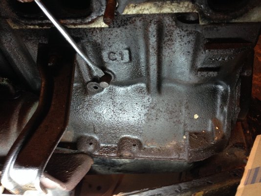

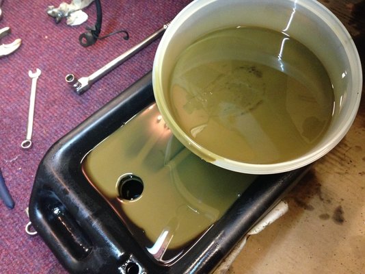

Obviously I should have drained the oil long ago, after I got the engine running, but I didn't and now we are so far away from getting it running that I had to drain it cold. Black sludge came out of the engine and this wonderfully aromatic stuff slopped out of the gearbox. I know Malcomb is collecting paint codes. Perhaps he could also create a colour chart of engine and gearbox oils?

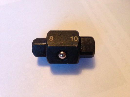

On the subject of Malcomb and oil changes I would like to state for the record that my drain plug required an 8mm tool rather than the 10mm one mentioned in his excellent guide. Luckily the other end of the tool I bought expressly for this purpose was what I needed.
I also forgot to drain the coolant. Is this the drain on the block, where the screwdriver is pointing? If so, what will turn it? It looks rather rounded.
In 1976/7 the drain plug size changed from 10 to 8mm Sq
16mm washer needed not 18mm previously
Maybe the guides need updating
Drain is 11mm use a single hex socket and give up b4 snap it off

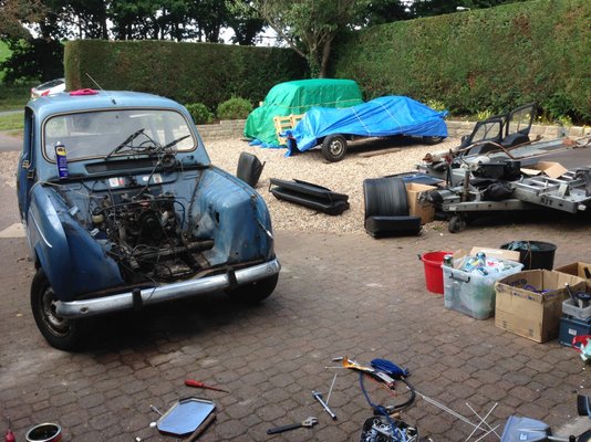

I started work on the blue car today and got quite a lot done. Bonnet and doors off, seats out and everything disconnected inside the engine bay in preparation for lifting the body, all except the brake pipes going into the master cylinder which was I cannot undo. It was a pain on the white GTL too and I ended up cutting them.
In the background of the photo you can see the body of the white car under the green tarp and the chassis under the blue tarp. I'm now going to remove the wings of the blue car and lift the body and compare chassis. My guess, based on what I can see already, is that the chassis and body of the blue car is much better than the white car but the engine and wiring in the white car are better. (The blue car had lots of additional wiring for a radio and lots of speakers and one part of the harness under the bonnet has burnt out). The black vinyl seats and floor mats in the blue car are also better than the cloth seats in the white car.
Today I had a great surprise because through the post I received the registration documents and keys for the blue car, both of which we feared had been lost. I guess there's no big issue with the DVLA if I put the white car's engine in the blue car (?)
The blue one is looking decidedly better already. Just look at those inner wings -no fudged repair to the top edges . Ok there are going to be other areas but that's a good place to be good if you see what I mean. Love your enthusiasm keep up the great work:clapping:
