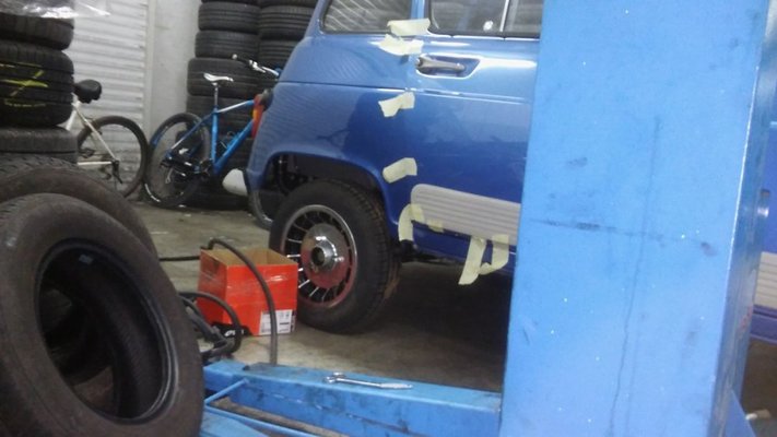

Finally after 5 days of try and error system i have managed to level up my R4.
Took me 5 times to disassembled and assembled front torsion bars....rears i did not touched.

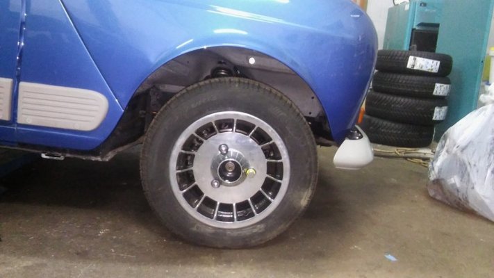

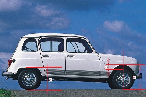

Front end is lower than factory is asking.
left side
H1 = 256mm
H2 = 180mm
H = -76mm (35mm lower than it should be)
right side
H1 = 256mm
H2 = 185mm
H = -71mm (30mm lower that it should be)
As it is my right side is higher than left for 5 mm (as i am driving right hand drive car
Rear end is higher than it should be
left side
H4 = 256mm
H5 = 425mm
H = 169mm (42mm higher than it should be)
right side
H4 = 256mm
H5 = 432mm
H = 176mm (49mm higher that it should be)
Also have measured height from ground to the wheel arches according to this picture
left side
A = 85mm
B = 615mm
C = 610mm
right side
A = 90mm
B = 620mm
C = 620mm
I did not aim perfect angle to the ground so one or two mm are error that everybody here must be aware.

P.S. For all of you who will read this post i have one request (kindly asking
) . Can you measure distances A, B and C on left and right side and post it here or send me PM.
