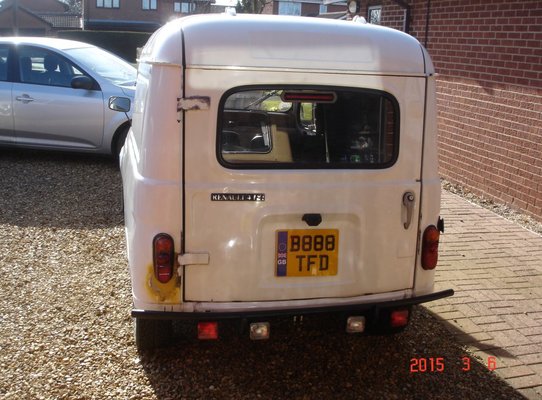

Fitted a high level brake light to the rear window. It and the offside brake light worked but nearside dead.:doh: Another bulb still same so detailed check to find cable had frayed where it went through grommet into light assembly.
After much fiddling underneath spliced new length in all working OK now. :clapping: Ah well the joys of ownership!!
Little bit more done on Van.
High level brake-light added, doubled up on rear fog lamps, added reversing lights, fixed broken wire to nearside rear light cluster.
Painted rear bumper in matt black. Area around light cluster needing white paint. New number plateDSC08905.JPG

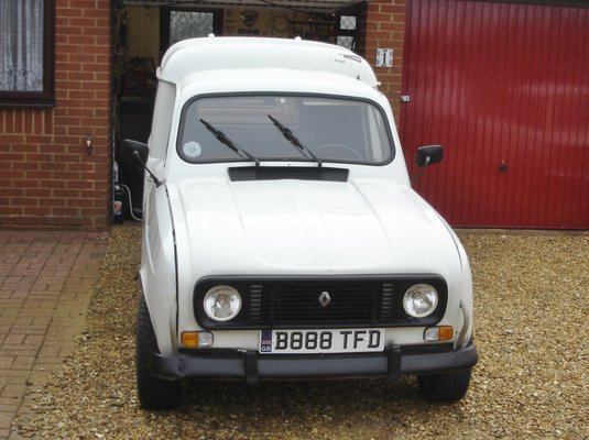

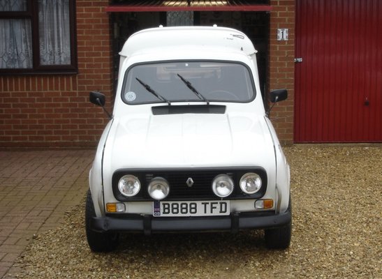

Front now. Matt black bumper and grill. New Cibie headlights, new side / indicator lights.

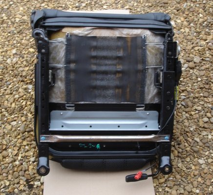

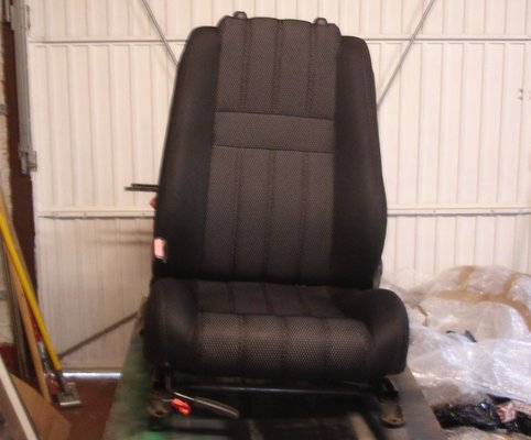

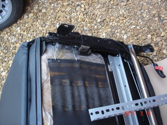

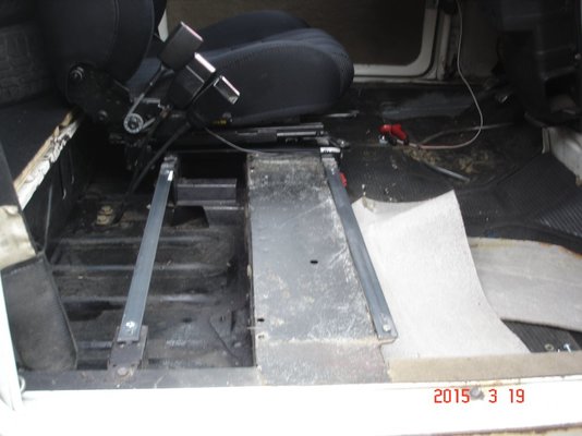

Have been offered some seats for the van. From MGF.
Seem to fit in space there and will need some sorting out of fixings.DSC08917.JPG DSC08918.JPG
Trickiest bit adapting seats is when you make all the adapter plates and then find the seat won't slide all the way back to allow normal size people to drive

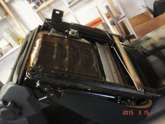

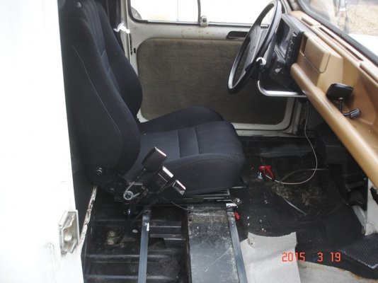

Managed to get some more work done on seat arrangement.
Basically I am utilising the existing seat fixing points and spanning across with 25 x 4mm strip drilled to suit.
Then another 25 x 4mm strip is attached to seat mounting points and these will be tack welded to fixing strips.
Not criticising at all but from experience depending on your weight 4mm may prove a bit flexible once you sit in it as I used 6 × 40mm when I last modded a seat for a different car
Hi Paul
Existing centre to centre on van is 475mm. MGF seats are 420mm.
From edge of box section to centre rear strip is 140mm.
I looked at fact that except for this 140mm distance the strip will be totally supported on the box section.
Additionally the offset is only 27.5mm so there is deflection but only minimal.
If the box section was not there I would have used a 25mm square hollow section to span.
Reaction at front is due to an overhang of about 40mm. Again not excessive enough to cause concern.
