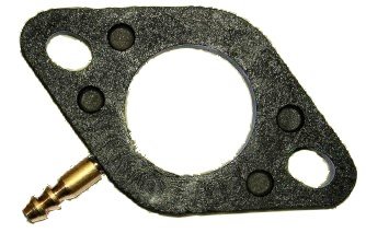

I was intending to maybe use an adapter 'gasket' for the vacuum gauge takeoff.
Speedograph Richfield do a range of them for different carbs.

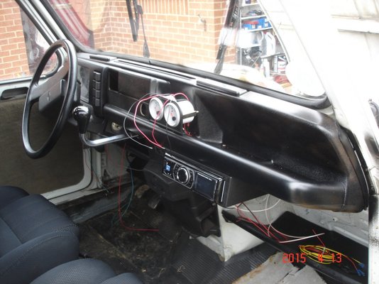

OK people. Been busy and after some racking of brain have got an universal DIN holder fixed in for the radio / USB etc., player.
Also got location for voltmeter and oil pressure gauge sorted out and 'first fixed'.
Additionally 1 hole cut out for a cigarette lighter outlet. Am also considering a dual USB outlet as well. There is room without interfering with operation of windscreen wiper motor.

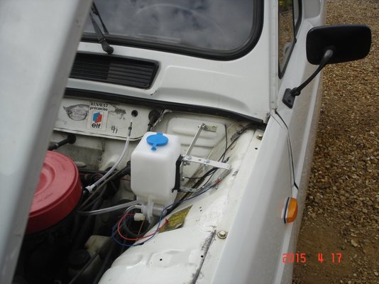

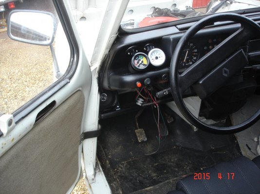

DSC08961.JPG DSC08963.JPG More ongoing to the van.
Electric after-market windscreen washer system mounted vertically with my Forth Road Bridge structure.
Additionally vacuum gauge located, some fettling needed. Pioneer 180W 100mm speakers fit nicely in the parcel shelf.
