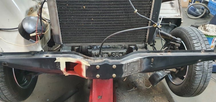

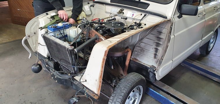

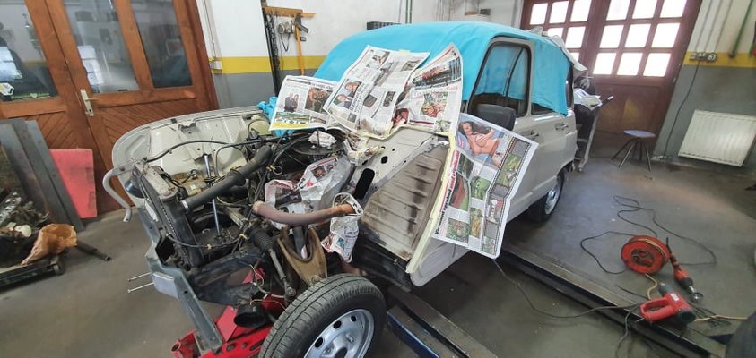

Hello! Long time, no see... anyway, after some time, I finally get on schedule for repairing front chassis beams. On Monday, early in the morning, I went to well known little town Žiri in Slovenia. This view was the proof that I am at the right spot...
Then the work begin...

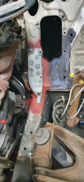

Rusted spot...

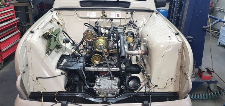

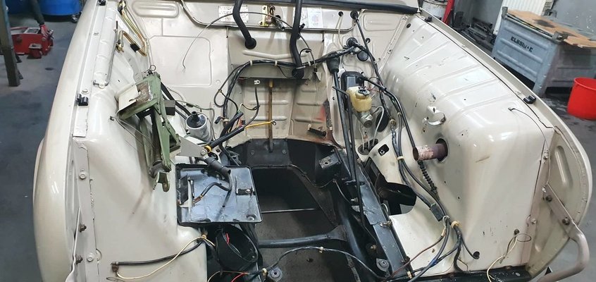

Disassembling on the interior because it is necessary to remove wheel column for that kind of job...
Front Napoleon cap also needed repair
Find the welded spot if you can :D
All rusted parts are replaced with new or repaired
We worked until 7pm every day. It was about 10 hours of work every day... the room is clean, without tools on the ground, every tool has its own place. 156451445_1031133653956817_2999314356501183016_n.jpg

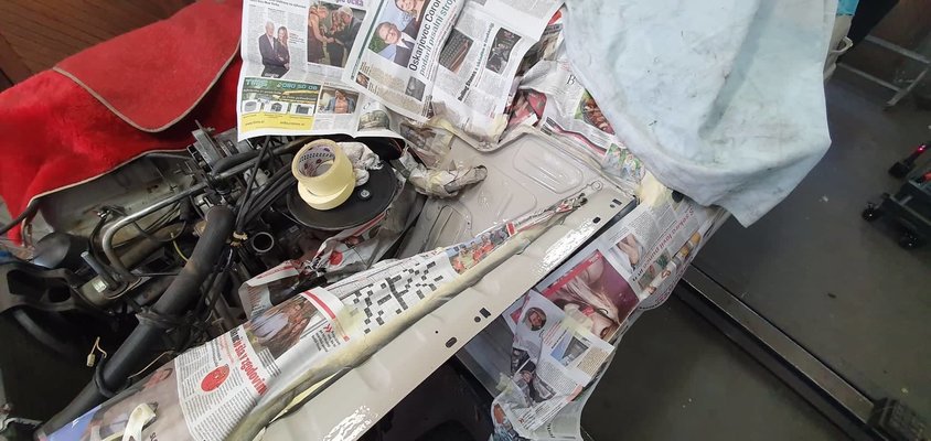

Waking up at 6, by 7 we were at the workshop and after coffee and breakfast, we started... The major part of the welding was done 1st day, so now it is time for paint job and putting all in place...156674015_221107563049031_9190376655880291615_n.jpg156613633_240320721068602_3422050339481196837_n.jpg156592645_129031119140111_7429927355837826310_n.jpg

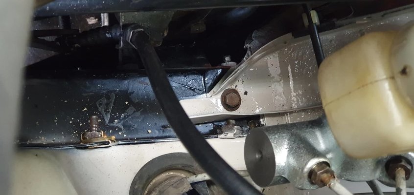

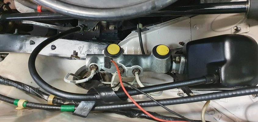

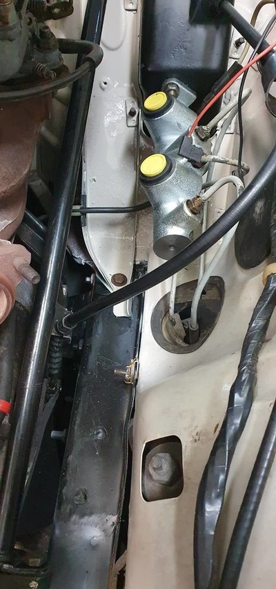

Master cylinder and repaired part

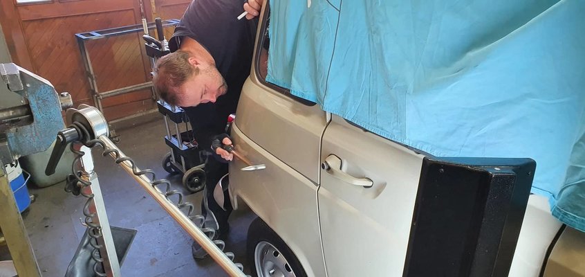

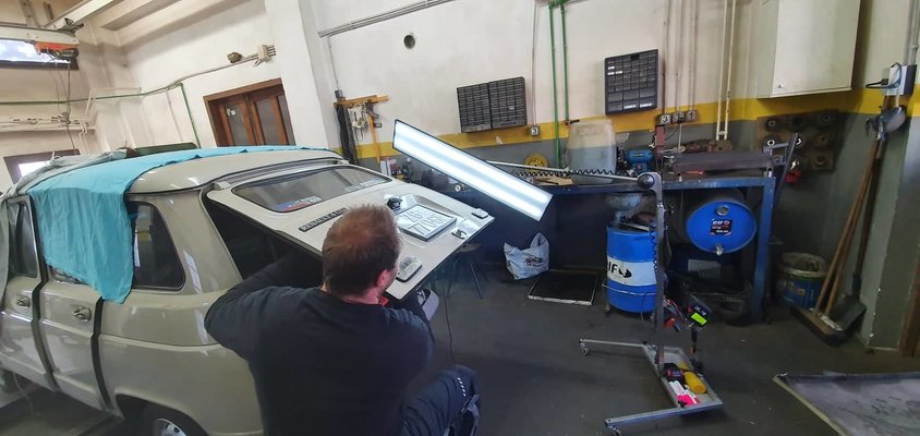

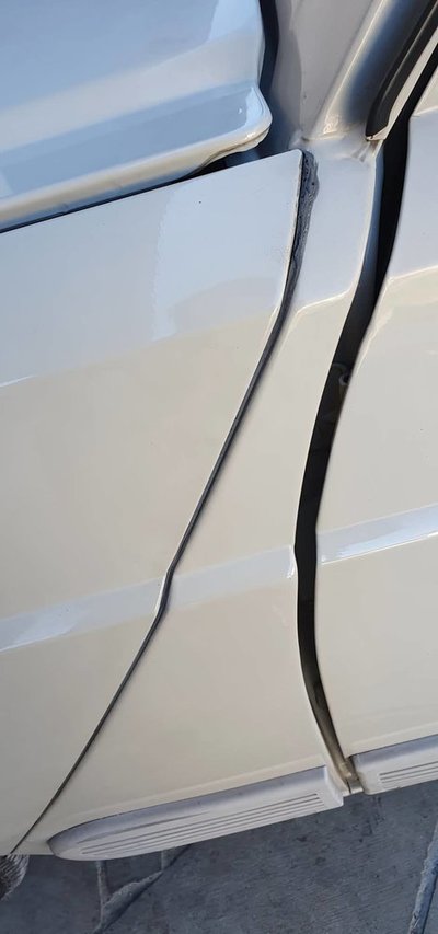

I had luck because the guy who can repair small dents was around... the rear wing was in really bad shape...

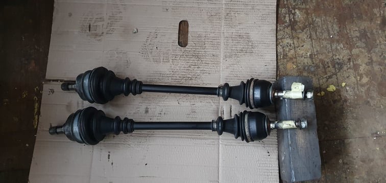

We had to change the valve axle because it had dents and it was making a lot of noise...

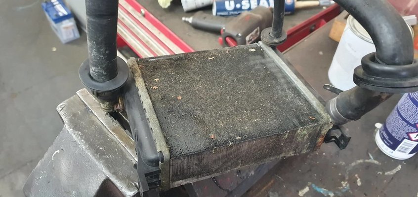

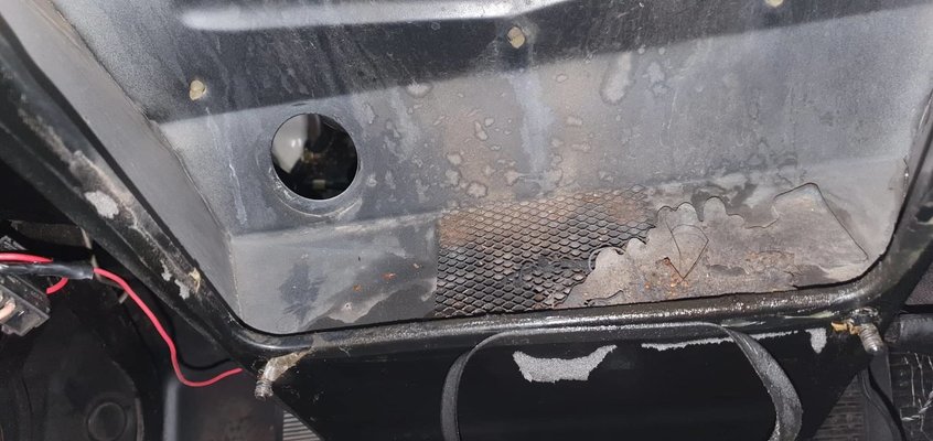

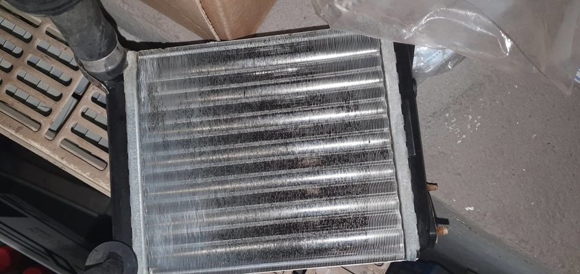

It was the final day of our job. All major things was done. The interior was disassembled so we cleaned the heater
Before
The heater housing

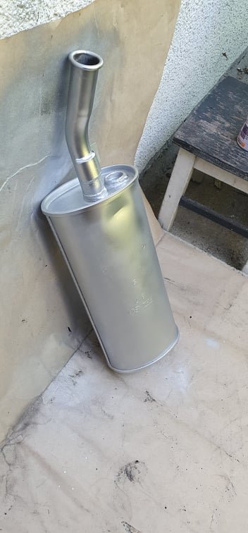

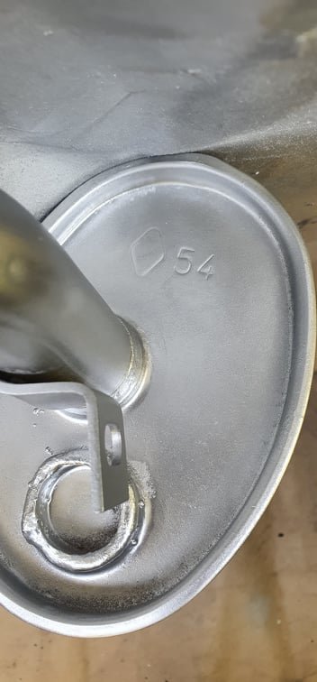

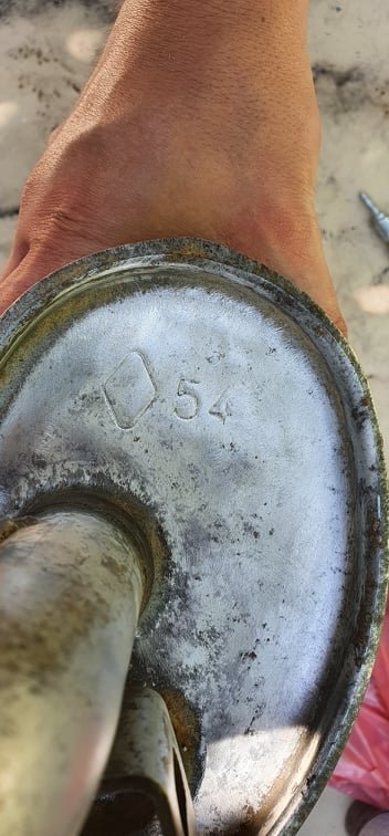

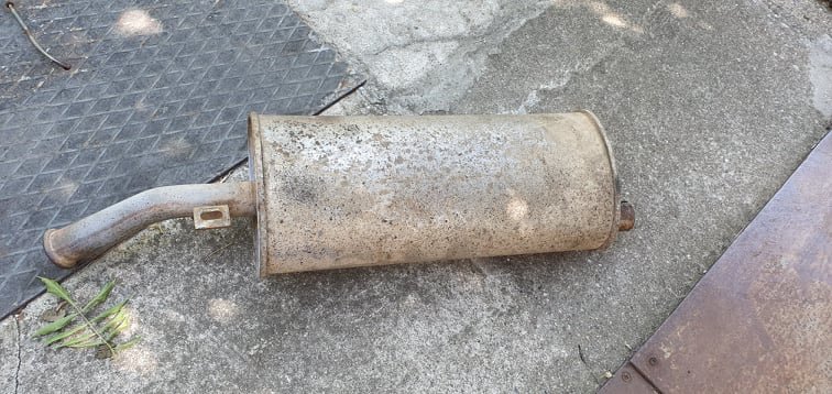

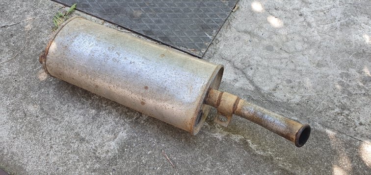

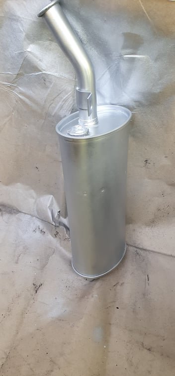

Also, Jan gave me something I wanted for a very very long time- original silencer :clapping: It was in great condition, but needed a little bit of love...
236014985_193360689449367_613705727395225463_n.jpg236183389_588466249192381_8186883791522843067_n.jpg

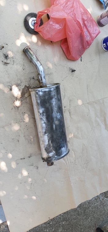

Then I brushed it and give it a good wash with a nitro thinner
237788260_1183247335519802_785524918312534825_n.jpg 238666191_4563699966993951_2618098480676365686_n.jpg
Finally I put the zinc spray and this is the result... :cool:
235949164_1690512087813409_455859262912236178_n.jpg 236330280_535121361034602_8160441507203859126_n.jpg236231963_347610370399435_2105672066193462933_n.jpg
I can't wait to put it on the car... :laughing: I will do a video of sound before & after...

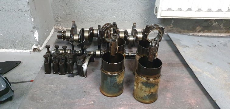

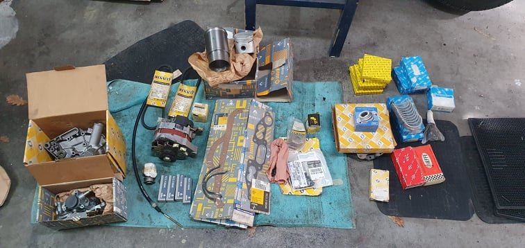

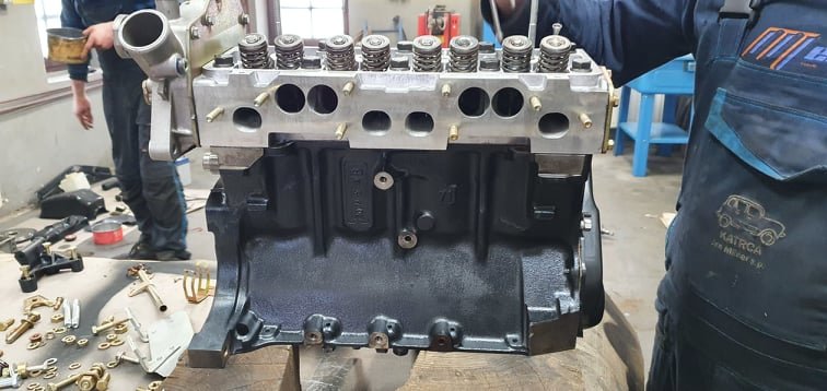

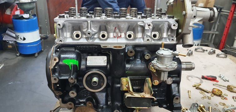

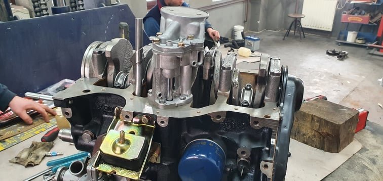

So... about a year ago, I saw some cloudy blue smoke from the exhaust pipe... Trough the years, I collected original Renault parts, so I decided to to a complete engine rebuild.
The choose of mechanic was easy, Jan Mlinar from little Slovenian town Žiri.

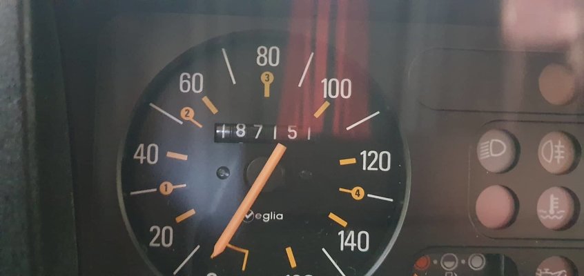

The heart stopped at 187 151 km.

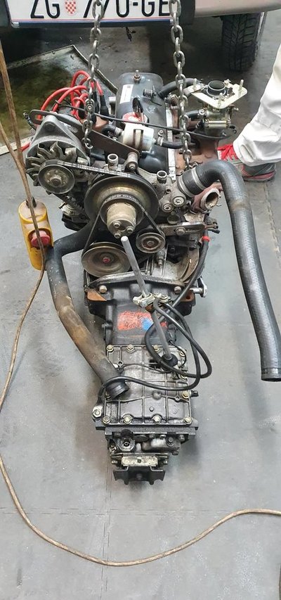

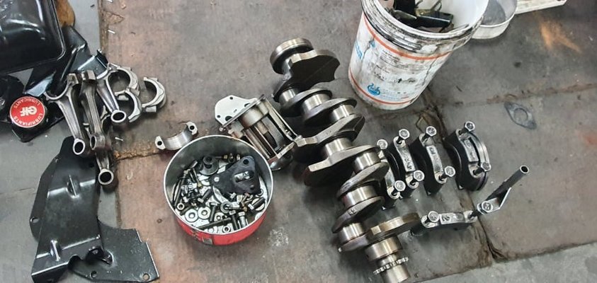

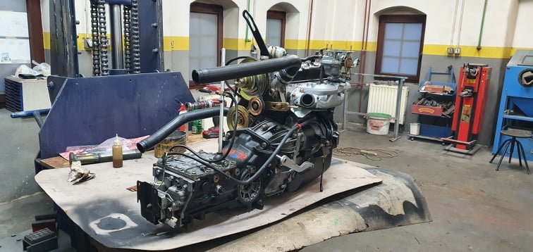

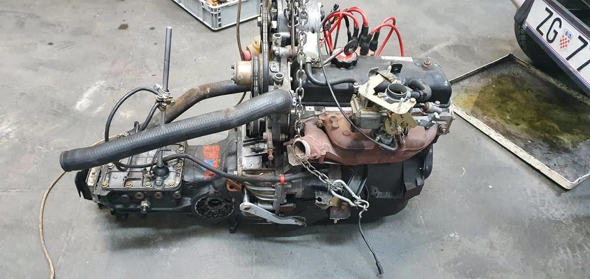

On Monday 31.1. I came to Žiri and after two hours, the situation was like this

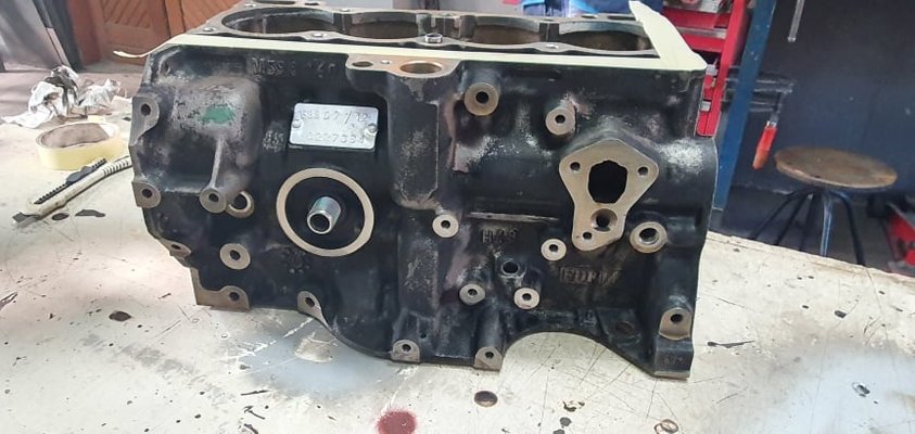

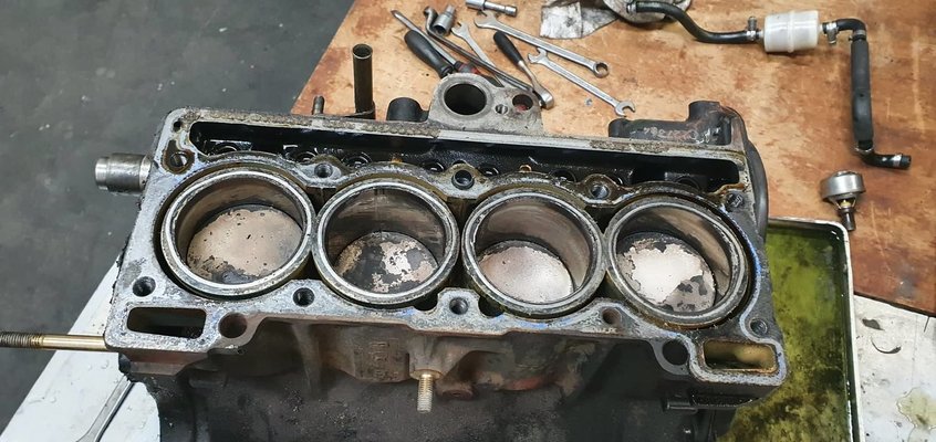

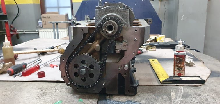

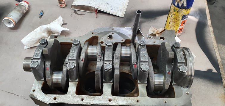

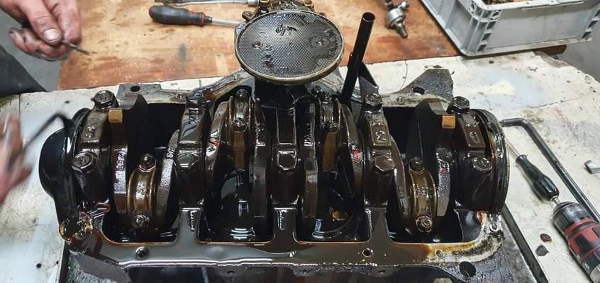

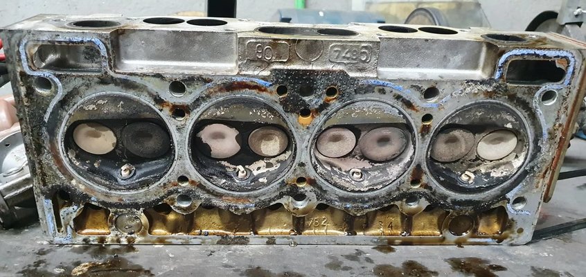

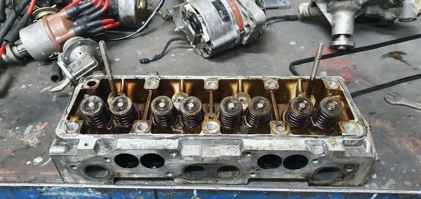

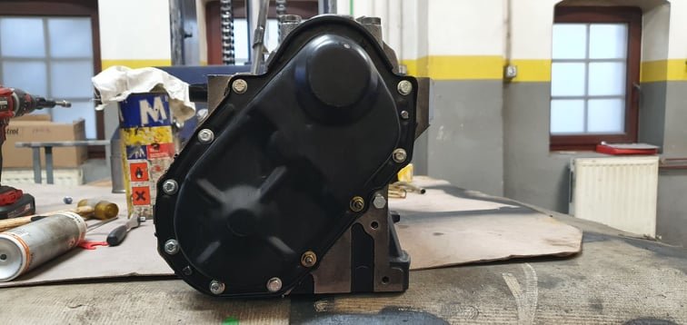

We opened the engine

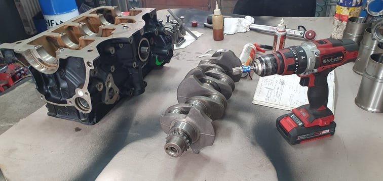

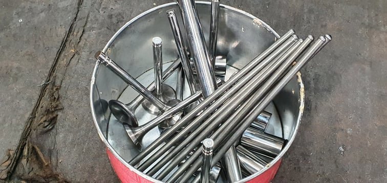

Then we started cleaning all the parts in petrol, then in dimer and we dried everything with compressed air
The most of the Tuesda we spent in cleaning

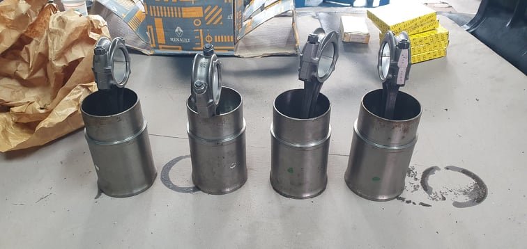

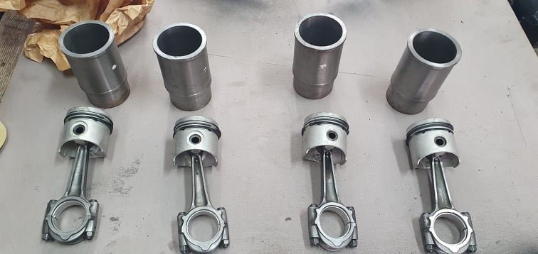

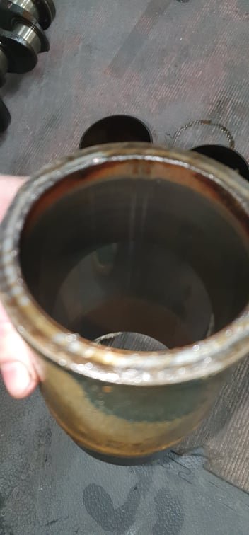

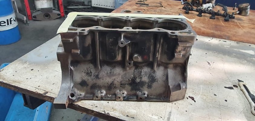

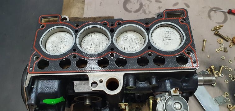

The car overheated once in it's lifetime, so the liners were polished because the pistons expanded due to high temperature

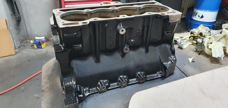

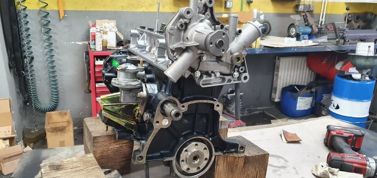

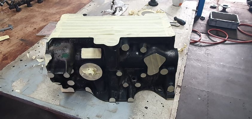

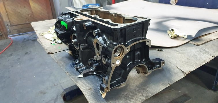

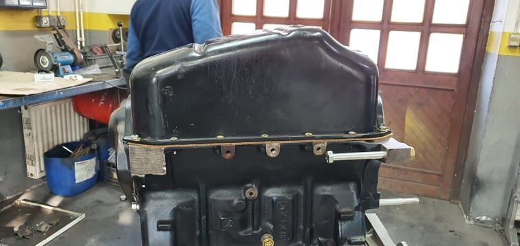

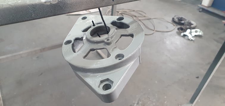

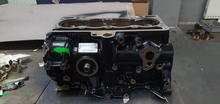

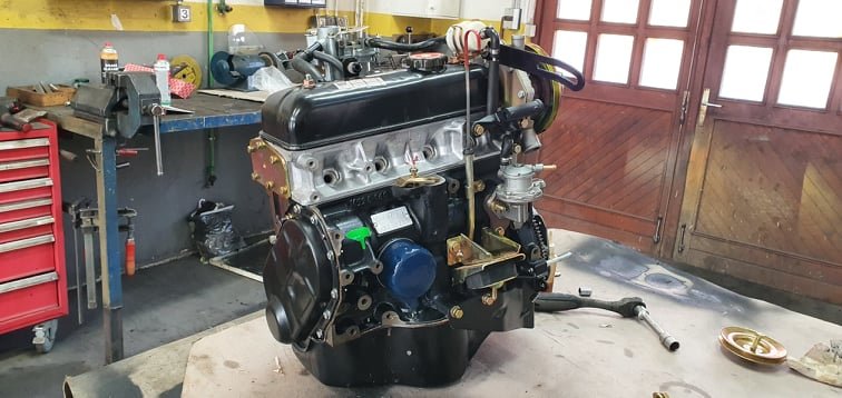

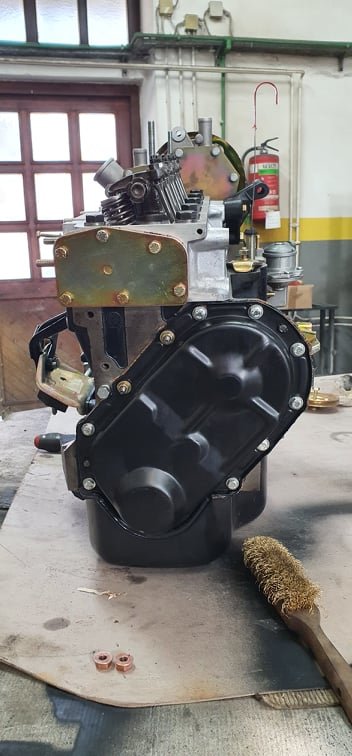

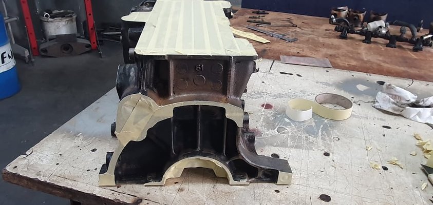

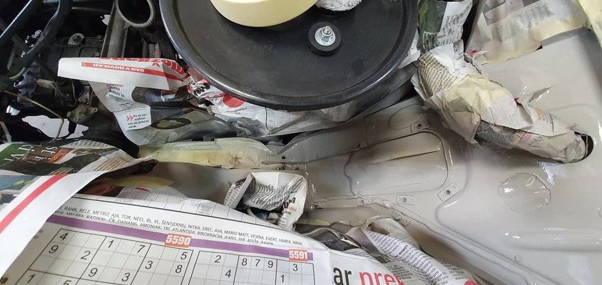

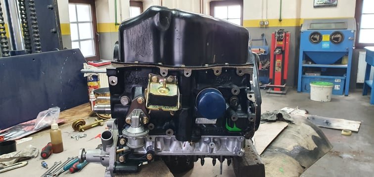

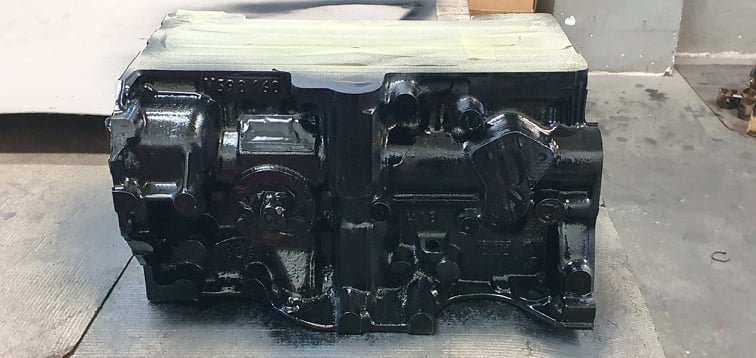

Protecting and painting the engine block

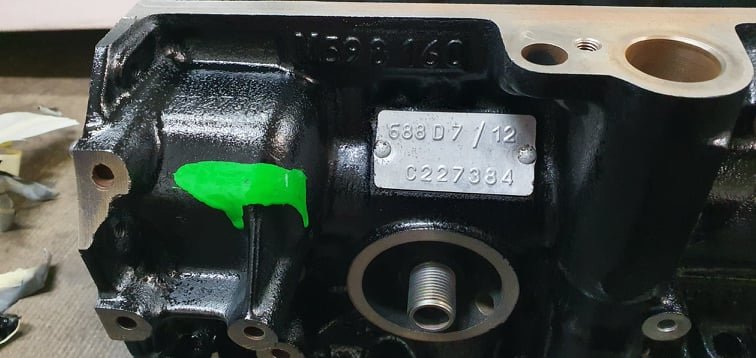

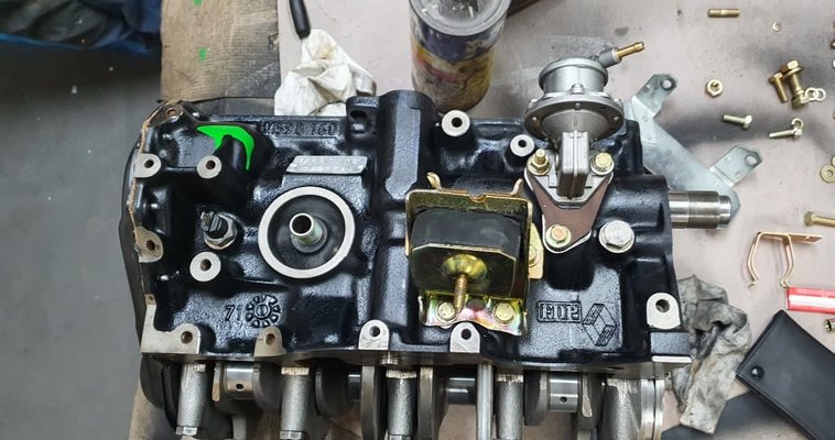

Painted engine block with great detail of original green paint for easier recognization of the engines in Renault factory

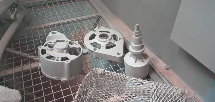

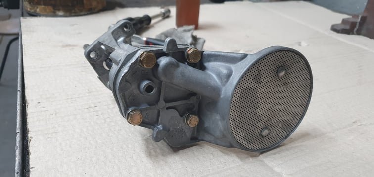

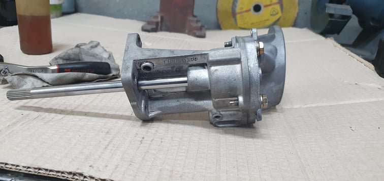

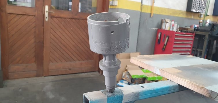

Oil pump cleaned and polished

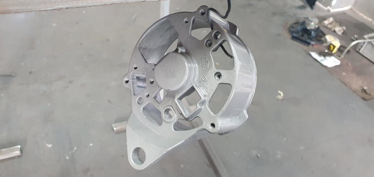

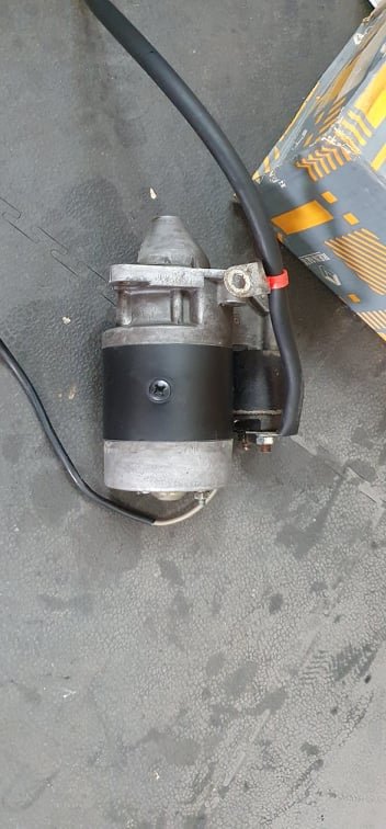

Starter renewed

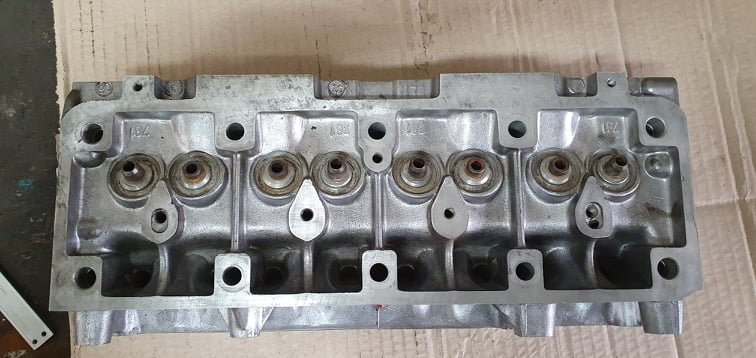

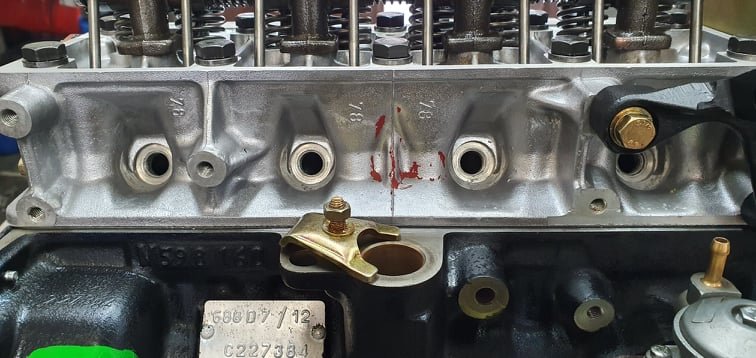

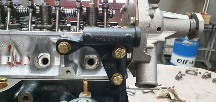

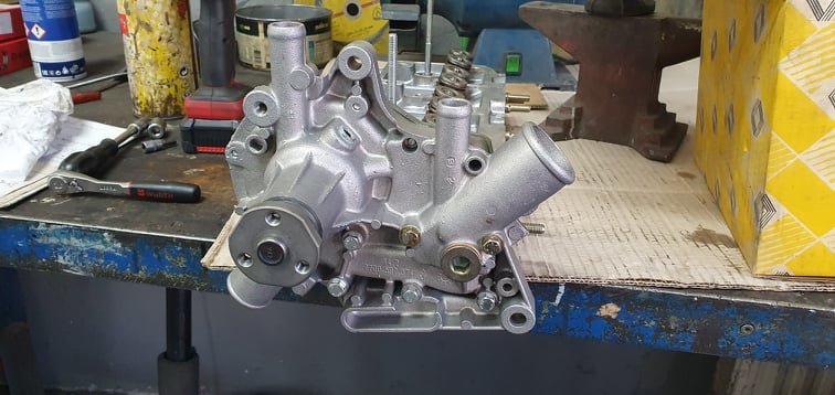

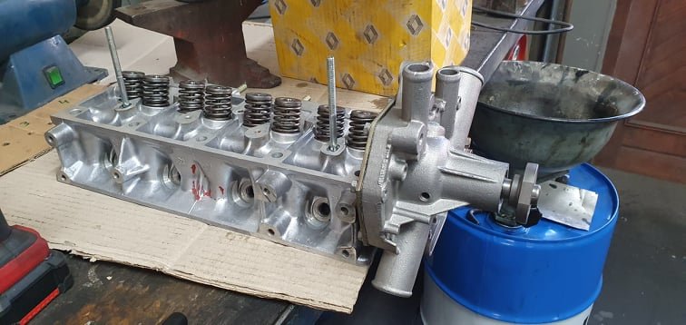

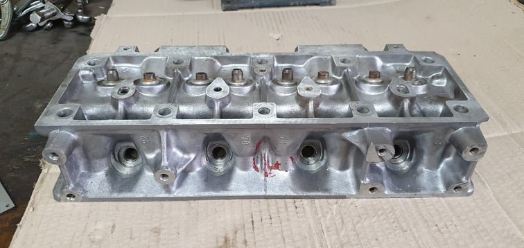

Head when came from resurfacing

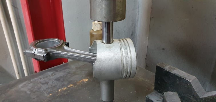

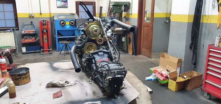

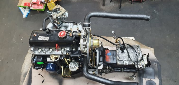

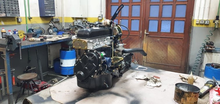

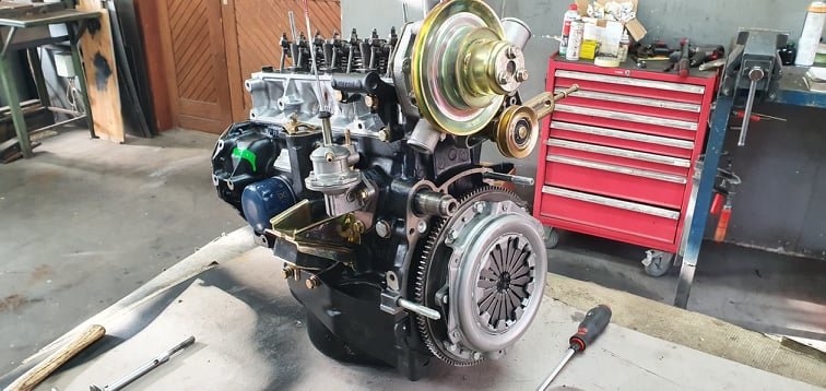

Joining the gearbox to the engine. The gearbox was washed, cleaned and then partly painted where the paint was gone. New clutch was inserted
Axels are painted and rubber was changed

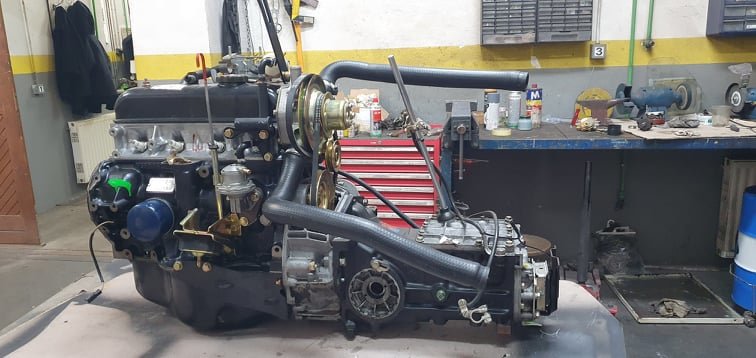

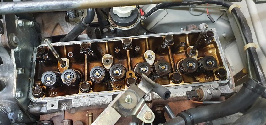

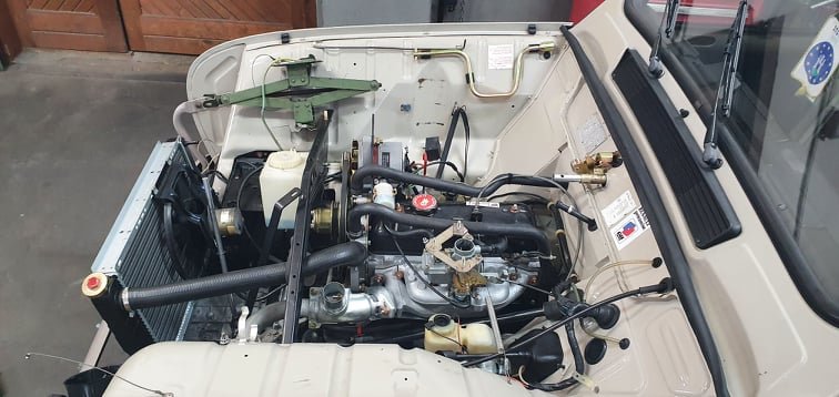

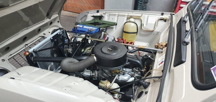

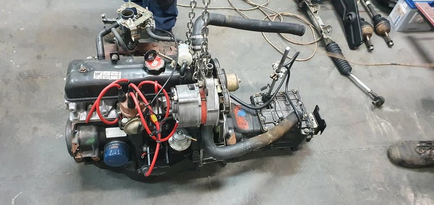

And engine back in place

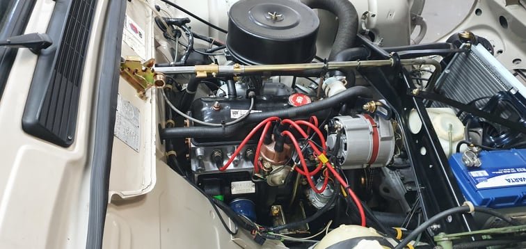

This huge work was done trought 5 days. The car is running more smoothly, very quiet, just like new. In next 1000km, the car should be driven gently, and than I have to make service wich includes new oil, rockets adjustment and tightening the head...
