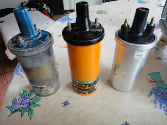

I have just checked the resistance between the positive and the negative terminals on each of the coils (see photo)
Coil number 1 - Original coil
Resistance: 1.6 Ohms
Coils number 2 - second hand
Resistance: 1.8 ohms
Coil number 3 - brand new
Resistance : 2.6
I tried all of these and none worked in the car
I read that the coil should get warm not boiiling hot like mine was.
I did get some ice to cool down coil number 3 yesterday and when the coil was very cold I put it back in but it didnt work.
I am going today to replace coil number 3 to see if a days rest makes it work.
Here are the usual suspects below
