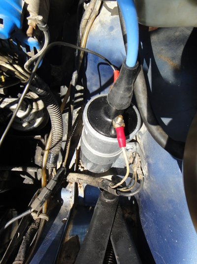

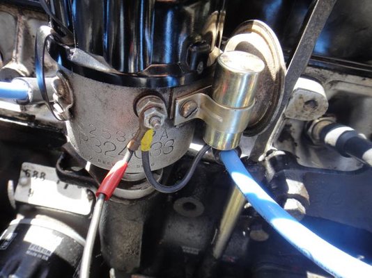

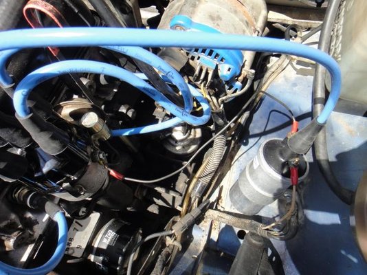

Can you post a photo showing the new coil and dizzy, then we might be able to help eliminate the wiring. ?
i know it's been said before but is the coil wired correctly ? because if it's getting very hot there's definitely something at fault in the wiring.
when you said you stopped it then it would'nt start did you check to see if there a spark at the plugs ? if there is then it must be a fuel problem.
As requested here are some photos of the wiring:
Ignore the fact that they both have a little bit of red on them.
Rest assured that the positive terminal on the coil is attached to the cream/red wire and the negative on the coil is attache3d to the black/red wire.
I have triple checked this.

Wiring all looks good, If it stops again try putting a little fuel in the inlet see if it fires as it could be a fueling issue.
There's something about your distributor set-up that doesn't look right to me.
You could try this:
- Slacken the distributor clamp, and turn the distributor clockwise until the vacuum advance unit is at about 4 o'clock as you look at it from above. Tighten the clamp.
- The clips that hold the distributor cap on should now be at about 10 and 4 o'clock; the condenser should be between about 6 and 7 o'clock.
- Check that the plug leads are connected correctly: As you look at it from above, the cap terminal above the vacuum advance is #1 (the plug nearest the water pump); go round past the condenser and the next one is #3, then #4, then #2.
- Check for spark at points, and cross fingers....
Before you try this, make a note/take a photo of where everything is at the moment, just in case!

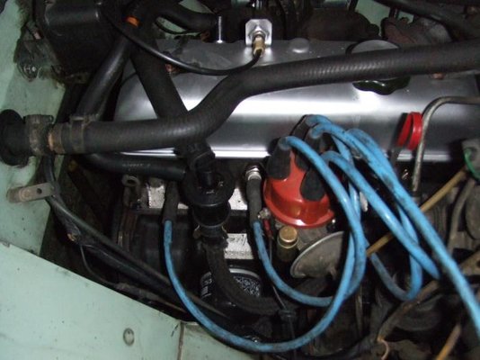

You're absolutely correct, Andy, I put up a photo of my distributor
It looks like Spracker's dizzy is about 90 degrees out
call me crazy tho, but even tho it was wrong (in a weird way) if it runs shouldn't it keep running ?
I'm also interested to know why that if it runs it it doesn't keep running, even if the dizzy is 90 deg out. Even at 90 deg out it is wired up right as you can see plug lead 2 precedes plug lead 1, so the timing must be 1-3-4-2 or it wouldn't run. And why the coil is getting so hot? It's not to do with it being a ballasted resister coil that doesn't have the ballast resistor in the circuit, or has the resister defective or shorted out - don't those coils run on a lower voltage than 12? And therefore overheating because it's getting too much voltage? Or was that mentioned elsewhere earlier and dismissed? Don't know how you would identify what type of coil it was, ballasted type or not. Just an idea.
