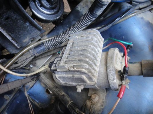

Number 1. Coil: I doesnt look like any coil Ive seen in any of the manuals or photos. Should it have 3 wires on the top? most have just 2.

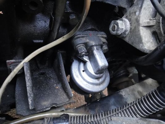

Number 2. Fuel pump: It doesnt look like any fuel pump in the Haynes.

Fuel pump: It has 3 tubes entering it(I thought there would only be 2).
2 rubber tubes entering underneath and one underneath and to the side.
This one I replaced about a year ago and runs to the carburettor via the in-line filter.

I think there lies your problem,someone has fitted a add on electronic ignition,i would bin that straight away,then it will only have two wires ,refit the dizzy with new points and condenser,you can still get proper Valeo ones from Oscaro,the coil may be allright allthough it does not look orginal.
The fuel pump does not have a gauze filter ,you should have a plastic one on top of the rocker box then if you have a Zenith 28 you will find a gauze filter in there which you can clean,also the third line is a return pipe .

That box on the side of your coil could be some kind of electronic ignition module, though it's hard to say more. Where do the three wires go?
Your fuel pump looks like the 'upside down' version designed for RHD cars, though it should work on any. Most fuel pumps can be dismantled - you'll need to unbolt it from the engine first, and oil might spill from the hole. Inside you should find a diaphragm, two one-way valves and a filter. If any of those are blocked or damaged the pump will have problems. I think the third pipe is an overflow back to the fuel tank?
