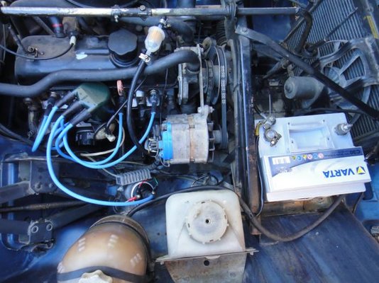

As regards fuel, pump is fine as I have a fuel filter already in place (see photo) and I can see the fuel pumping through fine.

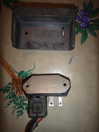

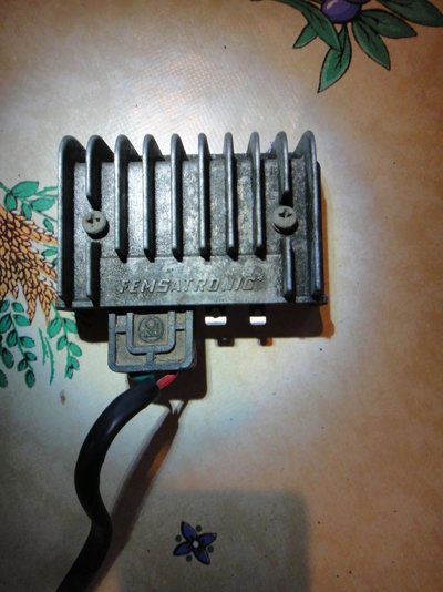

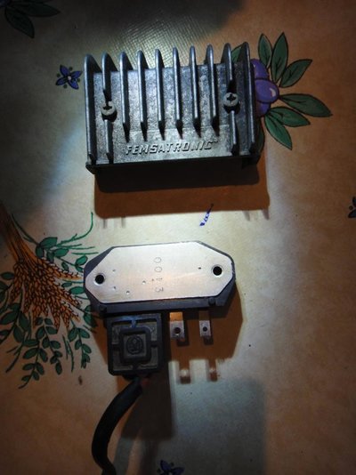

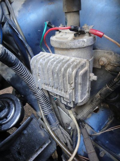

I have removed the electronic module (see below photos) seperated the module from the mini-radiator and cleaned the gunk off both sides.
If its the module that overheats , then the heat wasnt convecting away from the module to the mini-radiator efficiently so....
I have bought some Arctic Silver thermal paste (used in PC's). this I have put between the module and the mini-radiator to help convect the heat away from the electronic module.
In fact when the car broke down and I touched the mini-radiator it wasnt very hot.......which would be correct if it wasnt convecting the heat away from the electronic module quickly enough.
RESUMÉ: (See last photo)
I have changed the battery
I have changed the Coil for a brand new one
I have changed the all the leads from to the plugs and dizzy.
I have replaced the electronic module with better thermal paste.
I am now ready to take Cristine for a test run today.
Will report back later chaps, or much later if I break down in the middle of knowhere.

We R4 people are spoiled by lack of electronics in our cars...these are more than typical symptoms of electronic ignition circuit board. Owners of Italian 80's cars know better, they used to carry one or two spare ignition modules in the glovebox, as replacing it on the side of the road was a routine job...
Don't waste your time with a test light, it is NOT a correct way to see if the module is working. Replace it with a known good one, or (bettesr) revert to points.
Cheers Angel
Yes I have done some diging on that particular module and it was in a lot of fiat 600's.
So that would go along with what you said.
