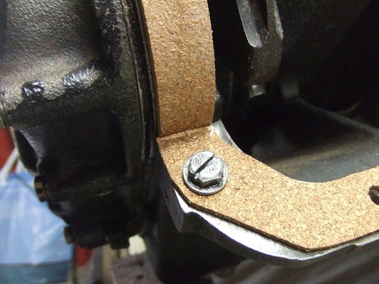

Also when you put on your sump gasket did you overlap it as per the below photo?

I don't remember how I put the sump gasket, followed instruction on haynes manual... I overlapped the two pieces, but can't remember how.
It seemed to me that it was working, but I screwed a bit thd bolts before putting on the engine again and maybe I deformed the oil pan, and now is leaking from the rear.wil try to screw another bit amd see what happens before taking off the engine again.

Cork gaskets are tricky to get right as they should only need nipping up using 1/4 drive ratchet

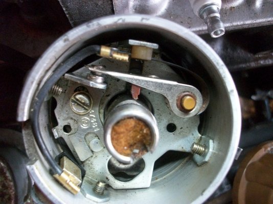

The position of the "finger" on the cam lobe should be as per the following photo, just as the points are about to open.
The flywheel mark will be just before TDC and number 1 piston will be at the top of its stroke with no1 and No2 valves closed

At the end it was just a matter of breakers... the screw that fixes them turned out to be loosen and the distance was not precise as I regulated it.
