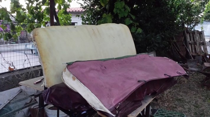

Now I am reassembling the seats: a long timw passed since I dismantled them and very unwisely I did no photos...

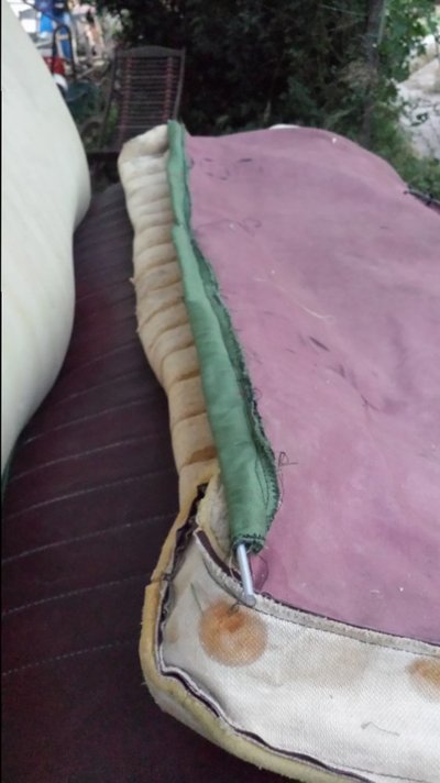

Now I find a 3 mm rod that seems to must run on the upper edge of the front seat... but it seems strange, harmful and useless.
Has anybody here already restored a front bench seat?
Hi Azzazello glad you are back on track . Not restored a front bench seat but I'm pretty certain the wire stiffener will be there in order to provide a secure fixing point or to keep the shape correct
Around the bottom edges a similar system is used with hog rings fastening the covers on . The hog rings are clamped around the steel wire
Yes, there are two pieces of zigzag steel wire at the bottom too.
In the other seats I restored I used plastic fasteners instead of the metal "hog rings". .. planning to do the same here.
The front seat is finally in its normal (or supposed) shape)
