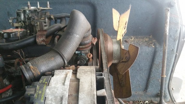

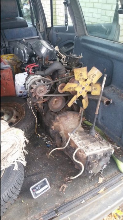

Going back to fan blades I had a look at the 845 r5 engine I've got
It has got 6 blades and a spacer fitted maybe runs hotter as more powerful than R4 version

Will be back on the road soon, have you trimmed your beard in the correct style to emulate that picture?
