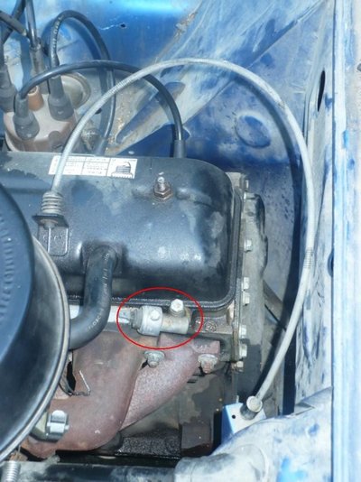

Temperature light comes on I have flash the radiator and water flows
I have waited and see if fan comes on and looks ok
I use a lazer to check the temperature at the block sensor and reads 95 - 100 but light comes on at 95c
Any thoughts?
Sensor at engine.

I do notice the engine bay paint on the side of the bottle the paint has been exposed to hot antifreze I just hope is not head gasket or the head its cracked
I do see a lot of bobbles on the bottle : (

Sorry to hear that, it does sound like there may be a head gasket problem.

Hope you can fix the gasket or whatever is ailing your quatrelle. Be careful and don't let it boil! Water bubbling in the bottle isn't a good sign.
Come down to the temp sensor on the top of the block, trying to find one . I am also installing a digital temp gauge to keep an eye on it.
She is runs great, not signs of overheating , been using for the last 3 days and put over 500 kilometros on it and max temp where the sensor goes is around 95 c, sound about right for these cars under little load.
I think the sensor was suposed to be set as 105c??? on the back on the block BUT the dash light is coming on around 85c, really scared me .

As this temp sensor on cylinder head he is know get broken and start to signalizing on dashboard but actually there is no overheating.

It might not be bad idea to reconsider changing head gasket.
It is not so big job, and not so expensive.
it is old engine and gasket could start to rot.
I have changed on my 1.1 engine while doing major car rebuild, and it was rotten on one cooling channel. Not much but would start to mix water and petrol in some time.
I am not scaring you just trying to give you some info about whole problem!

For now I will install a temp gauge and keep an eye on it , car has power runs very well at 65-70 mph , heater works , the bottle never over flow, I will give some time and see
I got this temp gauge
http://www.kosonorthamerica.com/koso/shop/egt-temps/dl-water-temp-meter-4/
and will tap it somewhere in the cilinder head I think will give me a great idea of the temperatures that are running.
I will let you know

Everything is ok, installed a new radiator, and also order the 111 sensor for it. No more red light, also install the temperature gauge and seems ok.
