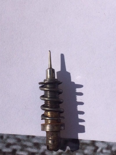

Melissa, if that's your new idle mixture screw on the right in the above photo, then I think it's point is also damaged, it should be a lot sharper and longer.
Here is a photo of mine
Here's a photo that MarioZg took of his broken one next to a new one
it does look smaller than that, you're right. what carb is that from ? mine is a V05 074A no vacuum adv. I also have a V05 074B which has a vacuum adv, think it's for a gtl, not sure tho.

The mixture screws are not compatible. I once tried to swop them around for my MOT but it didn't fit.

they made so many different ones! I've got 2 old carbs I got for 10 euros they both have the slightly smaller pointy version..both V0574A
