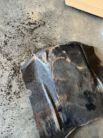

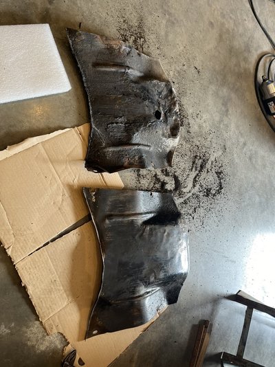

Don’t know how R4 people in Sweden are driving but all my R4 under engine pan seems to hit something hard at least one time during its lifetime.
Just grab tools needed for the job. The white plastic material works a bit like a sandbag (to make shape with the mallets) others for bending and smoothing out. Half an hours work and the shape seems to fit car again. Look in my Renault bolt jars I find spares to screw into the bottom of engine compartment.

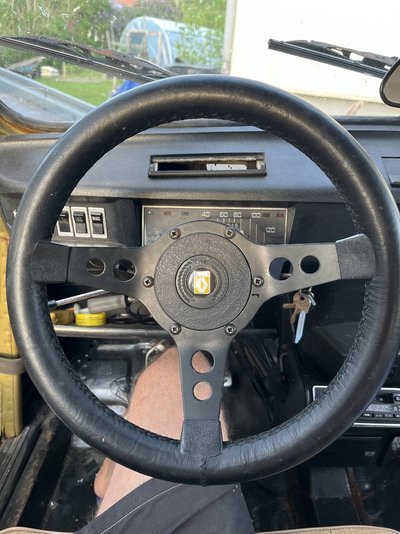

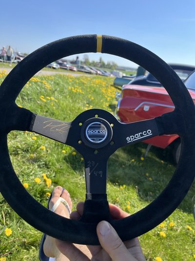

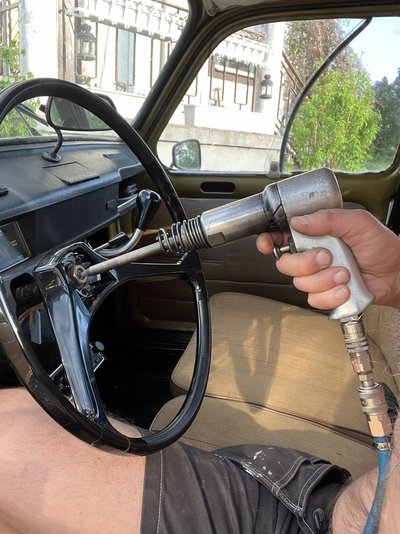

Bought a cool steering wheel the other day at the swap meet, made me thinking about replace my original that is cracked on three spots.
Directly out on the inter web and search for steering wheel hub to R4. Got a lot of hits here in Sweden and elsewhere but everything was for the face lifted R4, nothing for the early cars.
This forum has tremendous knowledge so I asked here https://www.renault4.co.uk/forum/threads/steering-wheel-hub.11992/
Directly response Big thanks!
Hmmmmm didn't I buy a Renault steering wheel for my R8 that didn't fit? Have to climb and check my random steering wheels and dito Renault. Found a really dirty original crack free wheel, a propably R12 and three random. One of the random I'm almost sure was for BMW 2002. Now I have some options to test but first of all I need to remove the original. Undo the centre cap, remove the nut with the 22mm spanner then use my favourite tool the air chisel. Pull the wheel towards me with one hand, and make one brurrrrt with the chisel, it comes lose directly (since last I praised the air chisel it have been upgraded to an old high quality I&R).
R12 didn't fit, the crack free fits so I clean it. Looks nice but still big and heavy, there were two left to test one was way to small the other on fits What? Yes, Yes. The hub is a Astrali from 1978, steering wheel have nothing engraved but it fits.

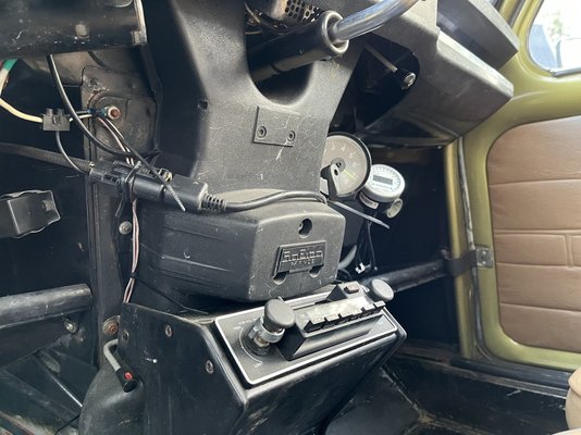

My plan was to fit the Sparco I bought, but the Astrali hub have the big bolt pattern so plans alter again. In to the house again and clean hub and wheel.
Test fit again and it feels like it belongs there, didn't I have a Renault horn button also, just a placebo to cover the nut.
Test drive says it's a keeper.

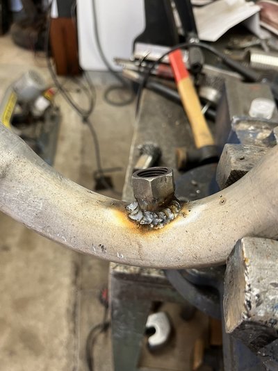

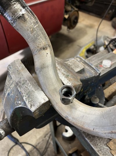

Have an Inovative MTX-L lambda meter since a while and I bought some turbo stuff to another car the other day it seemed proper to start It up and the Green One can be the guinea pig.
Lambda bungs I do some when I need so I have in stock. The ugliest was an old big wheel nut bored out and threaded M18x1,5 had to weld on a piece of pipe so the sensor just barely enters the exhaust pipe. Drilling a 17mm hole in the exhaust and weld all together. The sensor will be in a slight angle so moist don't get stuck in the sensor. Remount the pipe on the car.
Wiring is straight forward.
Red wire needs switched 12V fused 5 amp.
Black wire earth
White and yellow not needed so they just got some electric tape in the open end.
Sensor wire connects to an extension cable which connects to the meter.
Meter housing I just tie to the rew counter, final check that all tools are out of the way, connect my 12V thief on the fuse box where it's switched when ignition is on. Turn the ignition and yes meter informs that sond is heating. Start the engine and now lambda values comes on display. Some test driving gives me facts that car is on the fat side everywhere except on tickover. Lambda is between 11,5-13,5 that's really fat for a naturally asperated engine and okey for a turbo engine under load. Soot in the exhaust have indicated that it's rich so does fuel consumption, spark plugs looked great when I checked before but with the lambda I don't need to guess.

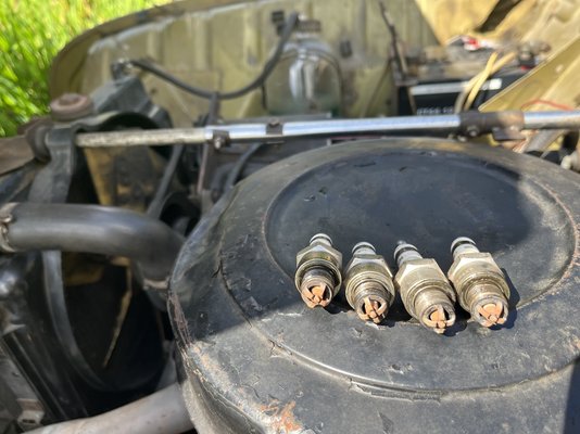

Way home we drove 35km 115-130km/h at lambda 14.7-15.2 so I can check spark plugs for what’s happening inside combustion chambers.
After working long shifts in the weekend I took a look this morning. They look great all have even golden tone. Water and oil levels are spot on. Consumes no oil but have a bit to much breathing from engine (maybe ok but I am not used a steady stream from breather pipe).
