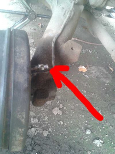

it look bad but its mine! (restoration process)
my mechanics help me to remove air in the break!
Great story, I love the colour of your car.
Here in the UK we just change the whole slave cylinder when they are leaking like that as it's normally down to lots of rust ruining the sleeve allowing the brake fluid to get past the seal on the piston in the slave cylinder, the rubber covers on the ends are only to prevent dust and dirt contaminating the piston as it comes out of the cylinder.
I hope your mechanic sorted out the leak and didn't just change the rubber covers!
There's a diagram showing a basic type of slave cylinder.
Hi pepper, thnx for your knowledge, i wish one day to change all slave cylinder they are already old enuf to be changed! my mechanics solve all the problem of leak! now l enjoy my ride :p

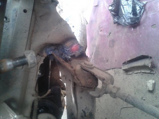

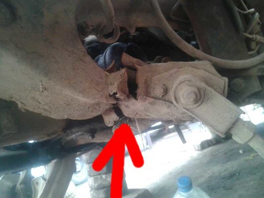

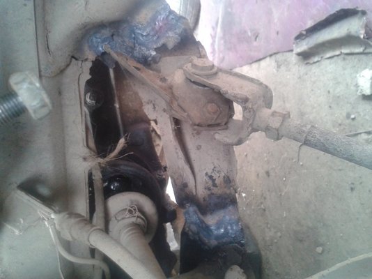

It was holiday of eid mubarak, l decided to go to local garage to repair my chasis, it have been melted with rust! no one have been take a good care of this car

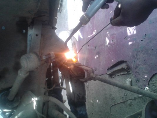

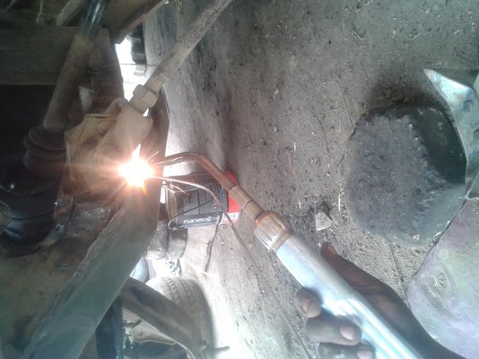

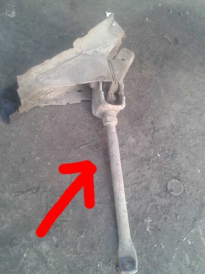

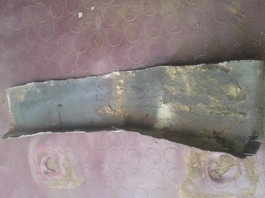

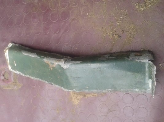

mechanics start to replace this part by welding it (is it stablizer or what? dnt know its name) to its place!

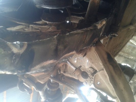

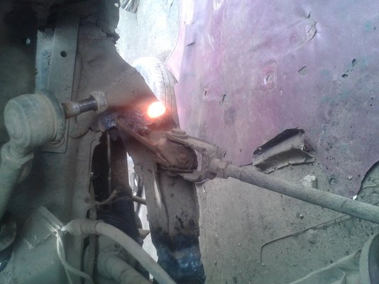

mechanics use iron sheet gauge 28 to reinforcement chasis......

That iron sheet we replace it to the chasis and start to welding it.

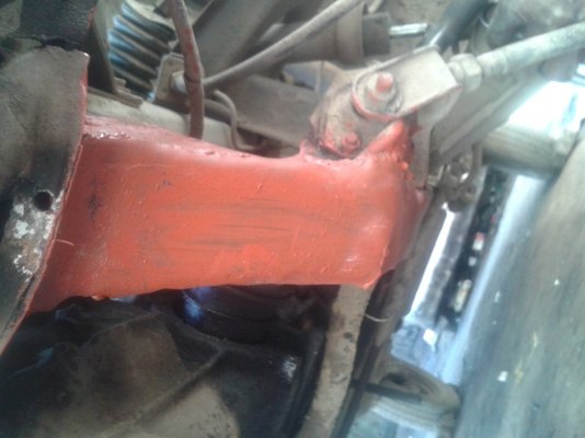

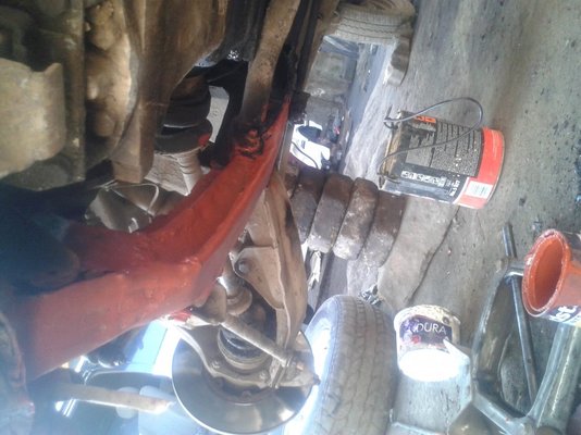

l finish my project by went to buy red oxide to prevent rust.
l start to paint that chasis

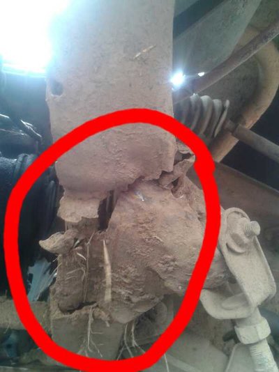

It must got hit with road rock there. Or fell into some hole.
Brake is to big to be only from rust.
Yes Petak i admit it, l drive one night in rough road. l fell into hole, after reach home l notice there is a problem in my chasis

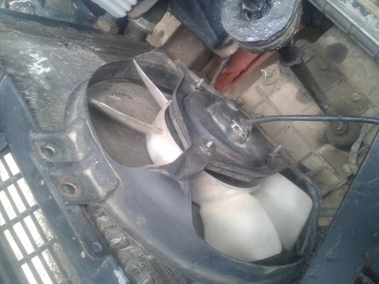

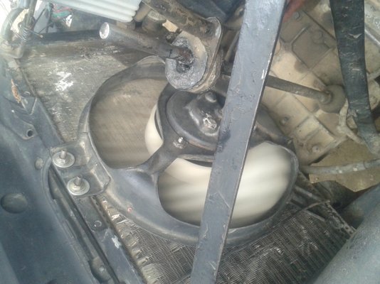

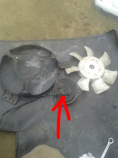

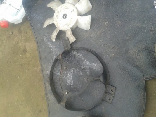

Early in the morning l take my R4 to the market to sell my vegetables.. when l come back from market l notices my fan of radiator is not working....

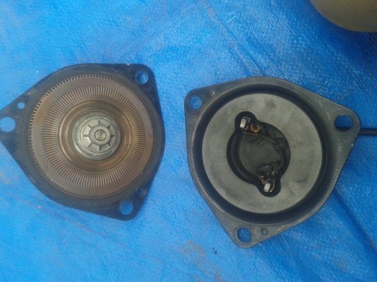

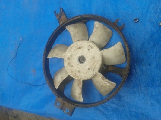

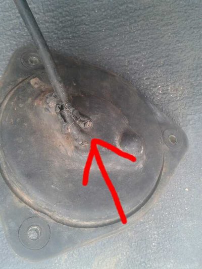

when l reach home l start to open fan and found that the wire was disconnected.
The arrow show the wire that disconnected that make fan not working.
Take a look.......

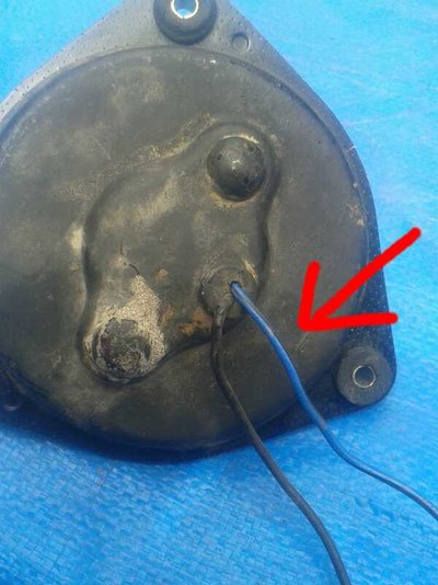

l went to friend of mine he is electrical mechanics and help me to solder it..
The pic with arrow show the relapcement of new wire,
l start to reassemble all parts so that l can fix it with radiator
