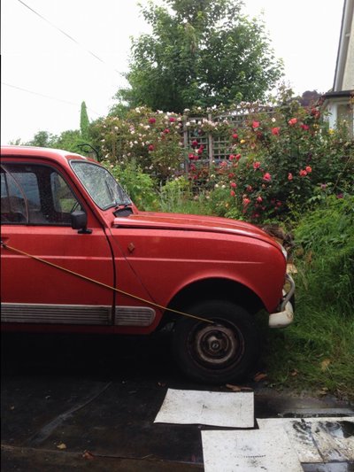

In between rain showers and even hail, I finally got the car serviced.

Hold on that's a pic well done and not duplicates
From iPhone or pc did you send this
Did you get discs and pads yet ?
iPhone. I have seen a set of discs and pads about £40 on eBay. I guess these will be OK? Taxed her last night. Seem to be sending rather a lot at the moment.
Is your car really that height at front or one (any wheel) is lying in some hole?
Low res iPhone pic makes it hard to spot trolley jack

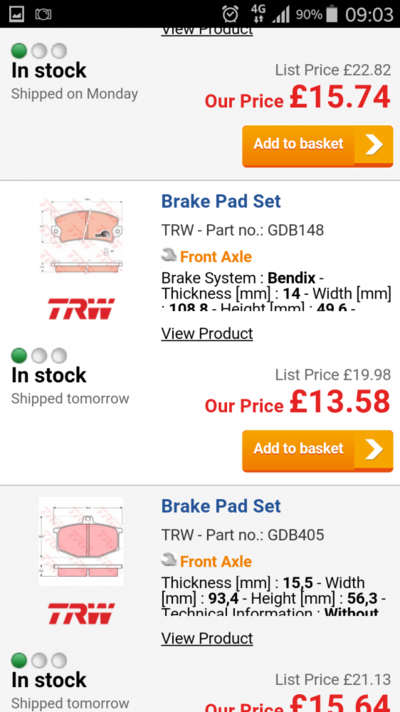

Remember pads are bendix type and I spotted a pair of discs for 9.95 recently as need some for a friend's project
No, although I had just lowered it down from the trolley jack so maybe the suspension needed to settle a little. Also the ground slopes slightly toward the workshop doors. I've just been out there and measured the car. From the top of the wheel arch to the centre of the wheel cap is 420mm and on the nearside 400mm, but as I say, I need to drive the car onto level ground to measure it properly.

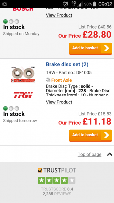

I checked with other images taken at the same time. I had taken the trolley jack away by then. Where did you find the discs & pads so cheaply?
Mr auto is your friend for normal stuff most service items cheaper than ebay and good brand names
Need 35 pounds order for free postage I think
Thanks for that Paul. I ordered my service stuff from Mr Auto and, as you say, they were cheap and prompt. Where does the 'Bendix' come in? Is that the shape or the manufacturer?
