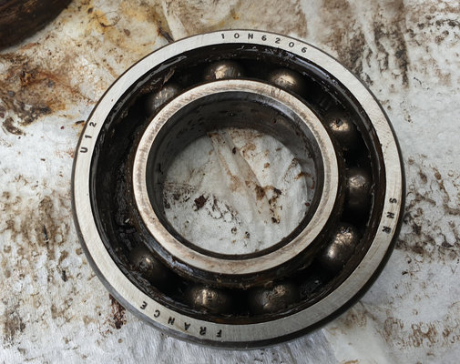

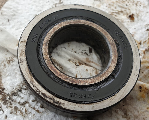

It's common to use plastic cages on low noise spec bearings. Certainly not suitable for wheel bearing application, though. I have seen them on gearbox input shafts on many modern cars, where it's very common to fail in exactly the same way as yours.
