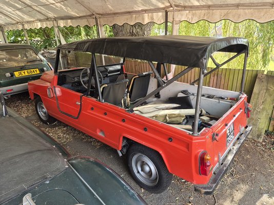

Fitted a new fuel pump at the weekend. I was having to crank the engine for a long time to get fuel to the float chamber but the new one has improved that. They don't give you much space for a spanner. After trying all my special shape spanners I ended up using a small ratchet and socket with the handle below the fuel pump and that worked. The main jet blocked up again, probably rust from the old tank that was still in the fuel lines. Float chamber cleared again.
But the exciting thing is I drove to work and found the Rodeo will cruise at 95km/h (5km/h more than before) and I have a new record speed of 105km/h. The only thing I've done is change the air filter housing to a GTL type because the old one was only held by 1 stud which fatigued and broke. I think the old air filter housing might have been restrictive.
