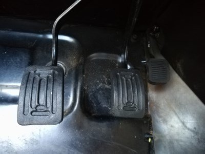

First put rubbers on pedals. It is much less slippery now :D

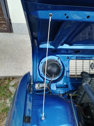

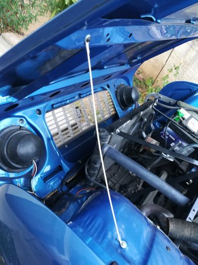

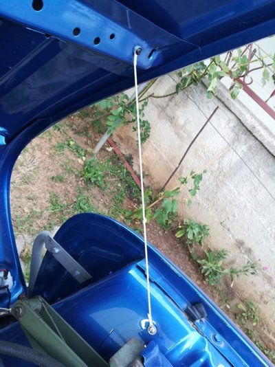

After that i finnaly "tide up" hood/bonnet to inner wings.
Used tin rope instead of cable

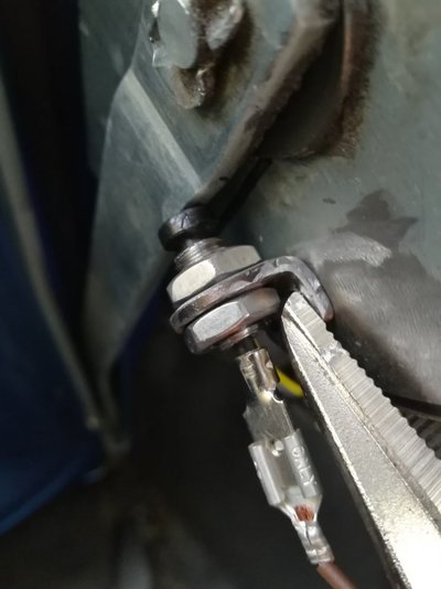

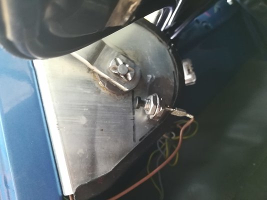

And chose another location for booth light switch.
Also not best solution but will see how things will go on. I am affraid it will be accidentally pulled out
But, off-course, some modifications where necessary.

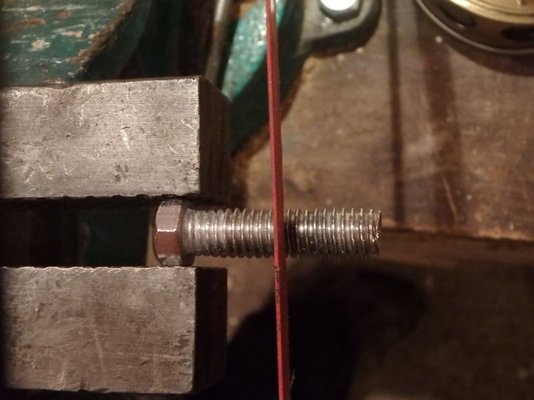

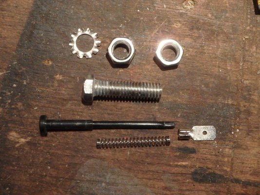

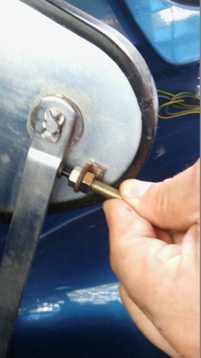

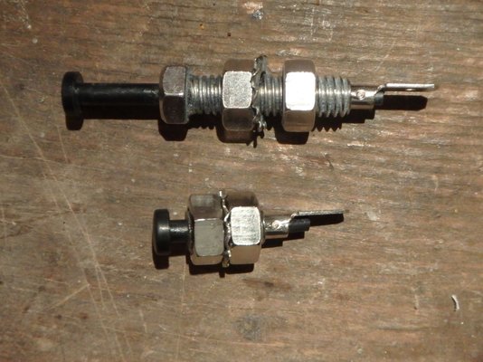

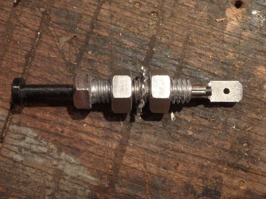

Switch was to long and i wanted to shorten it to minimize possibility for ripping it out.
Operation started
Cutting

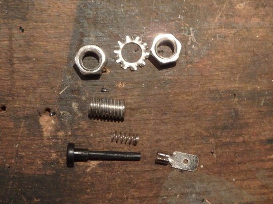

What is left out of switch
Comparison (normal switch VS shorten one)

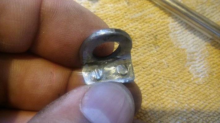

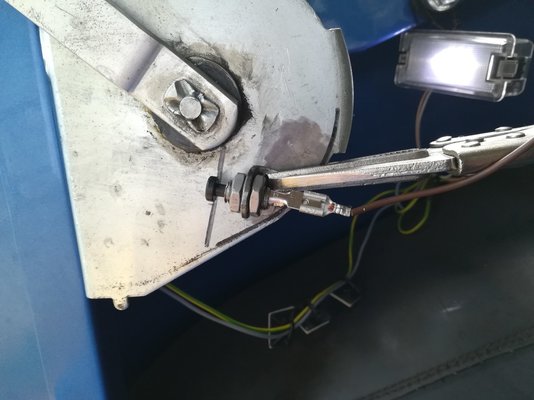

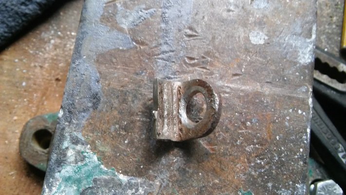

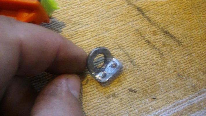

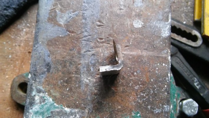

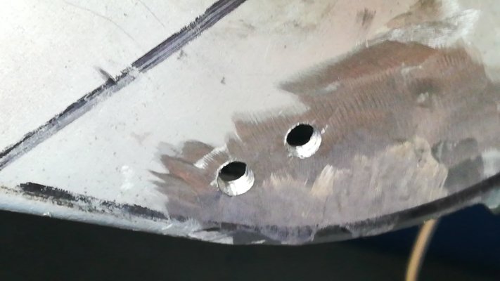

Made small bracket for it
First weld bracket to whole booth door holder mechanism but that did not go well.
I could not mount holder to the car because you need to wind holder spring by turning hand, and you can not turn hand because there is new bracket welded to the holder ( i hope someone will understand what i wanted to write :o)

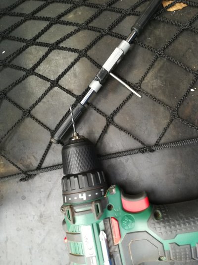

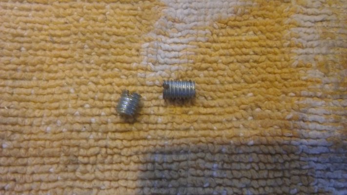

So i decided to make threads.
And small headless screws
screws in place
Together with switch

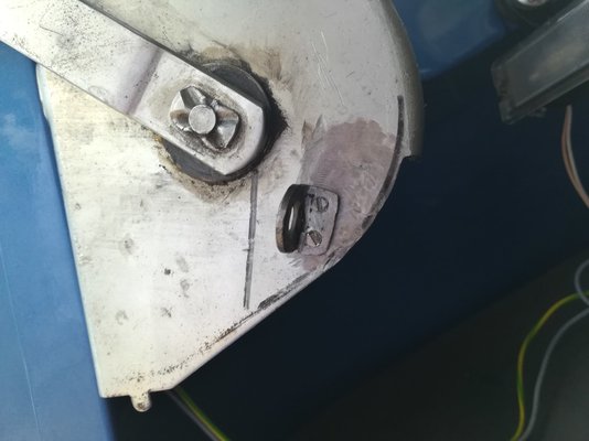

Positioning, checking clearance and functionality
Marking twice - cutting once
Tool for the job
Holes and threads

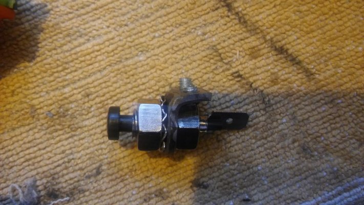

Bracket screwed to it's place
Working position.
It is working nice and i still did not catch it and it has been 2 months now.

Great work, love the boot light switch. Id have done it with a weighted one on the boot lid myself, out of the way more. :)
How did you positioned it Pepper?
Actually switch it self does not bother much but wiring need to be tucked so it does not hang freely.

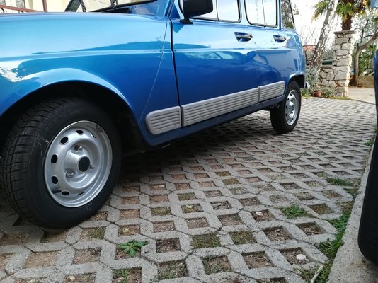

Temperatures are heading down to the 0°C and it is time for winter tires and clean original look for my R4.
Aldo there is no snow (and it is big assumption snow will not fall this year) temperatures are below 4-5°C in the morning and after sun goes down.
I am not "feeling safe" with my summer tires in that condition (especially if there is rain and bura-cold north wind) so i have put winter tires on.
One picture (pure and clean R4 GTL look)

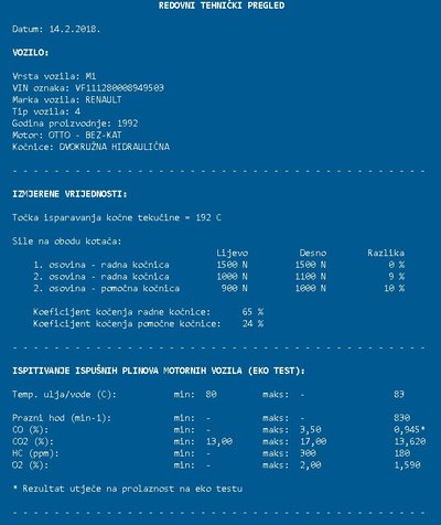

Also past my third MOT in the row without any remarks.
Brakes are same as first year. exhaust close to 1% CO.
Got tip that at 1%CO engine is running best and with lowest consumption possible.

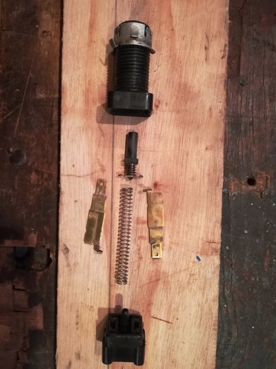

Had some issues with brake light switch. It did not work every time i press brake.
Take switch apart, cleaned contacts and put it back together.
Now it is working flawless

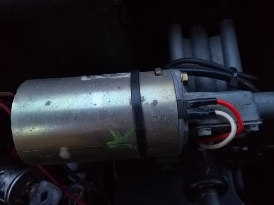

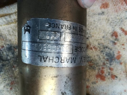

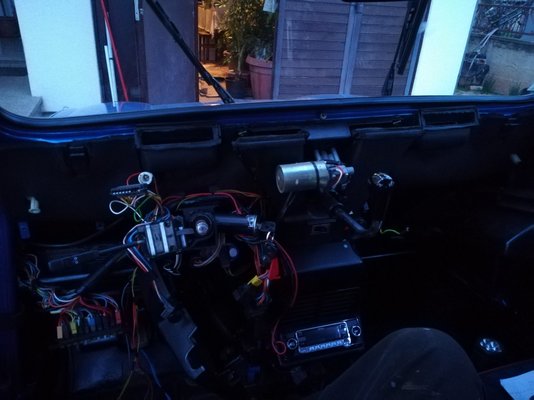

And my wiper motor stopped to work.
So i had to remove dashboard and change wiper motor
Valeo one
With sev marshal

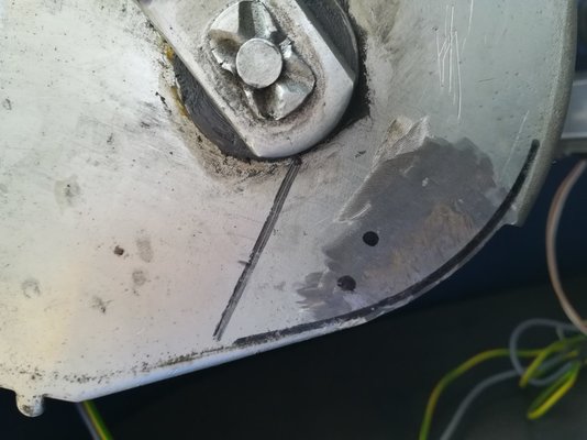

But now i have some issues with wipers. Wipers do not stop at the beginning (or end) of travel when i turn them of.
Before i have changed motor they did.
So now, when i put wipers on they start to go 10°in one direction and then to other direction.
I am not sure if problem is in wiper motor or i have just connected linkage and motor in some wrong way.
