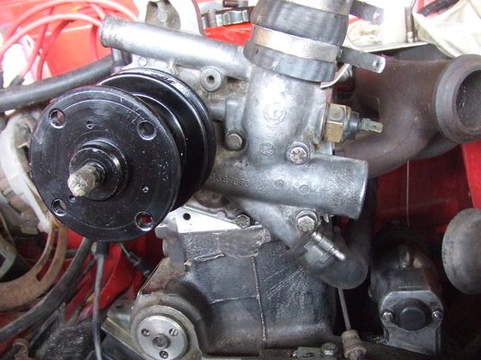

My water pump went on yesterday with a new gasket. Cleaned it thoroughly and painted the pulley.

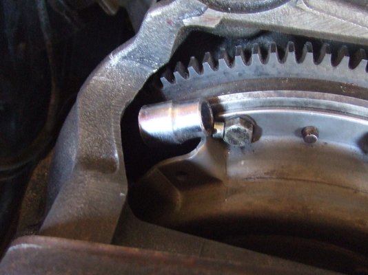

After tightening the last bolt, the socket fell down into the narrow space at the flywheel. :doh:
It took me 4 hours before I managed to get it out. I tried compressed air, vacuum cleaner, pieces of wire etc . I tried from the top, bottom and from the side, but couldn't reach it. I was considering taking my whole engine out again when my little magnet came to the rescue.
I stuck it onto the flywheel and turned the flywheel by hand until the magnet got to the bottom and attracted the socket. :Dvery happy.
Great story and resourceful conclusion......When things like that happen its possible to get annoyed with yourself...especially as we are often trying to do the job around other domestic responsibilities or work etc. Well done a satisfying result :clapping:

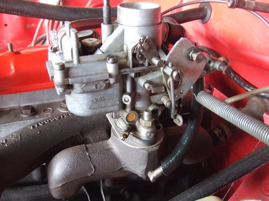

Carburetor was installed today, looking a lot better after a clean. I have never smelt anything worse than 15 year old petrol. !!!
I didn't open it up in case I damaged the gasket (no spare) so I just squirted some fresh petrol into the inlet, shook it around a little and then drained it out. I also removed the filter and rinsed it in clean petrol.DSCF6703.JPG
Think you should definitely buy a gasket set... after all the work you have done, it's a pity to bypass the simplest step...
Mr Reno, looks like I'm in the market for a gasket set if you have one. it's a 28 carb. Are their any other details you need? Like a serial number? I think its got VO5 printed on the side. Or does one size fit all 28"s.
I wouldn't mind replacing the filter as well as my one seemed a little fragile.If you need more details I can send them with photos
Many thanks !

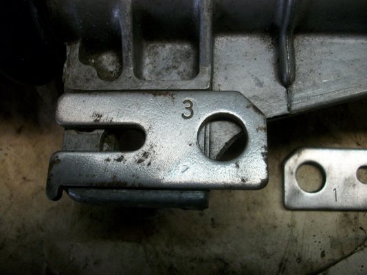

Last weekend I replaced the steering rack with the two spacers . When I first took the rack out, both spacers fell onto the floor and at the time I didn't realize that each one is numbered and has different dimensions.
I worked out which side they go as the back edges of the plate are sharp and the front edges have been nicely rounded.

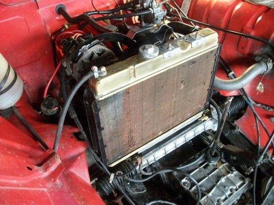

Put my fan on yesterday. It's made from nylon, strong and unbreakable, and cleaned up nicely.
Then came the radiator. It used to be painted black but I prefer the copper colour; it might take a bit of maintenance to keep it like that.
I don't know if you can find it over there, but Gibbs Brand is super for protecting exposed metal which isn't exposed to direct rain. It is an American product. I used it to cover a bare steel body for a few months and it was effective.
Thank you Malcolm, I Googled Gibbs Brand and thats exactly what I'm looking for. Somehow I doubt whether I'll find it here so I'll try and find something similar.
If all fails I'll try Azazello's suggestion. I suppose there's always "Brasso":)
clear lacquer may be sufficient, its often used on power transformers..though I am not sure of the temp rating..for this application I am sure it wouldn't hurt to try it...

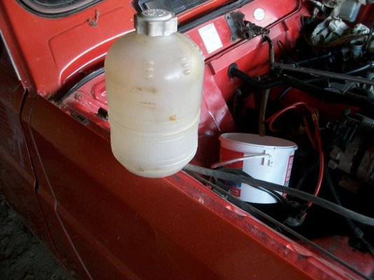

I filled the cooling system this past week. I opened the bleed screw and connected a tube to it so that any overflow could run into a bucket. Put the heater on the "hot" position and raised the expansion bottle and removed the radiator cap.
I could only get 5 liters in (including the expansion bottle) even with squeezing the rubber water pipes, The manual says that it should take 5,50 liters.
I haven't started the car yet so maybe that will help.

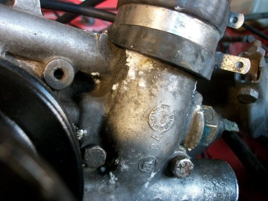

This photo looks like trouble, right?
I found a wet patch under my car this morning. At first I thought that it was leaking from the bottom of the water pump and then I noticed these white crystals around the bottom of the hoses. I presume its from the coolant?

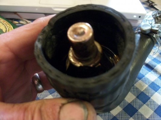

When I rebuilt my engine, I didn't remove the hose with the thermostat inside because it looked fine and I didn't want to disturb the seal. I should have done a more thorough job so I have only myself to blame. I haven't tested the thermostat because I can't get it out of the hose so I don't know if it works or not.
I'm going to order new hoses and a new thermostat and do a proper job. Der Franzose have 2 thermostats that I can choose from.
One of them opens at 75 C and the other at 89 C.
i think its better to have the 75 C . Any thoughts please?
