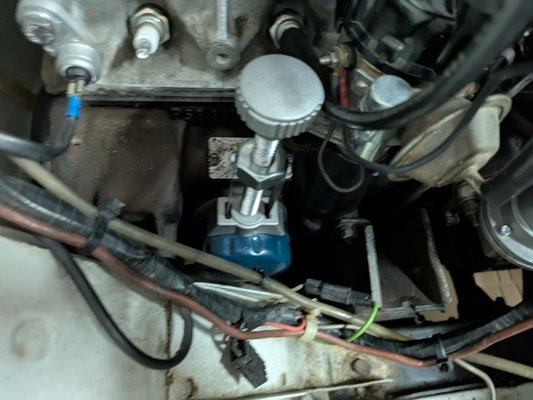

The carb heatshield helped a lot the hot start, the next move is change the fuelfilter location

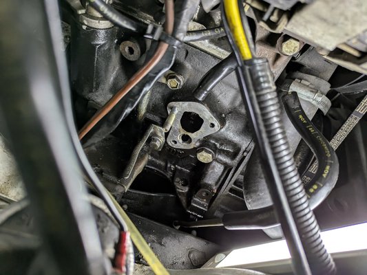

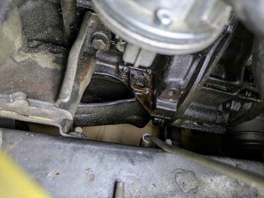

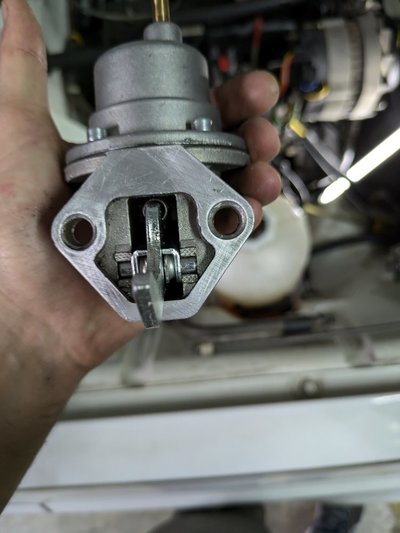

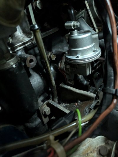

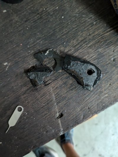

I notice a lot of oil on the garage floor. A huge oil leak from the fuel pump gasket, I changed it, fuel pump include on last April(6k Kms later).
The baquelite spacer(aftermarket) came out in pieces
I put again the original in steel.
I left this night the sealant cure..and tomorrow I will test it

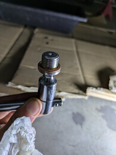

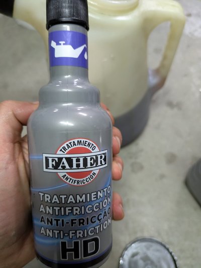

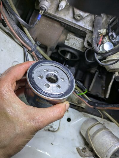

Usual oil and filters change..this time I put an Faher engine additive, I have good feedback on it. Check the ignition trimming, 6degrees and 60ºdweel angle(not the best I know). I changed the distributor cap, the old have bracket support broken.

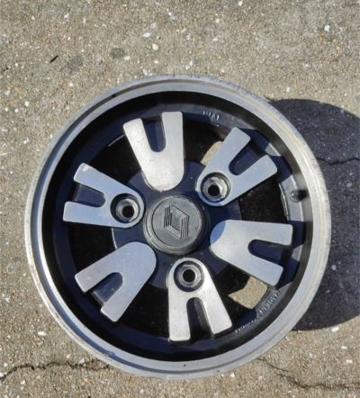

I already solved the trim fault.. I bought this set. Wating for B€tter time to change

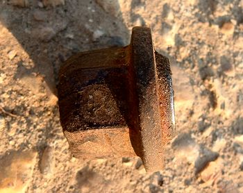

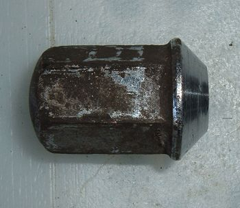

I've got a set of these on mine as well, make sure you get the right wheel bolts for the wheels
