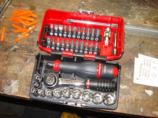

at the end of 2012 I decided to fit the second front wing to finish the job on the body of the car, I used for the firsttime my christmas present

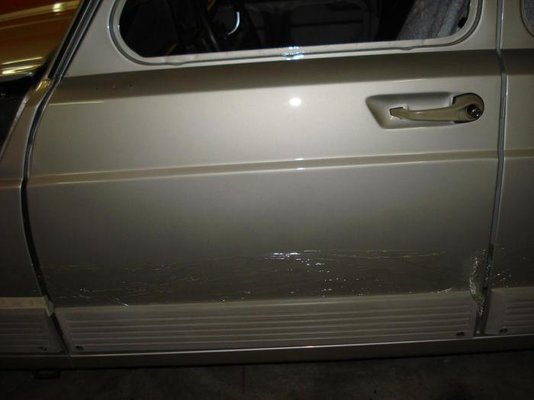

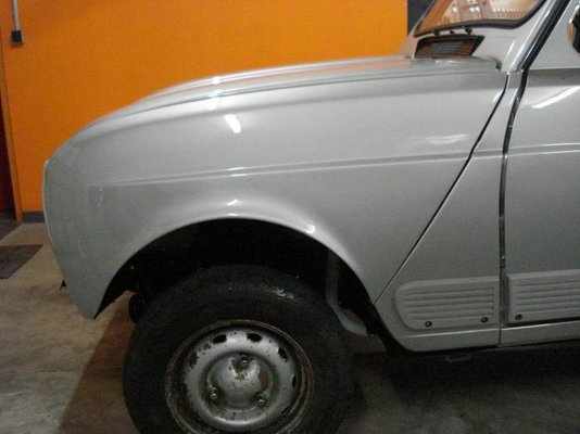

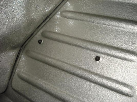

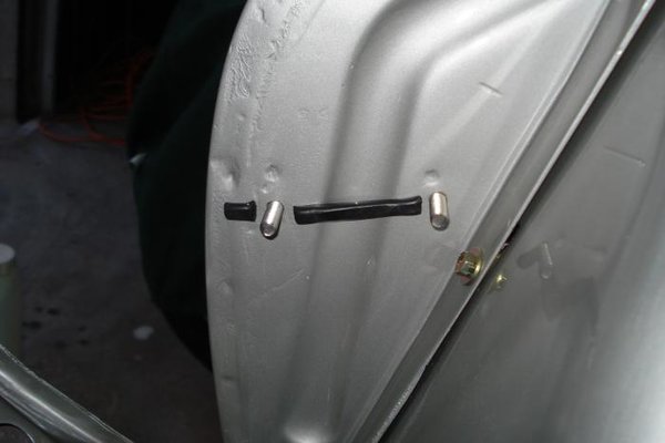

As you know I love the details, so I put sealant on the screw of the space-pocket at driver side:

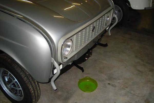

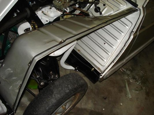

Then I used the same sealant for the left front wing:

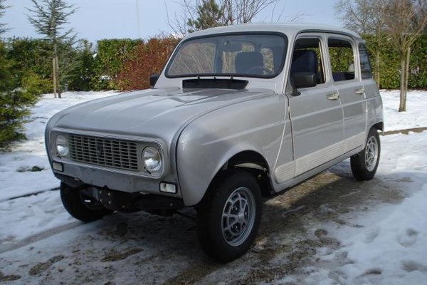

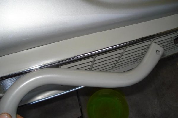

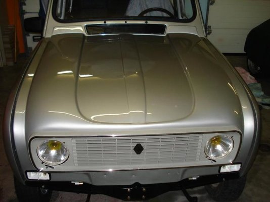

Center the hood with the 2 wings wasn't easy and the space between the differents parts seems to be larger than other R4s, but with the tubes at each side I hope this will be invisible...
Another "little" problem with the adjusting: the wing is "a little" too long compared with the triangle of the body
but I couldn't make it better.

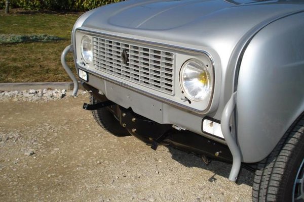

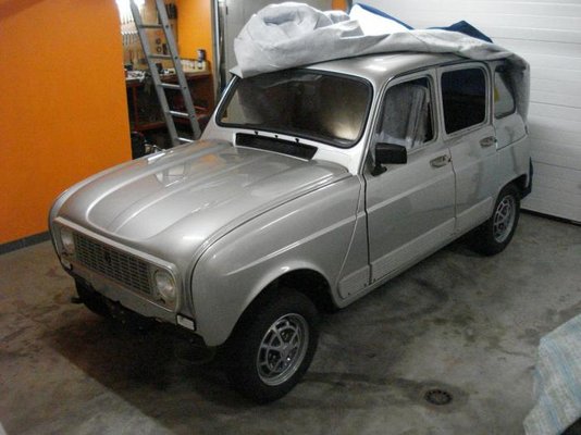

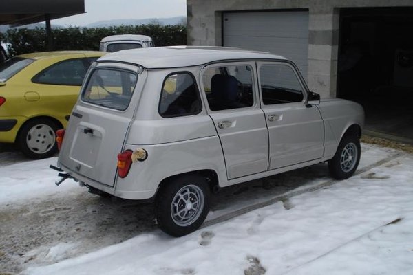

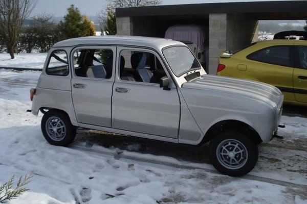

I took a picture of the car by climbing on the washing machine but inside, the color is not as shiny as it would be outside:

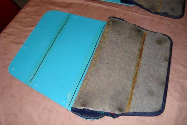

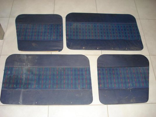

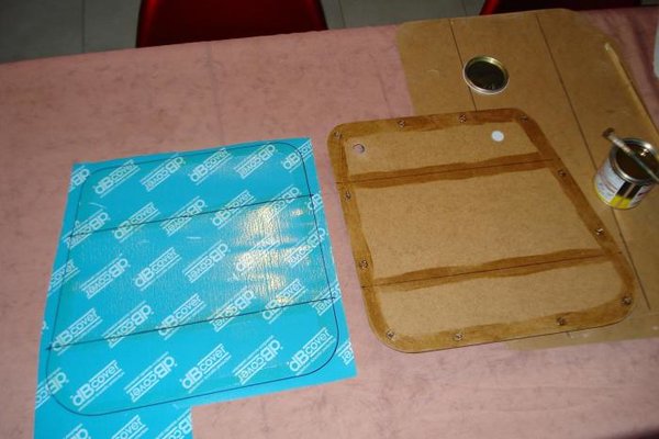

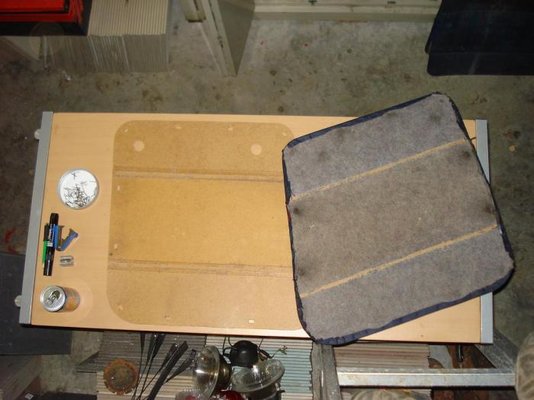

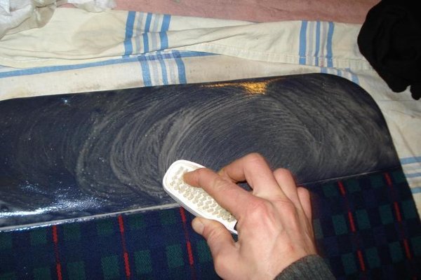

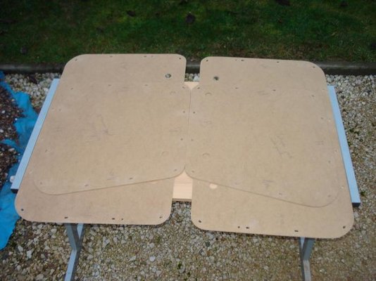

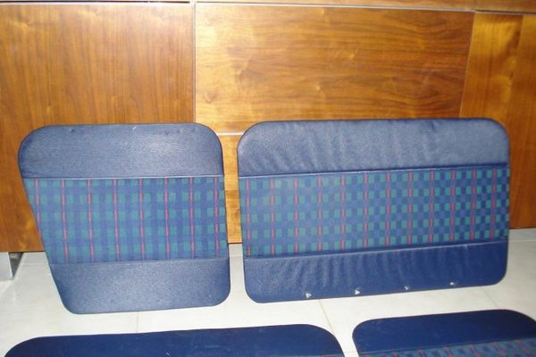

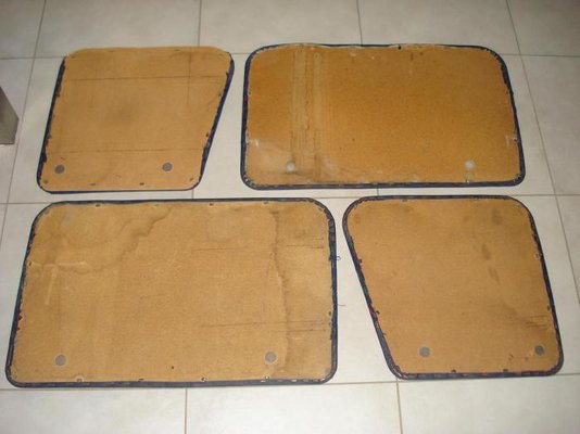

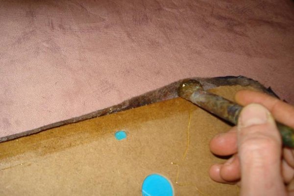

After finishing the body (only the bumpers are to be fitted) I worked on the wood doors which are damaged and dirty by the years:

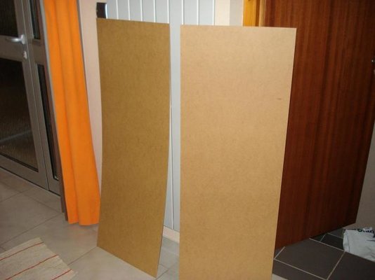

The plywood has been wet by the time and I want to remplace it, I bought new one...
