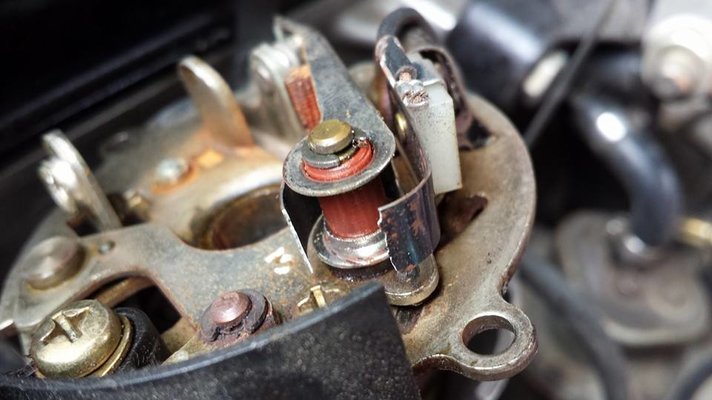

My father called me today, he was on the road and the car just stopped. I went to help him, I suspected that there was no fuel but soon we found that there is no spark. Removed the distributor cap and noticed that the points arm is loose. The points were broken. Towed him back home and replaced the points, this was my first. In almost 40 years of owning an R4 this never happened to us.
Points weren't made in China 40 years ago. The materials in after-market parts can be a bit variable. I had a lot of trouble with a rotor arm that conducted electricity to the distributor shaft when it got hot.
