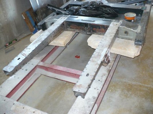

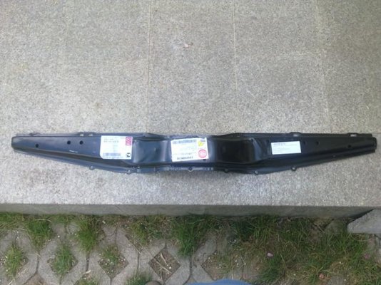

Thank you for positive encourage but chassis is little bit big step for me at this moment.

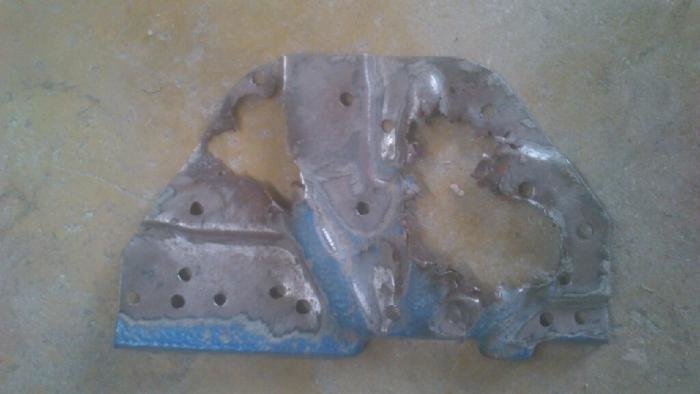

To be honest, i have already thought about this idea but there are some details on chassis that i do not know how to make.
For example front crossmembers (if they are cold like that) that are holding engine and gearbox are one big problem. I do not know how to make them to look like original one.
These two elements of chassis that i have made are most critical one, and there are very few R4 which have good/healthy this parts.

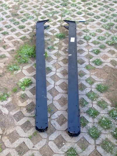

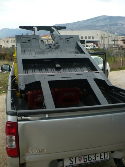

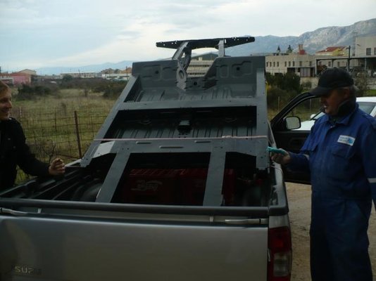

Went to see guy that is working on R4 chassis and body
Welding on chassis is finished. Rear crossmembers are in place
There is left to put sealant on all welds and joint of two plates, some antirust paint, than black chassis paint, wax in all holes on chassis and antistone paint (do not know is this right word for it) underneath the chassis.
And bring it home! :D

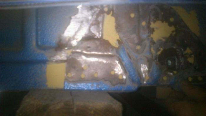

Have found one detail on body that need to be changed komplete.
Inner part of rear right wheel arch.
Now i need to look for replacement part from some other scraped R4 that has this part in better shape!
I have one R4 for parts but not 100% shure how is this part of body.

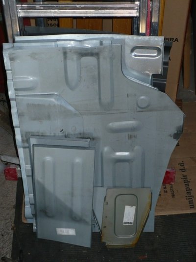

Beside side crossmembers and rear crossmembers I needed to change some floor panels and that is about it.
Is there something that you are especially interested?

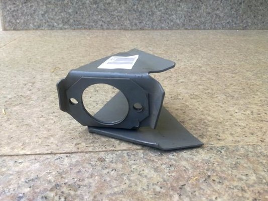

EDit: I have found pictures of parts that i have bouth for body work
Quick info.
Inner part of rear right wheel arch is not available from renault any more.
Scrap yard here i come:)

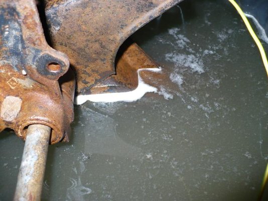

some parts- first cleaned with electrolysis, then brushed with steel wire, galvanised, and powdercoated

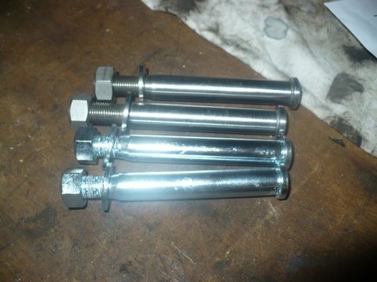

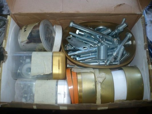

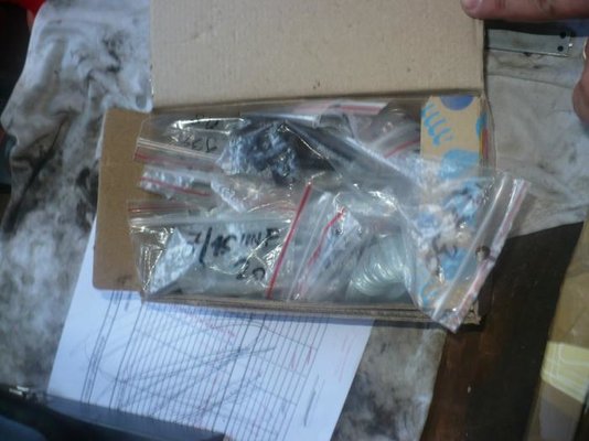

old bolts/nuts/washers -galvanized

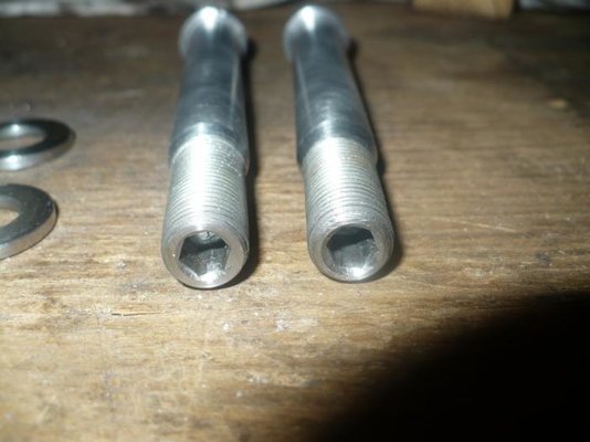

new bolts/nuts/washers

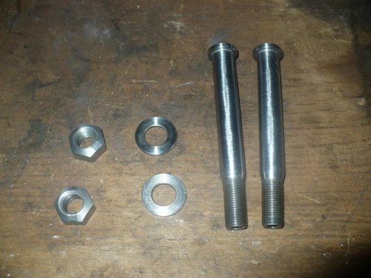

Do you know where this is going? :D
old galvanised and new one made out of stainless steel A4

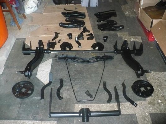

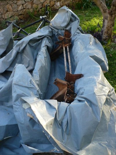

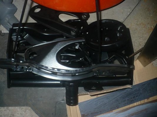

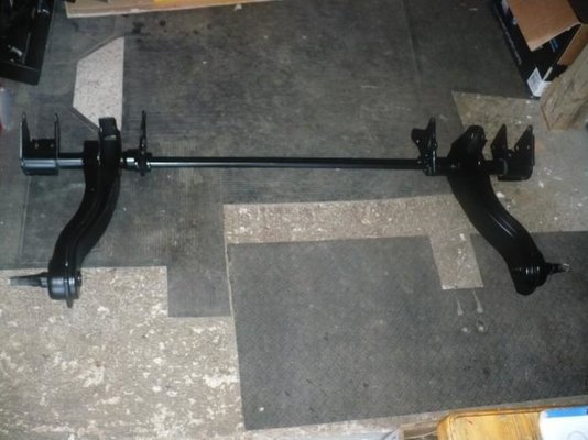

Also rear axle is finished and ready for mounting.

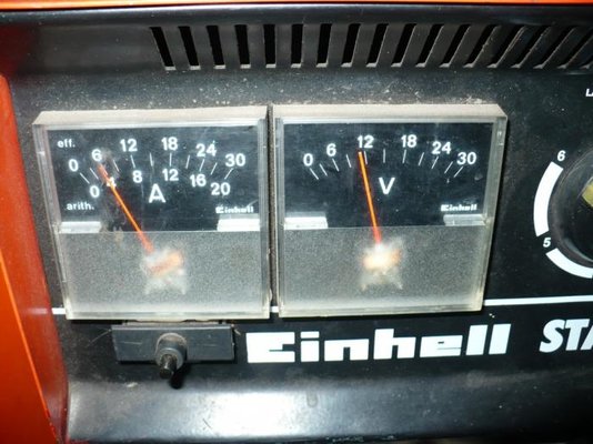

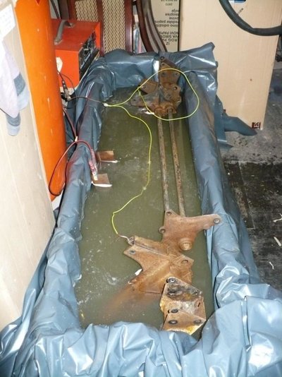

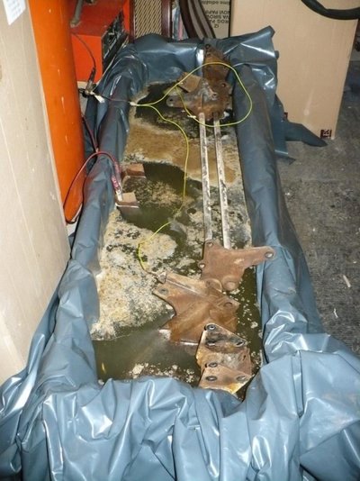

first old paint and rust cleand with little help of electrolysis
then cleand with steel wire brush,
one coat of primer
one coat of mat-black paint
