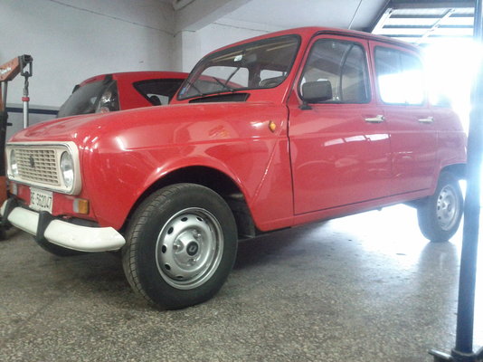

This is what Ermintrude looked like with factory ride heights.
This is more like all R4s i remember.

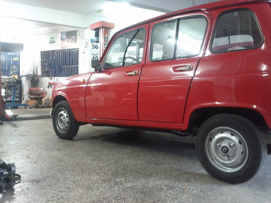

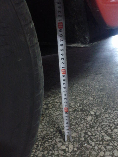

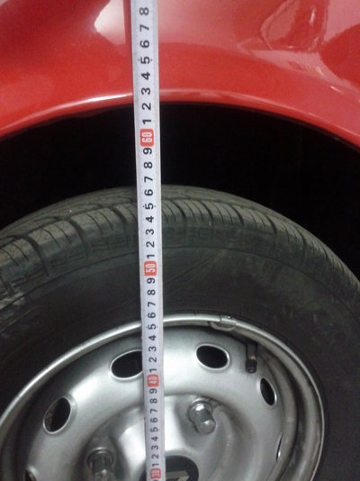

Here you are. Ride height has been set 20mm lower than factory figure. H2 is 195mm and all other measurements seem to be pretty much like yours before lowering the front end.
TX Jjdew....i know about this figures but i could not understand that front end is so high at wheel arch if you set H2-H1 to 41mm
Malcolm....Ermintrude was very low according to numbers
Angel...thank you for discussion, pictures and measurements....I appreciate it.....Yor car was low as Ermintrude....Now it looks more like it should be.
And even now it is lower than it should be as factory meant
Mine is slightly lower.
Even rear end is about same height as mine
So i can conclude that cars are sagging over time. And that everything is fine with my car . It is just matter of preferences. Or should i say As one likes.

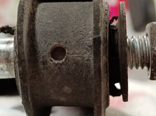

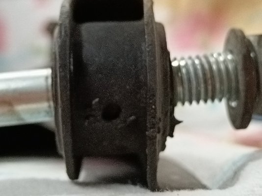

Front suspension rubber bushes need changing again.

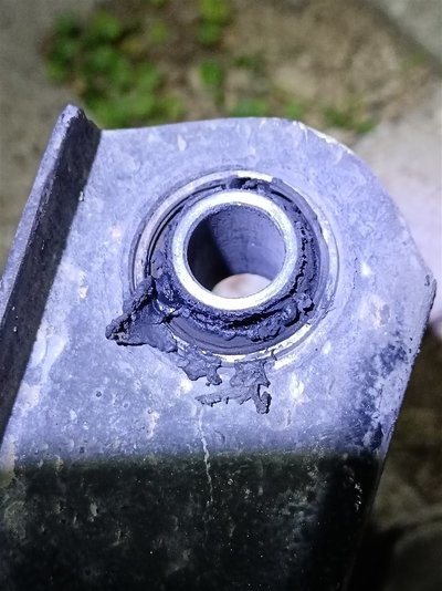

And rear outer mounting rubber bushes are gone and need to change them.

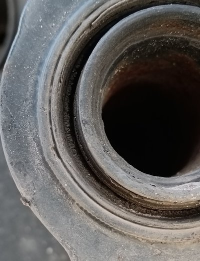

You can see crack i rubber.

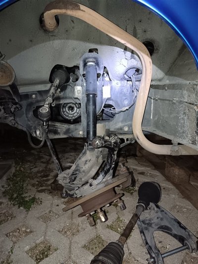

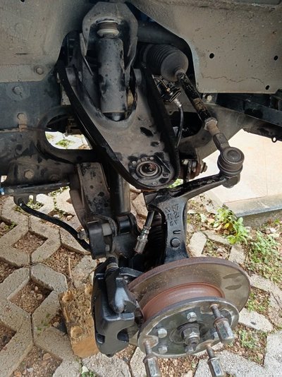

After long planing and few time postponing finally get my blue one in "box" for some service
Luckily i have good friend BorgeB who unselfishly lend me his car to use while i do work on mine

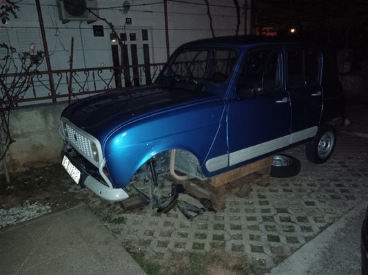

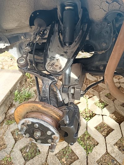

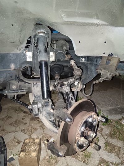

Then i got mine into air. Secure it not to fall down while i work on it
And took both sides apart,
and took off upper wishbone as rubber bushes are gone

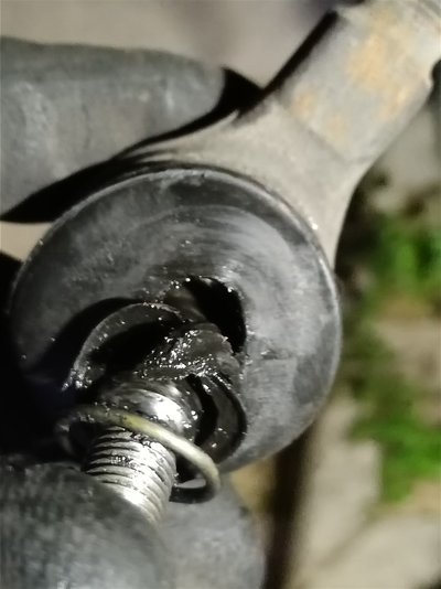

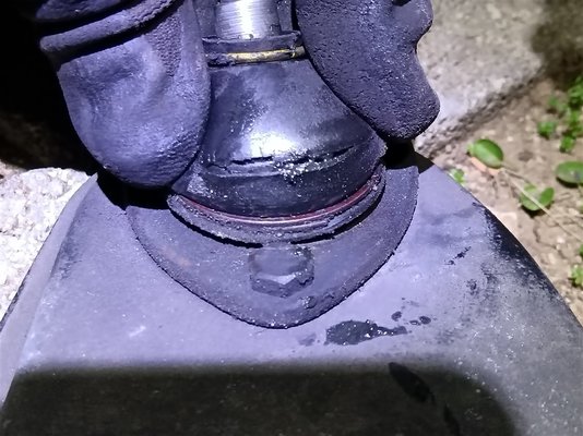

Doing it i have found few ball joint dust rubber damaged. Will change only dust rubber with some i bought from aliexpress. Do you change only dust rubbers or you change whole ball joint? Where you get dust rubbers from if you do?

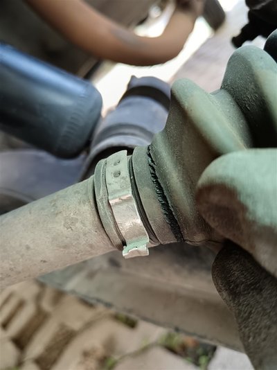

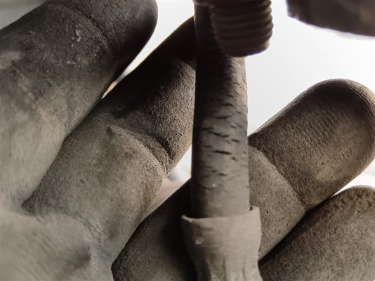

Also one outer driveshaft rubber bellow started do tear apart. Change it now or leave it as it is while it last?
Disk have small edge but edge is same on both sides and it is not to big. Tomorrow will measure disk thickness but i believe it will be good to keep it.
Break pads have some 7-8mm left. So i think they are also good to go.
Flexible brake lines are definitely for change
And not sure for calipers.
How can i test if calipers are working good now that they are taken of?

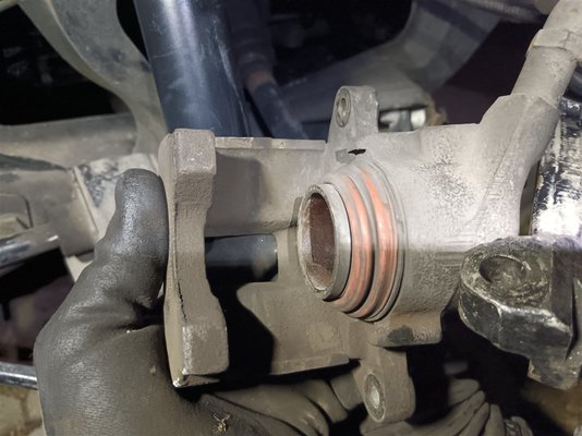

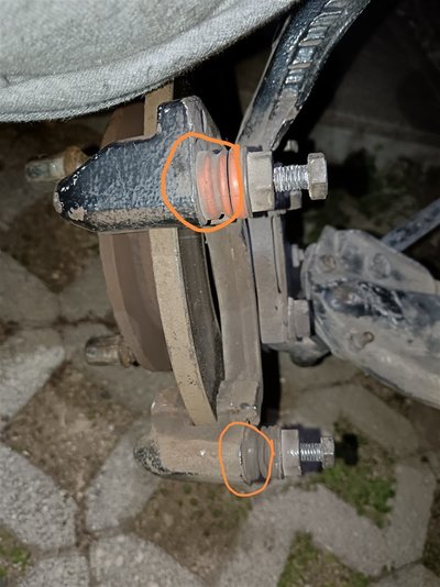

And noticed some play in sliders.
They are very easily moved in and out
Is that play and easy movement normal, desireable or should not be?

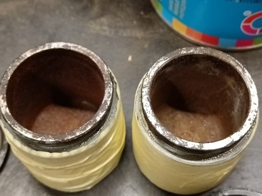

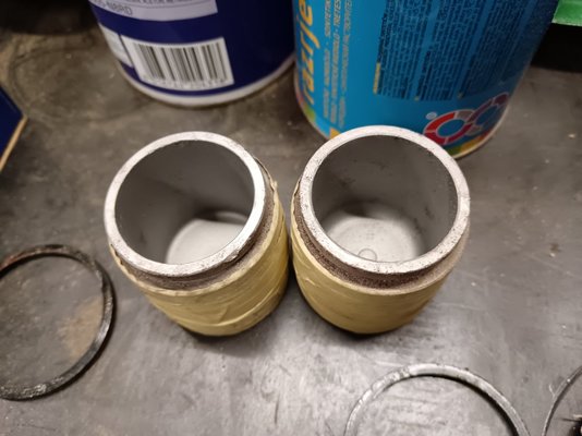

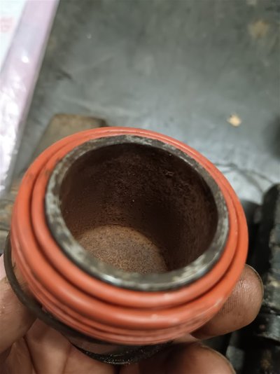

I have two other calipers, which i plan to sandblast and paint. But little bit afraid of sandblasting not to have problem with sand inside the calipers once i paint them i put back together

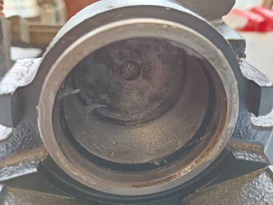

caliper pistons are rusted from inside
CAn somebody advice what grease to use when put back piston?

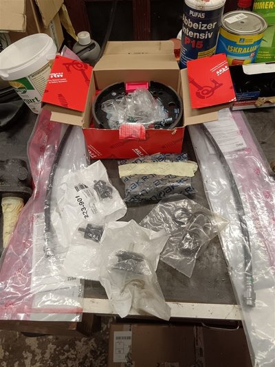

Parts are ready. still waiting hand brake cables to arrive. But it is not necessary to have them now as rear end is still some time away.

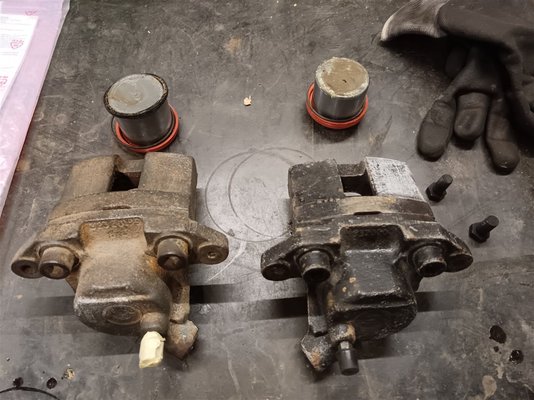

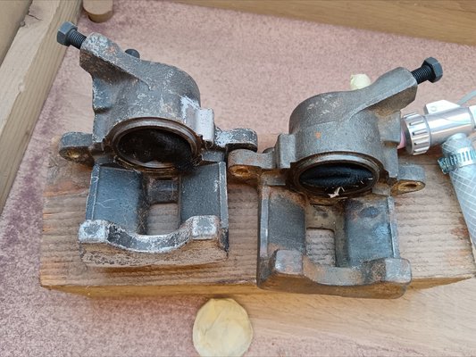

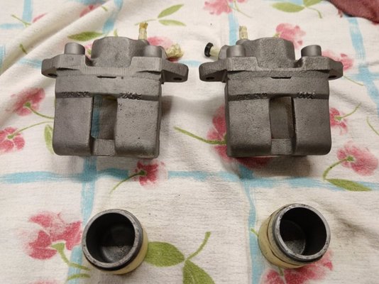

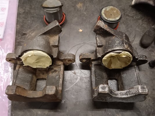

Yesterday, tried new sandblasting gun and use it on calipers.
Calipers before treatment

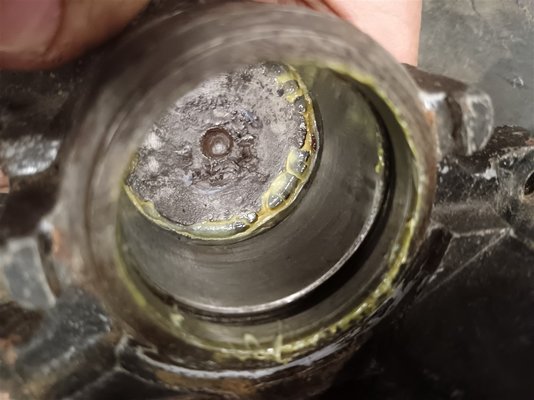

pistons from inside
After
Is there easy way to preserve calipers from rust beside painting.
They look so nice freshly sandblasted, and would like to preserve them like this.
Disk brakes are at 9,4mm (10mm is new disk, 9mm is minimum thickness allowed)
Pads are at 7,5-8mm (new are 15,5mm, minimum thickness is not defined)

TX Jdew for suggestion, but that all takes time and i am little bit in a hurry this time, for this pair of calipers. Maybe other two pairs that i have spare could powdercoat.

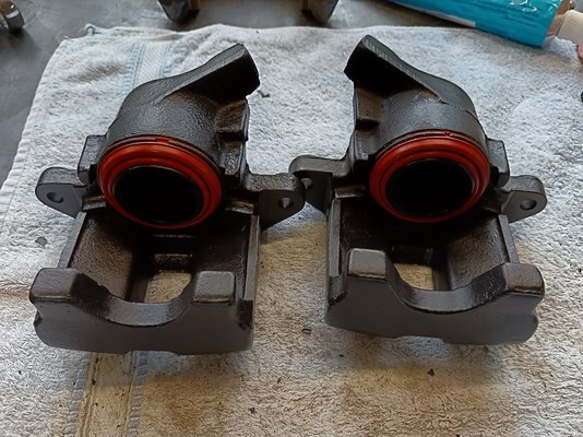

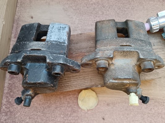

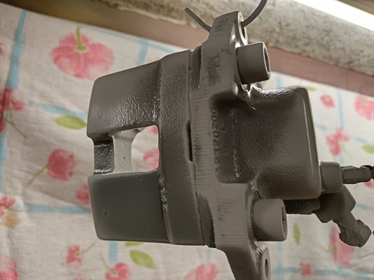

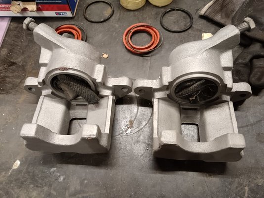

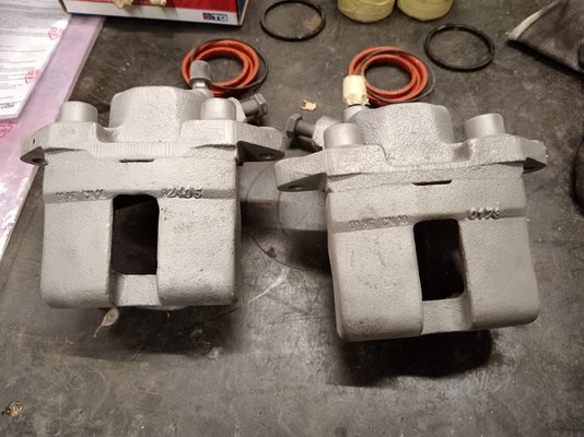

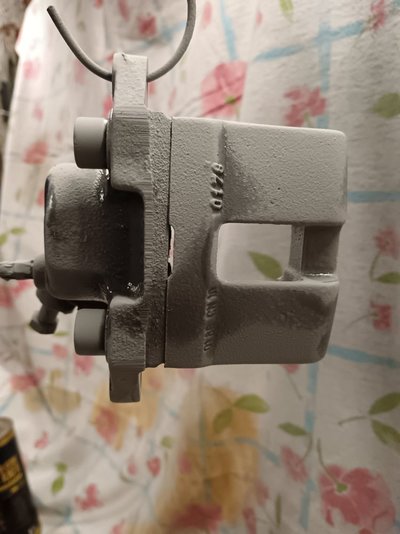

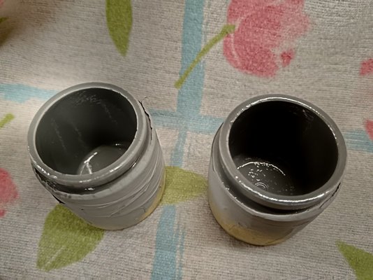

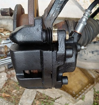

Today managed to find some time to deal with calipers.
Cleaned them and prepared for zink painting
And put one layer of zink paint
And tomorrow two coats of high temp black paint.

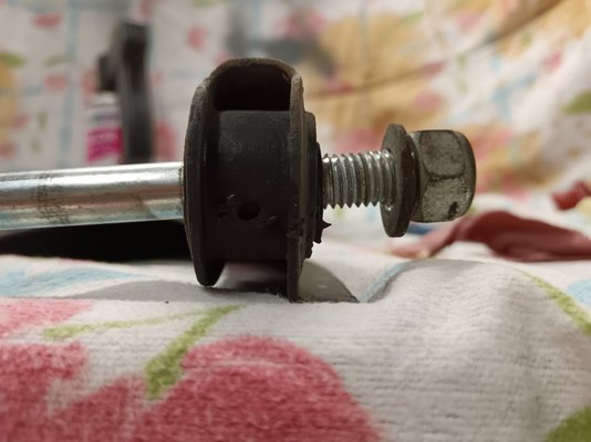

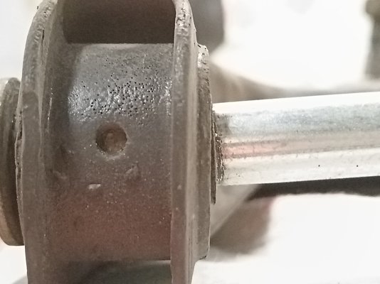

Beside that i checked wishbones.
One is bended little bit

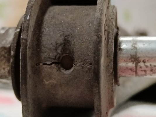

And the other has crack in rubber bush sleeves
This one will go back on car so i can be movable, and two new reinforced ones (with ball join and rubber sleeves) are already ordered
I've tried replacing the rubber cover in the past. The modern balljoints aren't designed to accept new rubber covers and the quality of cheap rubber is terrible and it only lasts for one year. Better replace the balljoints.
For the driveshafts often the replacement boots are 'universal' and fit poorly. Something from one of the classic Renault suppliers would be better. It's nice to replace bad rubber parts while the car is apart but see the other thread about driveshaft boots.

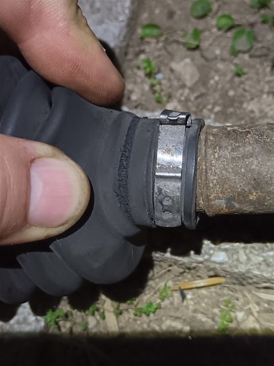

For outer driveshaft joint i use BERNER silicone universal boot that you cut to length. It fits alright and clamps are low enough to pass lower arm.

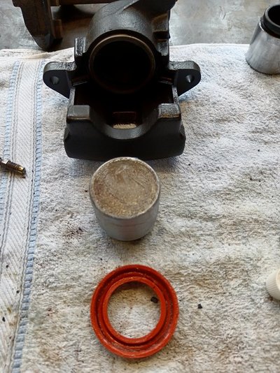

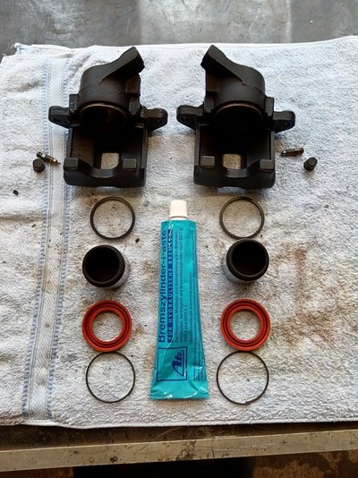

Today managed to renew calipers
Preparation for instalation
Inner seal fit in place
Some caliper grease on piston and boot
Putting back together was easy once you learn that it is smart thing to put boot on piston before fitting in caliper

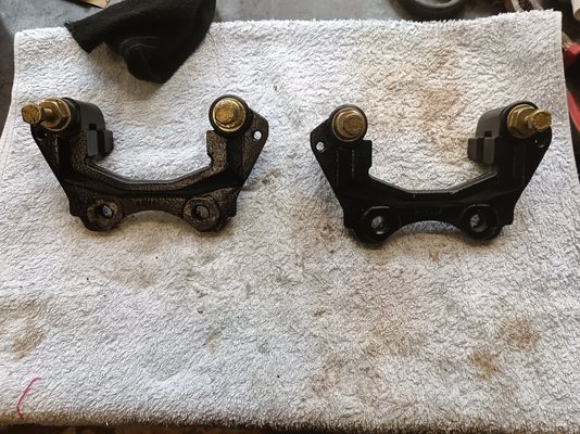

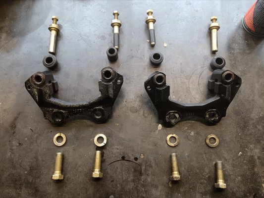

Caliper bracket explode view
Used same grease for guiding pins

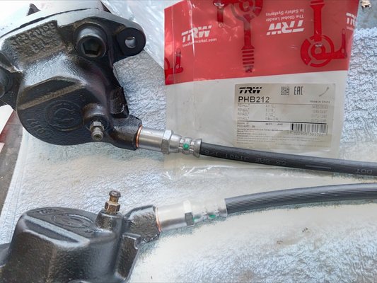

New flexible hoses with new copper washer. It seems taht flexible hose could be 2 cm longer but they are same length as original so i do not worry. Believe it will be better once car is back on wheels.
Left caliper and hose in place and connected

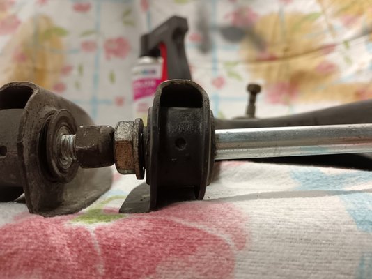

Change rubber bushes on both upper wishbones. Old came out and new slipped in really easy so i think that sleeves are little bit worned out. This one will do until new wishbones arrive
Left side finished
Right side finished

Well done, you are doing a very professional job. I am doing the same job as you, hope your drive shaft boot clips don't touch the lower arm when the car is jacked up like mine did.

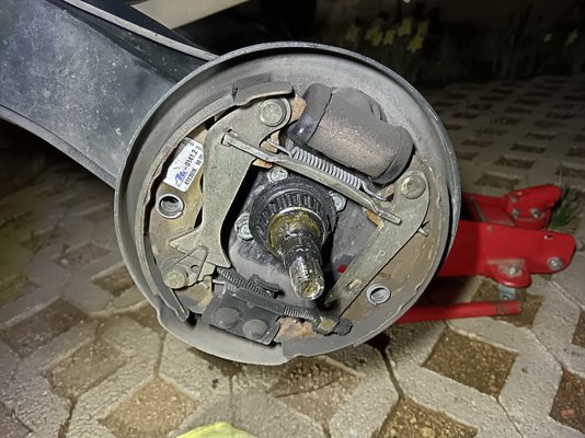

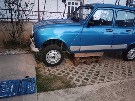

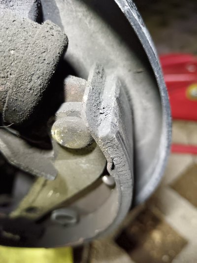

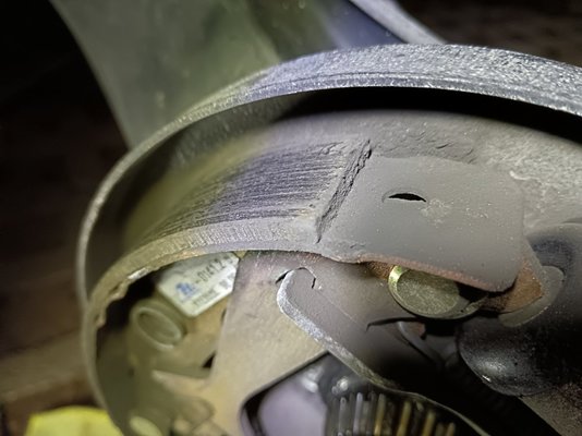

Today lowered front end and lift up rear end.

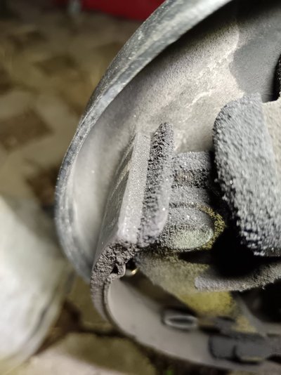

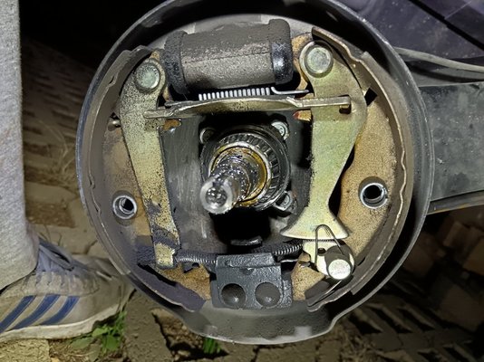

Loosen handbrake and took of drums
Dusty but in almost same condition as i put them on 9 years ago.

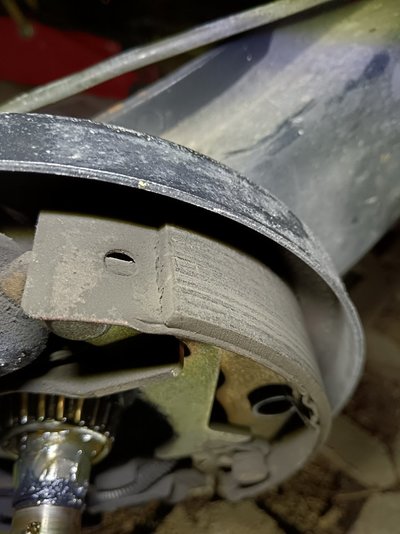

Pads are at 5mm thickness
But as i can see there is nothing to do here except clean them and put drums back in place
That is left for tomorrow as dark catch me.
