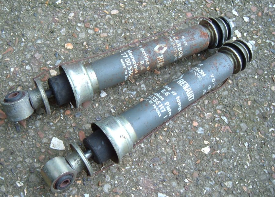

Old stock De Carbon Front dampers (rough road, gas pressurised, really cool)
