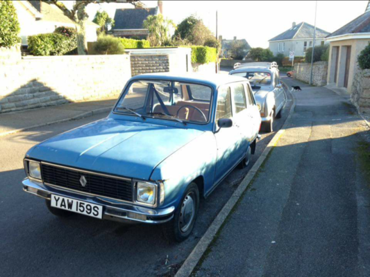

Looks remarkably like a Star Wars levitation car!
I'd love to see your car in reality - hoping to do the Kent meeting when that happens
